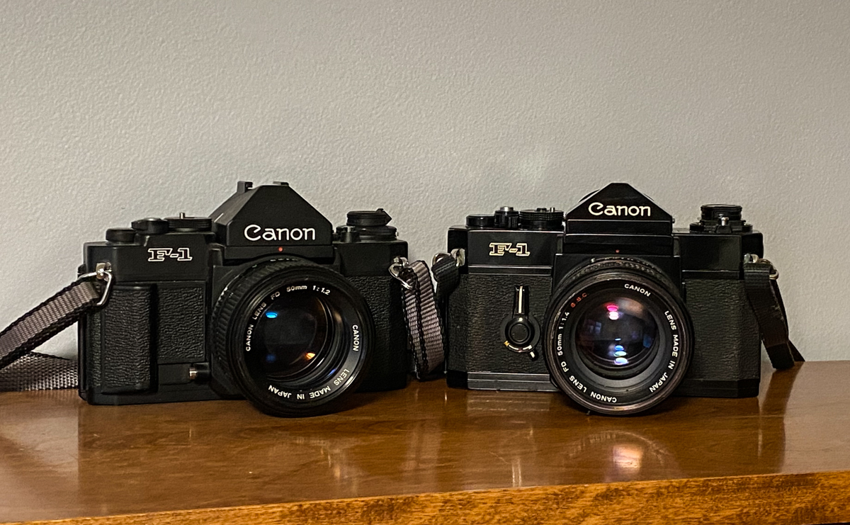

One thing worthy of consideration is batteries. I'd pick a camera that can use currently available batteries if you want to use a meter. The original Canon F-1 uses the 1.35V mercury cells. There used to be a guy in Russia who sold Russian made cells on Ebay, but obviously that's not an option anymore. I bought some and they work perfectly in an F-1.
I have an original F-1, but my preference would be for a New F-1. Still has the classic SLR feel, but uses a 6V battery and has a lot of options available to customize it to your needs.
Certainly look at Pentax as well, there are lots of K mount lenses out there which are excellent and a lower price point than Nikon or Canon.
If you consider a Nikon F, be aware that they are bottom loading and considerably slower and more fiddly to load film than later cameras that are back loading.
You do have to try them out, for me the New F-1 fits my hands the best.
