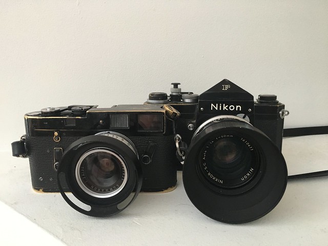

Why do people post pictures of their cameras? Particularly common cameras like Nikons and Leicas?
Well when you're discussing size & design.....with someone who's making a decision to buy....why not?
We are discussing the Nikon F2 vs. the Canon F1. Still no photo of the Canon F1. Yet in comes a photo of someone's Leica. Apparently, any time is a good time for a photo of a Leica.
