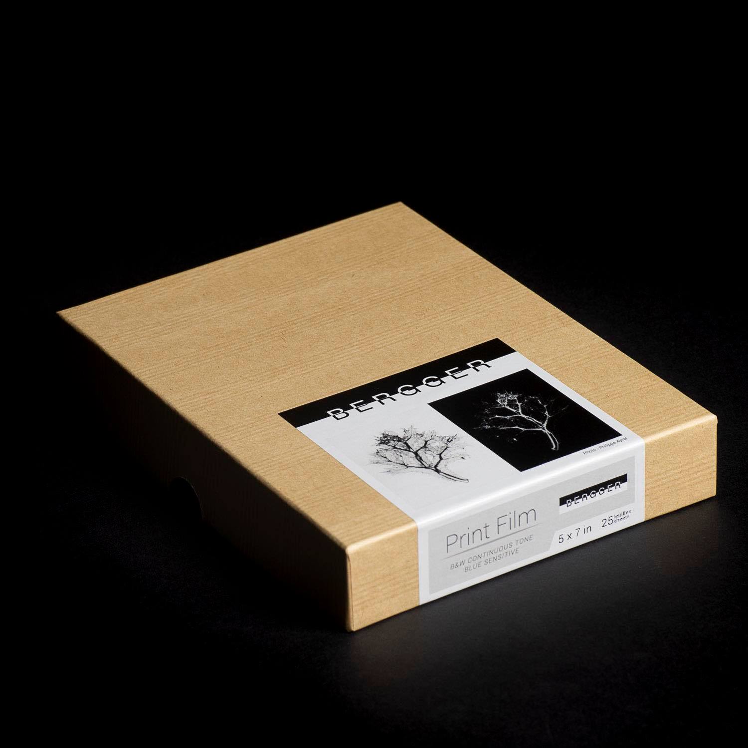

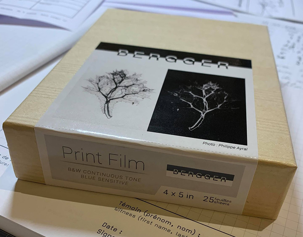

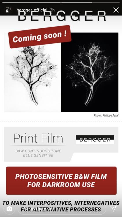

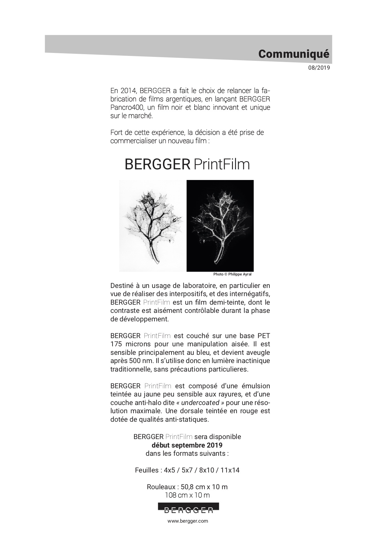

Sorry, part is in french only for now. BERGGER_PRINTFILM_COMMUNIQUE_08_2019.jpg F5D81267-1524-40D6-94D6-1E3F3828114F.jpg BERGGER_PRINTFILM_COMMUNIQUE_08_2019.jpg F5D81267-1524-40D6-94D6-1E3F3828114F.jpg
A print film is a film intended to show a positive.
The Bergger statement you show, states it however as inter-negative or inter-positive film. The usual term for such is a lab-film
I find this new Bergger film neither on their company site nor on their Facebook page.
They've since added a facebook post:
RELEASE
In 2014, it was decided by Bergger to relaunch the production of analogue films, based on silver halide technology. PANCRO400 was introduced on the market as a unique, and innovative black and white film.
Relying on this experience, it was decided to introduce a new film on the market :
BERGGER PRINT FILM
mainly dedicated to darkroom use, and especially the making of interpositives and internegatives. It is a continuous tone film, which contrast is easily under control during the processing step.
BERGGER PRINT FILM is coated on a 175 microns PET base, for an easy handling. It is mainly sensitive to blue radiations, and is almost blind past 500 nm. Consequently it is perfectly usable with a traditional darkroom safelight.
BERGGER Print FILM photosensitive emulsion is yellow tinted and is very resistant to scratches. A very efficient undercoated anti-halation layer provides a maximal resolution. The red tinted backside has anti-static properties.
BERGGER Print FILM will be available at the beginning of september in the following sizes :
sheets 4x5 – 5x7 – 8x10 -11x14
rolls 50,8cm x 10 m – 108 cm x 10 m
A lab film in the most literal meaning: to be used in the darkroom at safety lighting.
