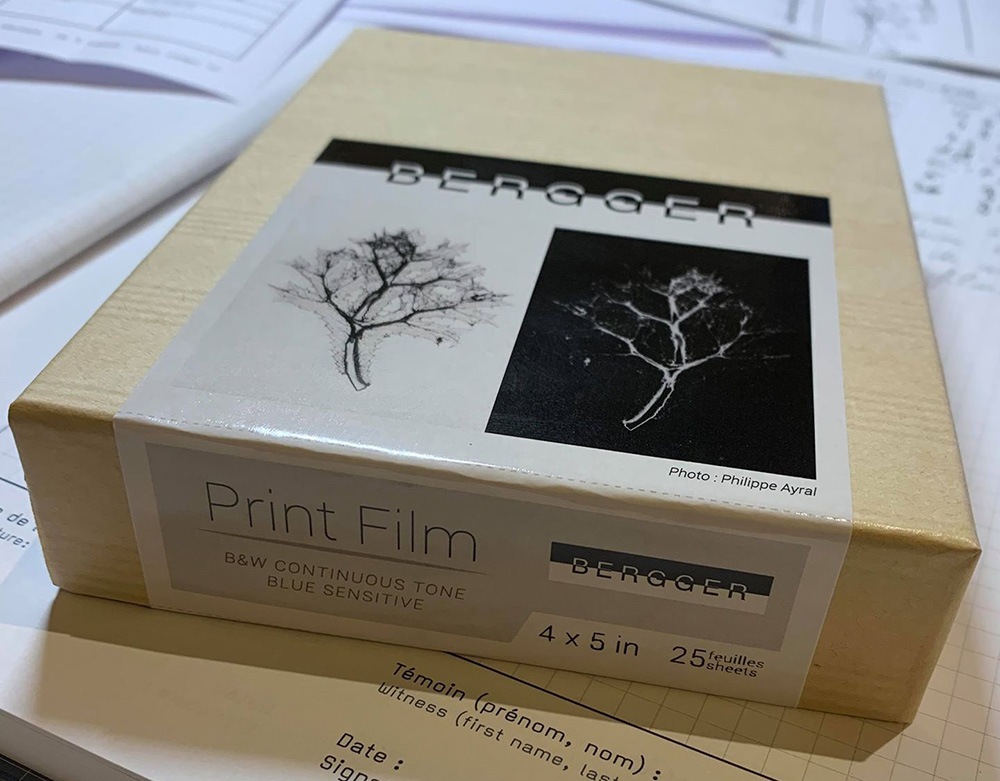

would like to understand if talking about the characteristics of this film we are in the field of hypotheses or not, also because at the moment Bergger did not give detailed information. Today I phoned a Bergger product distributor who told me he made the purchase order and that the company is cutting the film in various formats and should distribute it towards the end of September. Important note: he confirmed that it is an orthochromatic continuous-tone film.
The Bergger press release that trickled this thread says "blue sensitive".
Thus seemingly your distributor mixed things up.
It seems the confusion is complete then; since the earlier Bergger Facebook post says it will be blue-sensitive and the product distributor says it is orthochromatic.
Punto Foto Group
· 7 August ·
In 2014, BERGGER decided to relaunch the production of black / white films based on silver halide technology. The PANCRO400 was presented on the market as a unique and innovative black and white film. Based on this experience, it was decided to present a new media on film: BERGGER PrintFilm
It is mainly dedicated to use in the darkroom, and in particular to the creation of interpositives and internegatives. It is a continuous tone film, whose contrast is easily controlled during the processing phase. The BERGGER PrintFilm is spread on a 175 micron PET base, for an easy and safe use. It is mainly sensitive to blue and is almost insensitive beyond 500 nm. Consequently it is perfectly usable with a traditional security light for darkroom. The BERGGER PrintFilm photosensitive emulsion is yellow and is very resistant to scratches. A very effective background anti-halo layer provides a maximum resolution. The red-colored back has antistatic properties. These layers naturally dissolve during the treatment and the film will be perfectly transparent.
It can also be used as a normal low-sensitivity orthochromatic film also for the pinhole camera.
BERGGER PrintFilm will be available starting from September in the following formats: 4x5 / 5x7 / 8x10 / 11x14 Rolls: 50.8 cm x 10 m 108 cm x 10 This is what is written on the website of one of the Bergger distributors in Italy.
I am having my test rolls delivered as well at end of month to arrive in October
I am not a great expert on photographic emulsions, so I ask the question: a film can be blue sensitive and not exclude that it is insensitive to red, therefore orthochromatic. Or did I miss something?
