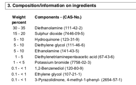

Maybe I’m wrong, but I believe that the data indicated in the MSDS just show the approximate ratio of DEA and sulfur dioxide (that is, the content of sulfur dioxide in the complex).

I believe that is the old version of HC-110.
Here is the link to the new US MSDS:
http://sds.kodakalaris.com/temp/SDS US English - KODAK HC-110 Developer.pdf?t=637217224470487176
Thanks. I'll update my archive. But I don't see a fundamental difference. Base is the same - three developing agents, the organic forms of sulfite and bromide, plus additives.
But the old, original form that Alan Johnson mentioned was different. There is no catechol in it.
IDK at what temperature iminodiethanol (DEA) is reacted with SO2, re safety.
In those sources that I managed to find, there are no recommendations on the temperature regime. As I understand it, the adsorption of SO2 and hydrogen sulfide occurs in amines at a natural ambient temperature. This technology is quite widely used in the processing of hydrocarbons, etc. When quarantine ends, I will try to consult with chemical engineers on this issue.

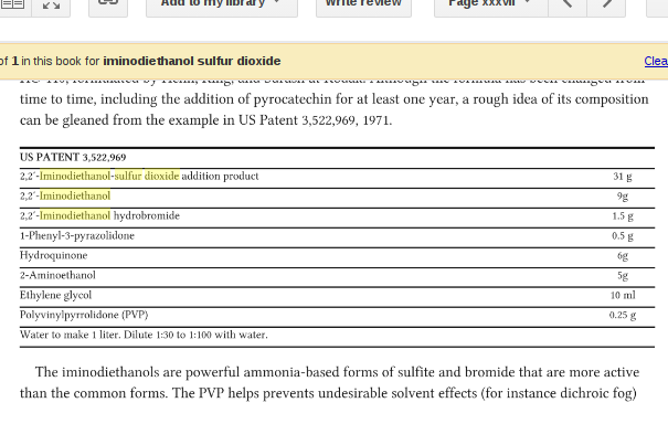

Is the developer discussed in this patent HC-110?
https://patentimages.storage.googleapis.com/45/c6/25/25d6b6bd1d9126/US3552969.pdf
A liquid developer concentrate is prepared by mixing about 20 C the following components:
2,2'-iminodiethanol-sulfur dioxide addition product -------------------------------------- 31.0
2,2'-iminodiethanol --------------------------- 9.0
2,2'-iminodiethanol hydrobromide -------------- 1.5
1-phenyl-3-pyrazolidone ----------------------- 0.5
Hydroquinone ------------------------------- 6.0
2-aminoethanol ------------------------------ 5.0
Ethylene glycol ------------------------------ 10.0
0.25 gram of polyvinylpyrrolidone (PVP Grade K-15, a commercial product of General Aniline and Film Corporation, New York, N.Y.) having a molecular weight of about 10,000 is dissolved in each liter of the resulting mixture. One part by volume of the mixture is diluted with 31 parts by volume of water at about 20° C.

The patent is from early 70's.
I wouldn't think a quarter gram per liter of anything could do so, however.
Polyvinylpyrrolidone was used primarily for dealing with dichroic fog according to the patent. Viscosity of HC-110 is probably due to dieathanolamine & addition products used in the formula.
