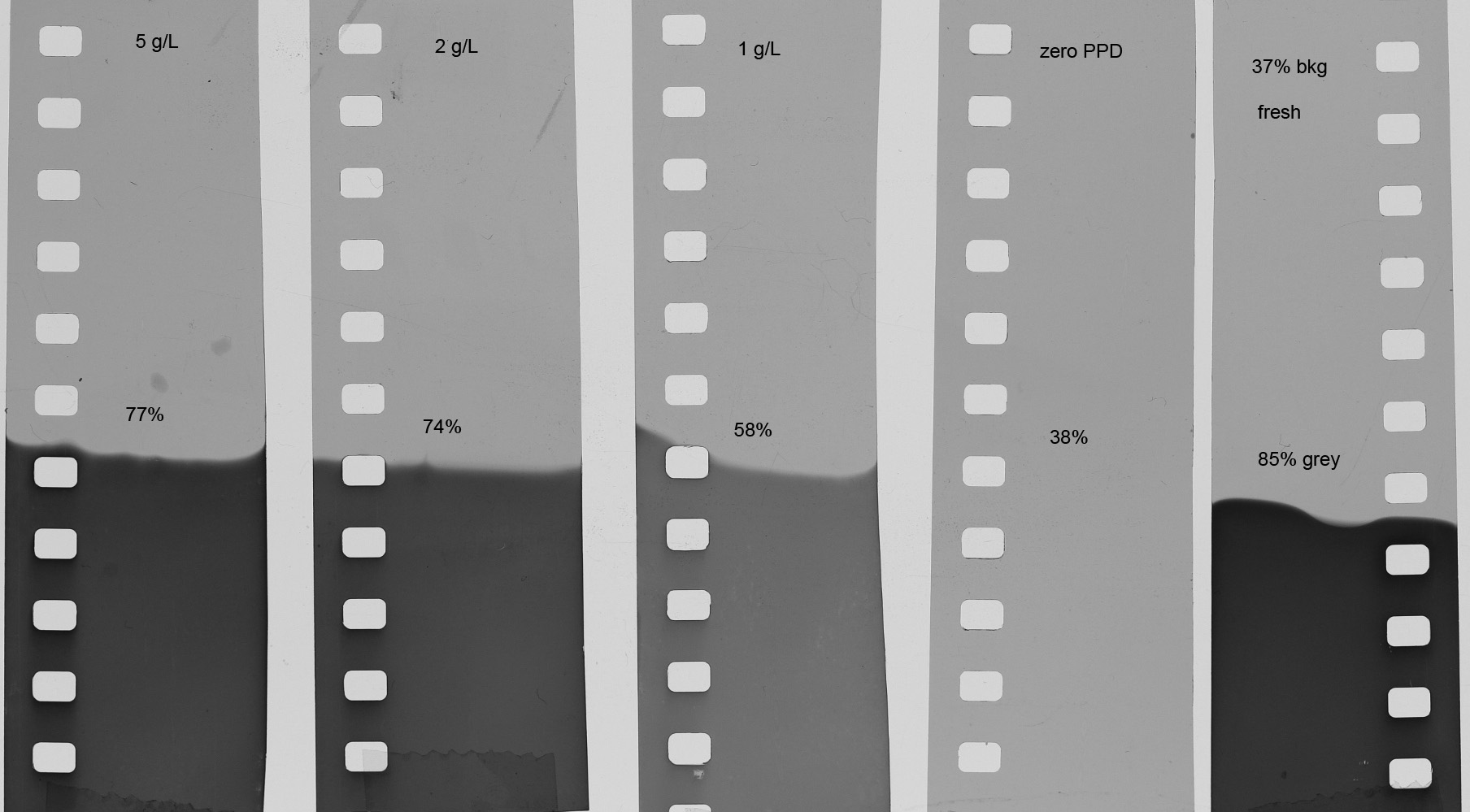

I am not sure, Alan, what kind of evidence you need, but I will be willing to set up an experiment and show the deterioration of this developer over time. However, you certainly know that an alkaline solution of catechol deteriorates over a few hours (Windisch catechol- caustic, for example). Unfortunately, it will take many months for a conclusive demonstration with MCM100, which is in essence the same developer as Windisch but working at a lower pH due to PPD and a very odd buffer, which may be superfluous. For now I can show a result of a related experiment of adding p-phenylenediamine into diluted Rodinal (attachment). These fogged film strips were developed for two minutes in the respective solution, from right to left: Rodinal diluted 1:50, fresh; Rodinal after 1 month storage in a partially filled bottle, with various amounts of PPD shown. The density is expressed as level of grey in Photoshop. IMO, it demonstrates that Rodinal 1:50, even if it is not used, deteriorates completely in a month at room temperature in a partially filled bottle, while with as little as 2 g/L of PPD it pretty much holds its activity over the same time. MCM100 is in essence a catechol developer, like Windisch compensating or Meritol-caustic, but in the presence of PPD. BTW, PPD is from PF, and Rodinal is Tetenal's Paranol, however, scratch mixed p-aminophenol developer displays the same phenomenon.
solutions of MCM100, containing catechol/PPD, while they progressively turn shades of yellow and orange, do not appreciably lose their activity in the presence of air (and water). .

I have mixed MCM-100 a while back, but used CD-4 instead of plain PPD. After a few weeks/months the developer rose up in pH, which may explain its constant or even rising activity over time. I would still not consider it a long term stable developer.

It is not really off topic if you consider that as an illustration that there are other chemicals beside sulfite or its organic ion complexes that extend the life of a developer. Nor is the absence of water. It si just one of the possible solutions. I have a few such combinations "aging" in the basement, for example metol-PPD-catechol and PAP-PPD-HQ are doing well in incompletely filled bottles, when used sporadically to develop a clip. My point being that the new formulation of HC-110 may not lose its legendary stability if does not appear yellow, or viscous or otherwise organoleptically different.
