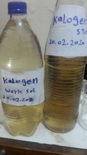

Hey guys.
What is the problem now?
This is the amazing developer ,, found in companionship.
The first bottle is the primary developer, and the second bottle is the working solution (24 ml +980 deionized water),
- The attached image, is a picture of my mother, was tested quickly (24 ml + 276 water). Developed in 3 minutes at 21 ° C. (Regardless of whether the camera is sick or the lighting is poor, it is only a test).
Formula is:
700 ml deionized water 52 ° C
(CD2) .........................13.5g
(HQ)...........................53.0g
(sod.sufite) ................180.g
(Tri sod. phospate)......35.g
(pot.bromide) ..............9.g
(KOH)............................4.g
Inti fog.........................0.2g
Water up to one liter.
The solution was filled in a glass bottle for a week tightly closed.
After a week, the solution was heated to 60 ° C, stirred well, and filtered with a coffee filter.
The dilution mentioned in the original recipe is 1:11, develop 3 minutes 21 ° C.
Experiments have proven that the dilution should be greater than 1: 50 - and experiments are still underway to determine the dilution ratio, temperature and time.
Important note: everything is mixed in order completely except for (CD2)

Curious to know from where you got your Kalogen formula. I've brewed Kalogen a few times using Jerry Koch's formula detailed here:
https://www.flickr.com/photos/peterbcarter/33875791150/in/album-72157644217980207/
Your formula is very different.

- I am currently making headaches at home, I cannot go out, I do not have any black and white rolls, when I can buy black and white rolls, I will do accurate tests on the modified Kalogen developer I have prepared.
- Perhaps, perhaps, we can get from this developer amazing results. Why not, so if we look closely at the functionality and properties of CD2, I think it is a very great development component and has not received the attention and appreciation it deserves. He may be able to produce negatives of no less than HC110 quality, why not? Let's wait and see
- The CD2 component is the main component used in the process (ECP2D) and it is the process that produces the final movie movie that we pay money to watch in the cinema (on the silver screen).

I do know someone who has replicated the original HC-110 formula for personal use; but he has access to a full research facility. It is probably impossible to reproduce in a basic home darkroom. Among the great features of HC-110 were its tremendous keeping quality in concentrate, and it's ability to work over a very wide range of dilutions. I haven't tried the new formula yet.
Donald Qualls
Jan 19, 2005
12,544
North Carolina
Hmm. I see diethylene glycol, that should make it syrupy, phenidone, hydroqinone, borax, potassium hydroxide (so probably the metaborate as an end product) -- clearly not the same as the old HC-110. The diethanolamine is still present.
We'll see how it keeps as concentrate, but it's clearly not the same as the old version. And this is exactly what Ansel Adams wrote about becoming dependent on commercial developer vs. mixing your own from base chemicals -- the latter means you 're in control, can always have consistent process. The vendor can change the formula of commercial products (and did, with HC-110, on several occasions with far less fanfare than this time) and change the photographer's darkroom results.

If we abstact of the nuances of formulation, it seems to me that there is nothing supernatural in the HC-110. In my humble opinion, this is a completely ordinary phenidone-hydroquinone developer, concentrated on an anhydrous basis. Its fundamental difference from many other concentrates based on organic base and solvents - is the use of the sulfur complex (IV) of diethanolamine (DEA-SO2) ... Which acts as a source of sulfite ions (apparently not only this function, possibly more - silver solvent and part of pH regulator).
Naturally, this is the main problem in the preparation of such a concentrate at home, since it is not easy to obtain DEA-SO2. But it is quite possible. Bubbling DEA with sulfur dioxide, obtained from sulfite treated with concentrated acid (H2SO4), could probably give an acceptable result.
Naturally, it will be necessary to find out the equivalent ratios of replacing ordinary sodium sulfite with such a DEA complex, but this is apparently a matter of experimentation. As well as the regulation pH of solutions.
Unfortunately, in my country it is quite difficult to obtain DEA for personal experiments (and TEA is not suitable, since it has a much lower ability to form a complex with sulfur dioxide - almost three times) and I can't check these my assumptions.
