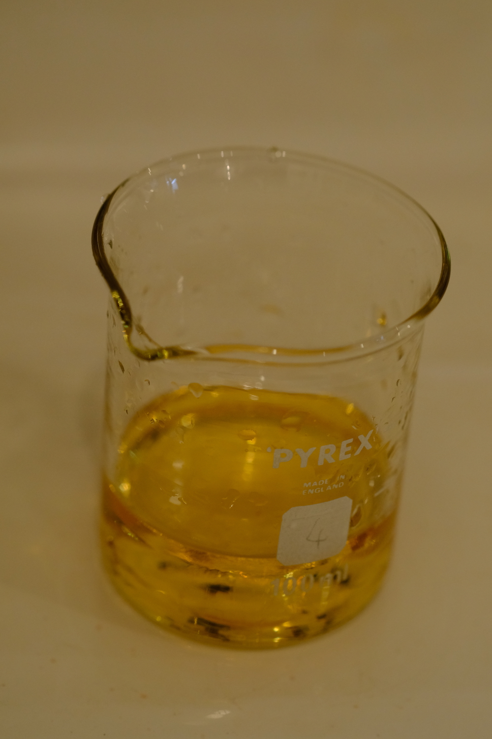

So I did a test today and the 15 year old Ilfotec HC worked perfectly at 1+49 dilution in a Jobo processing a single roll of Plus-X at 50 E.I. I've attached an image showing the colour of the concentrate. I should point out that I did have to spend a while cleaning the top of the developer container as a significant amount of "gunk" had accumulated.
Thank you for doing the test and reporting the results....seems like good news. :smile:
That Ilfotec developer is nowhere near as dark as HC-110 would be if it were 15 years old. I've seen this developer get very dark and bright red. I plan on switching to Ilfotec HC when I need to restock some developer. No more HC-110 for me.

The roll was developed using only 5ml of concentrate and there was no sign of insufficient activity.
