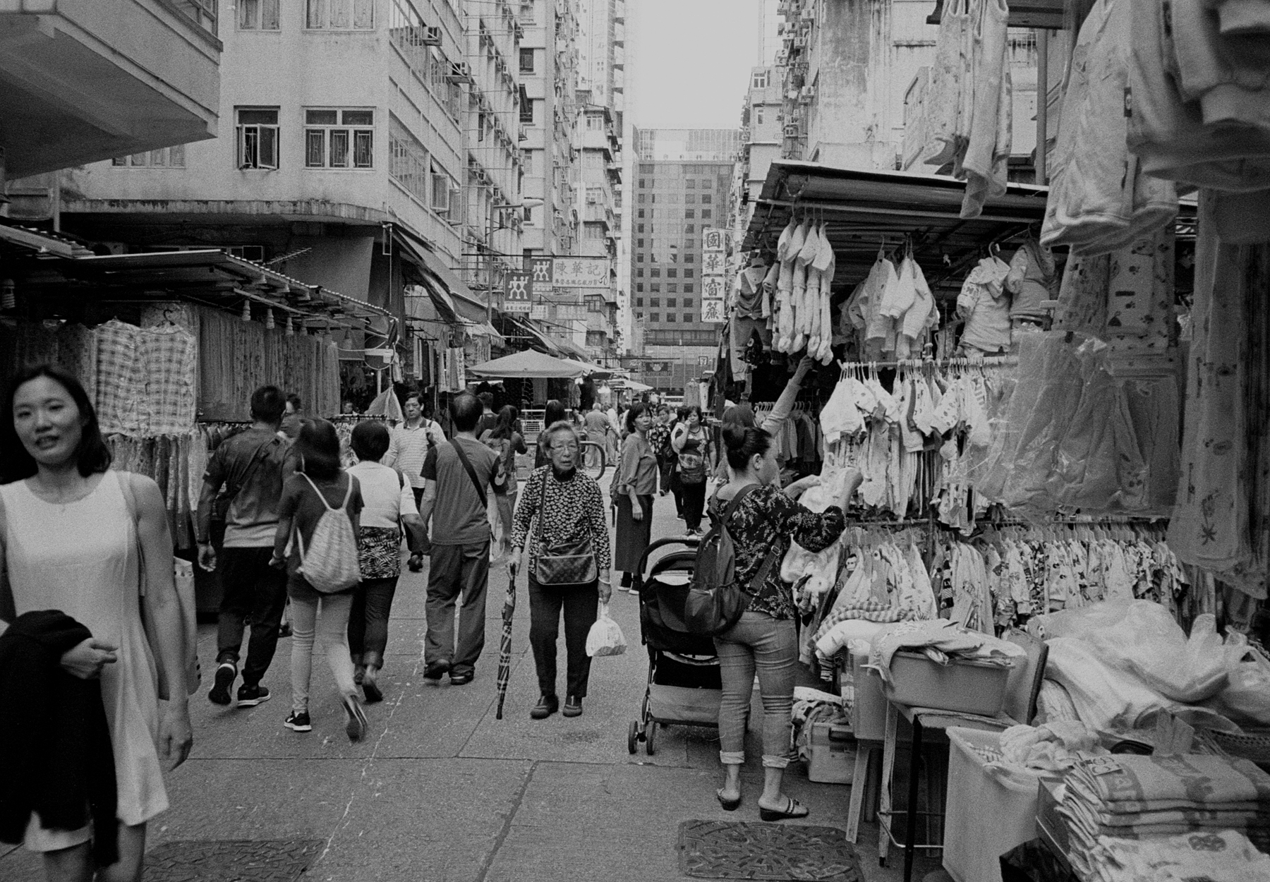

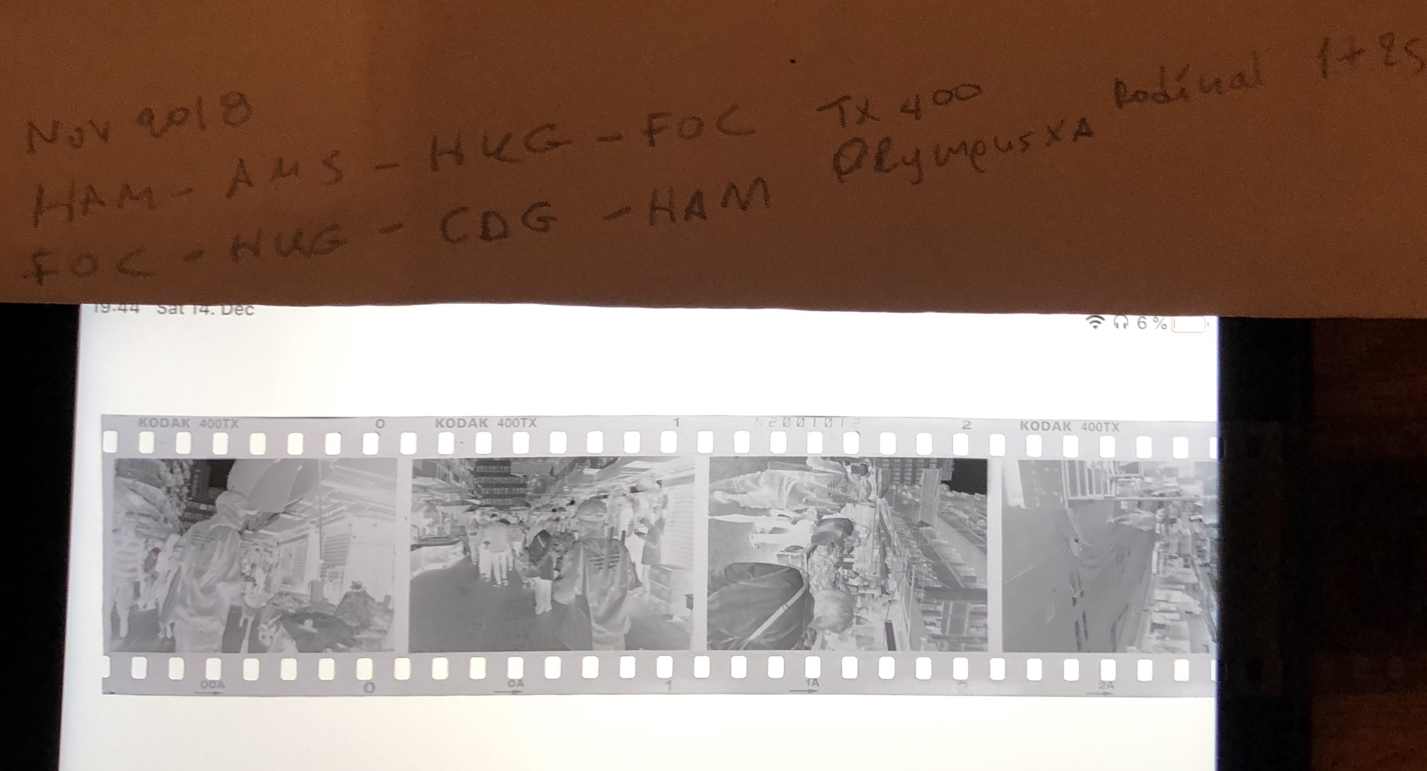

Hi,

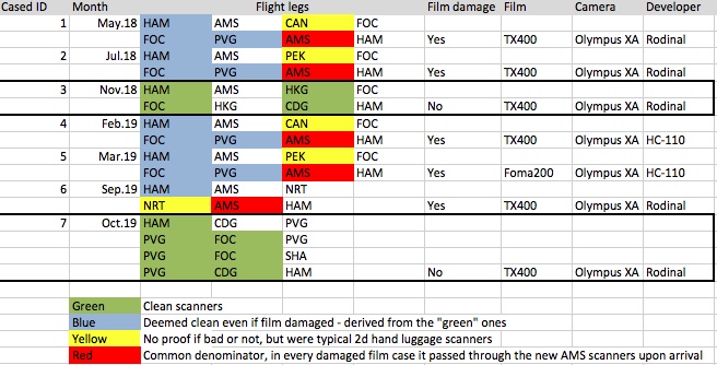

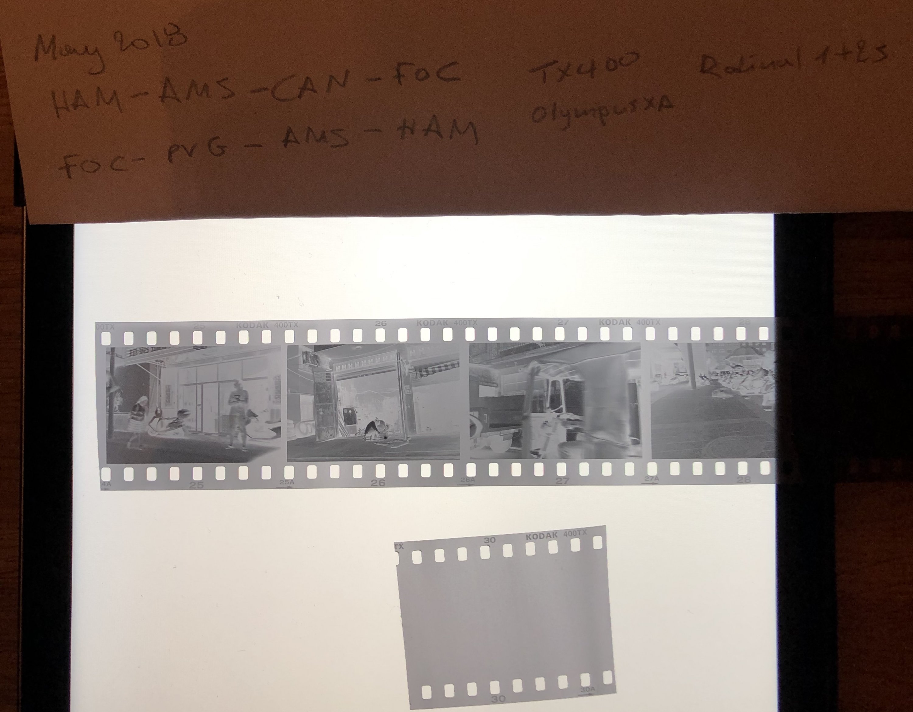

here the observations over the last 1.5 years passing by Amsterdam airport and travelling for the usually routes to China (and Japan in one case).
Same camera, same scanner (reflecta proscan), same development habits since 15 years.

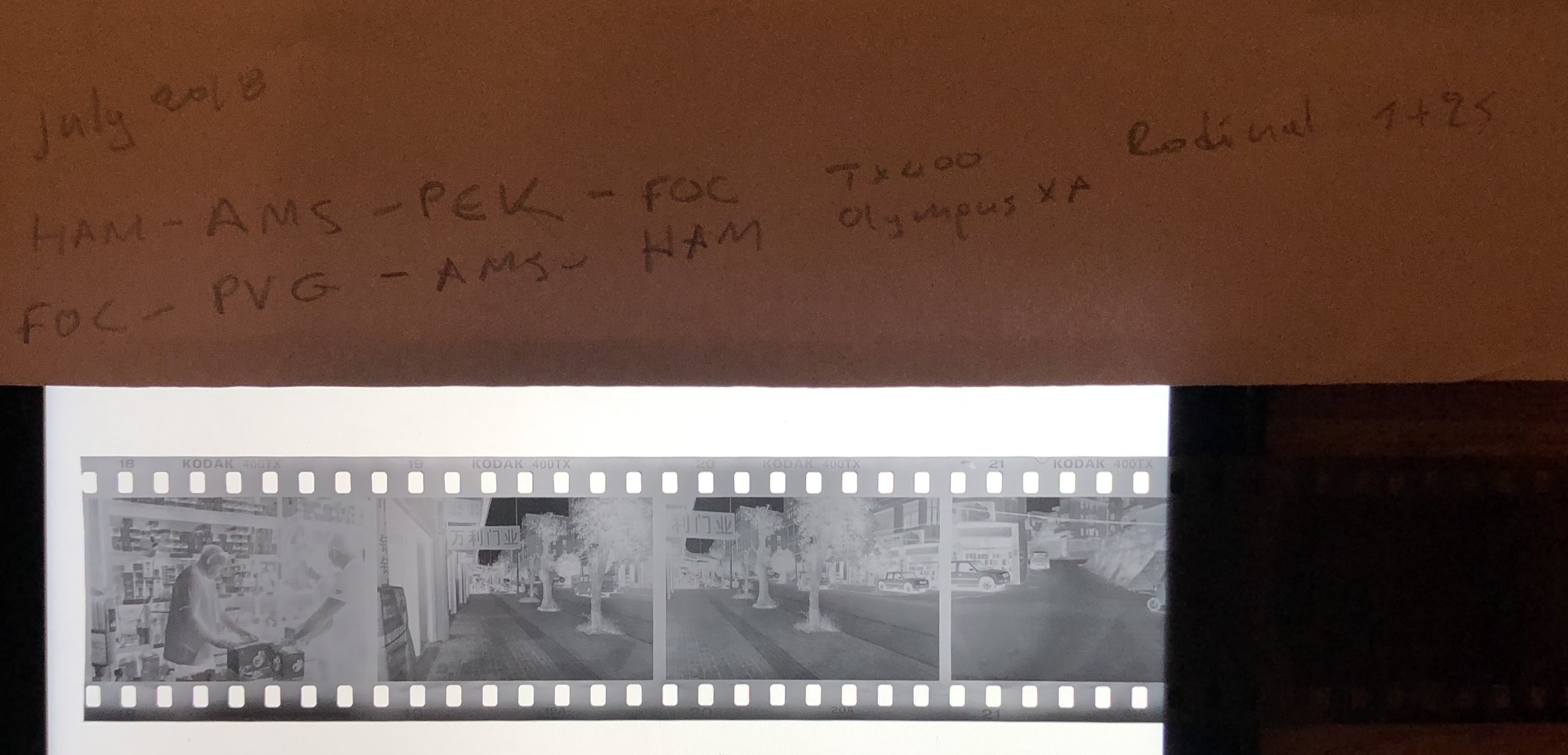

Case 1
Film severely damaged, film base is darker than my usual pinkish tx400. visible damage from scanner. Passed through AMS 3d scanner upon return.

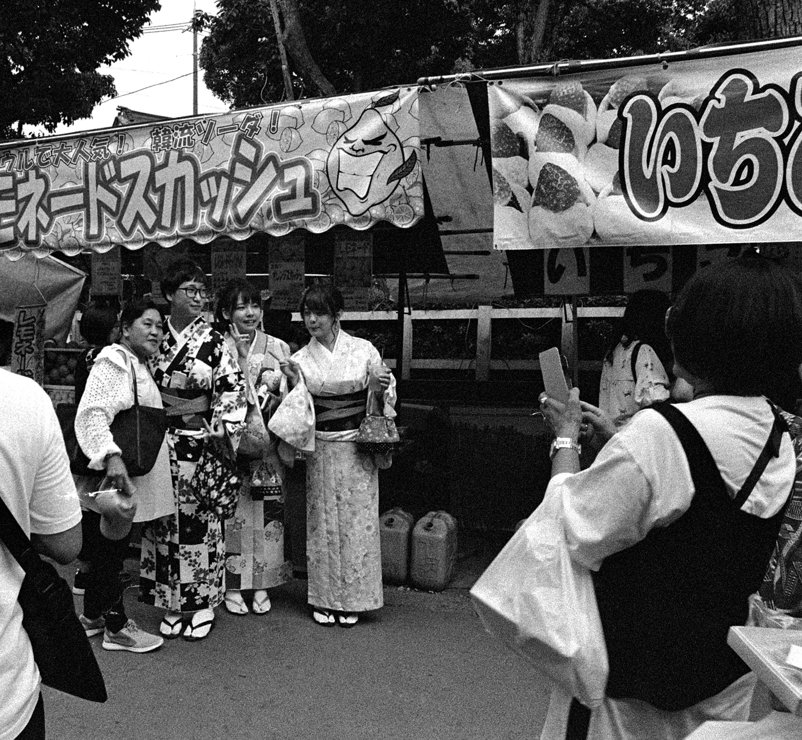

here a scan from the strip:

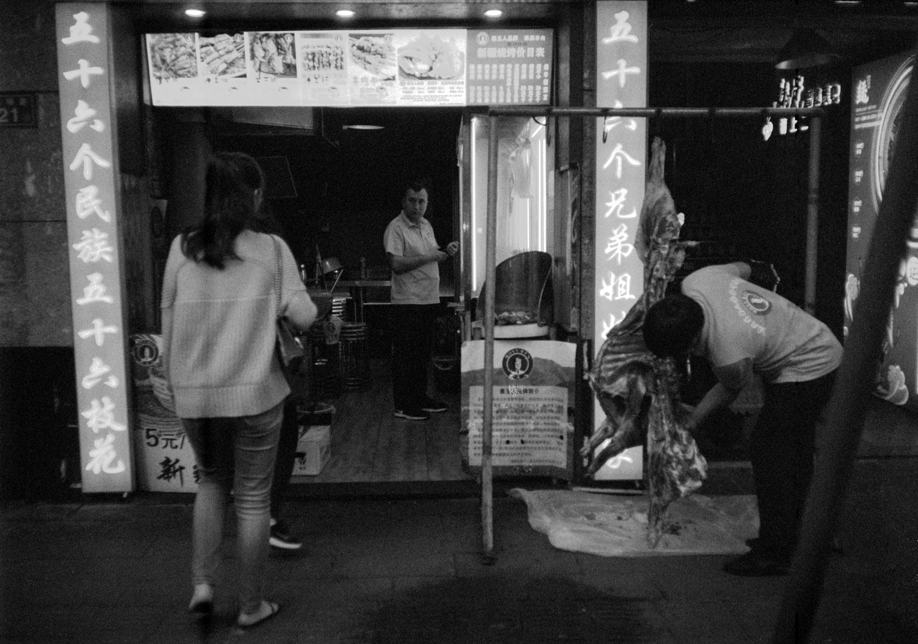

Case 2
Same as case 1 few months later, visible damage, dark base, bad grain, detail in shadow is lost
and a scan

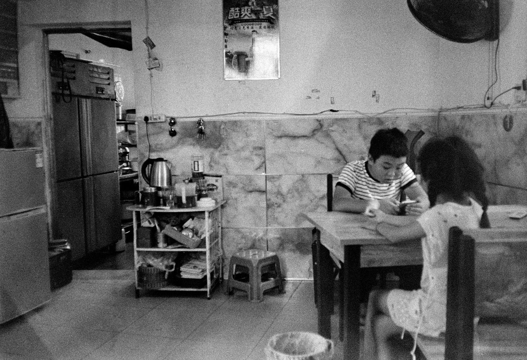

Case 3

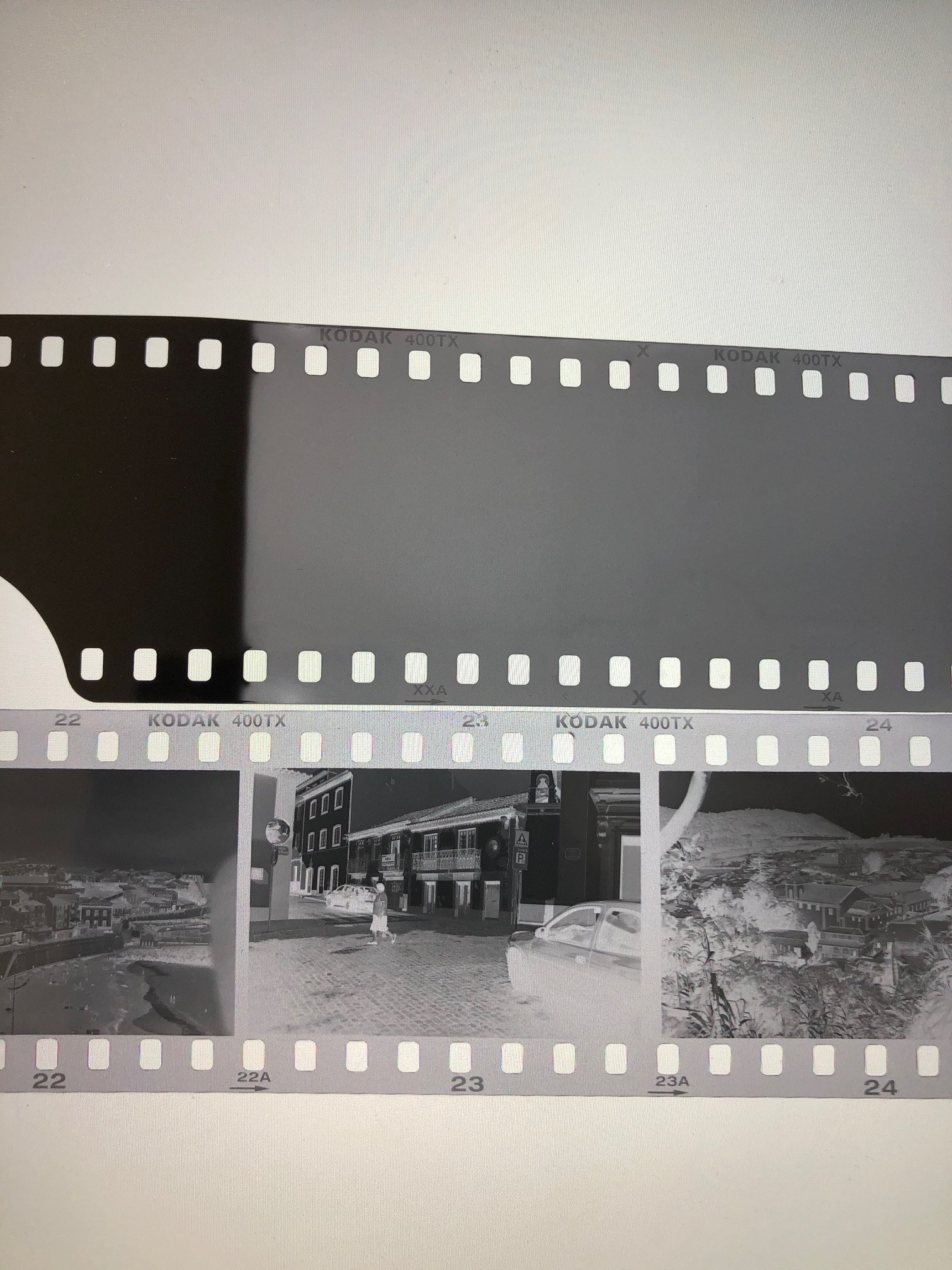

No scan in AMS, came back through CDG. TX400 as I know it. Almost clear base,

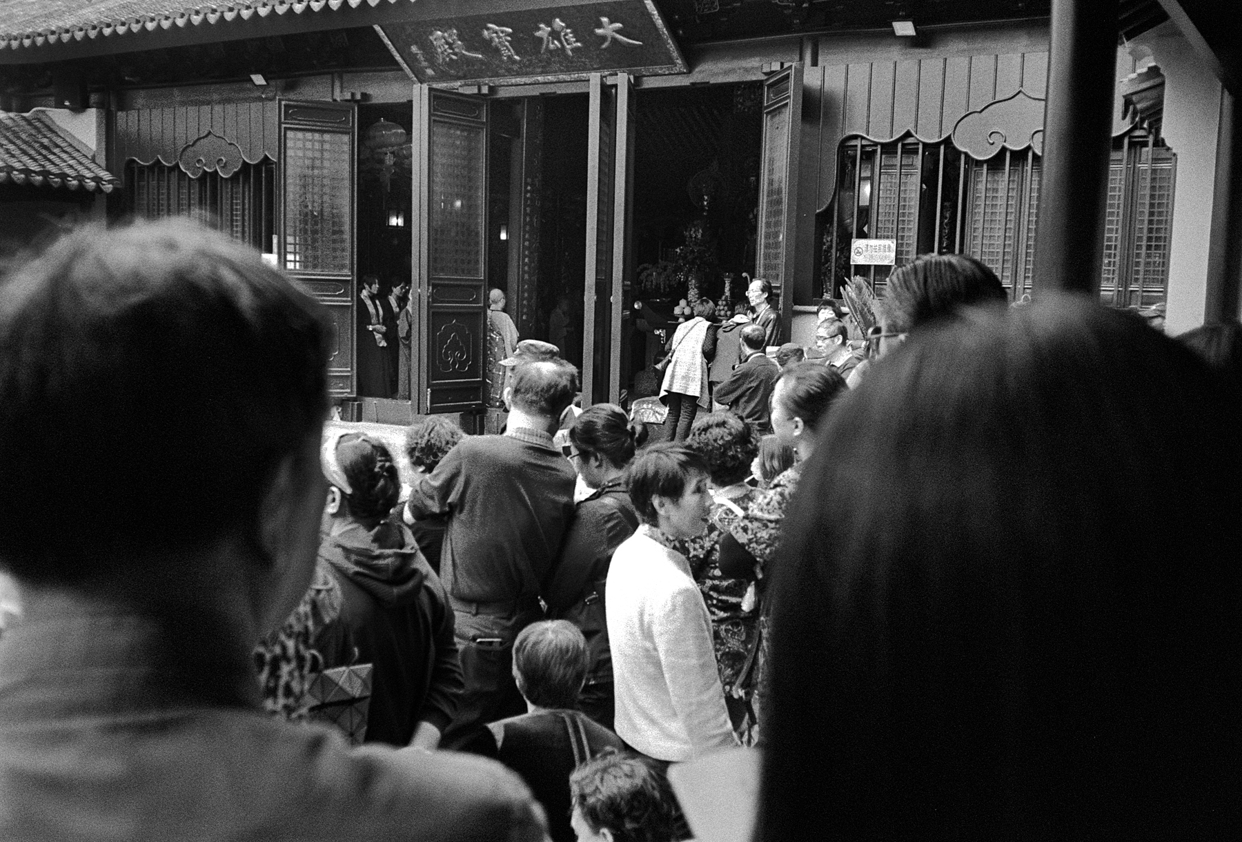

Here a scan, good contrast, no harsh grain, good shadow detail.

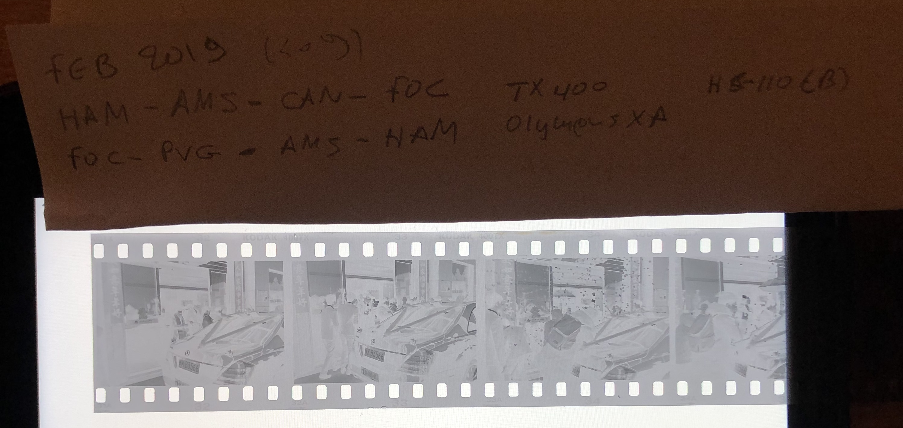

Case 4
Passed the scanner in AMS, darker base, lack of detail in shadows.
and scan
Case 5

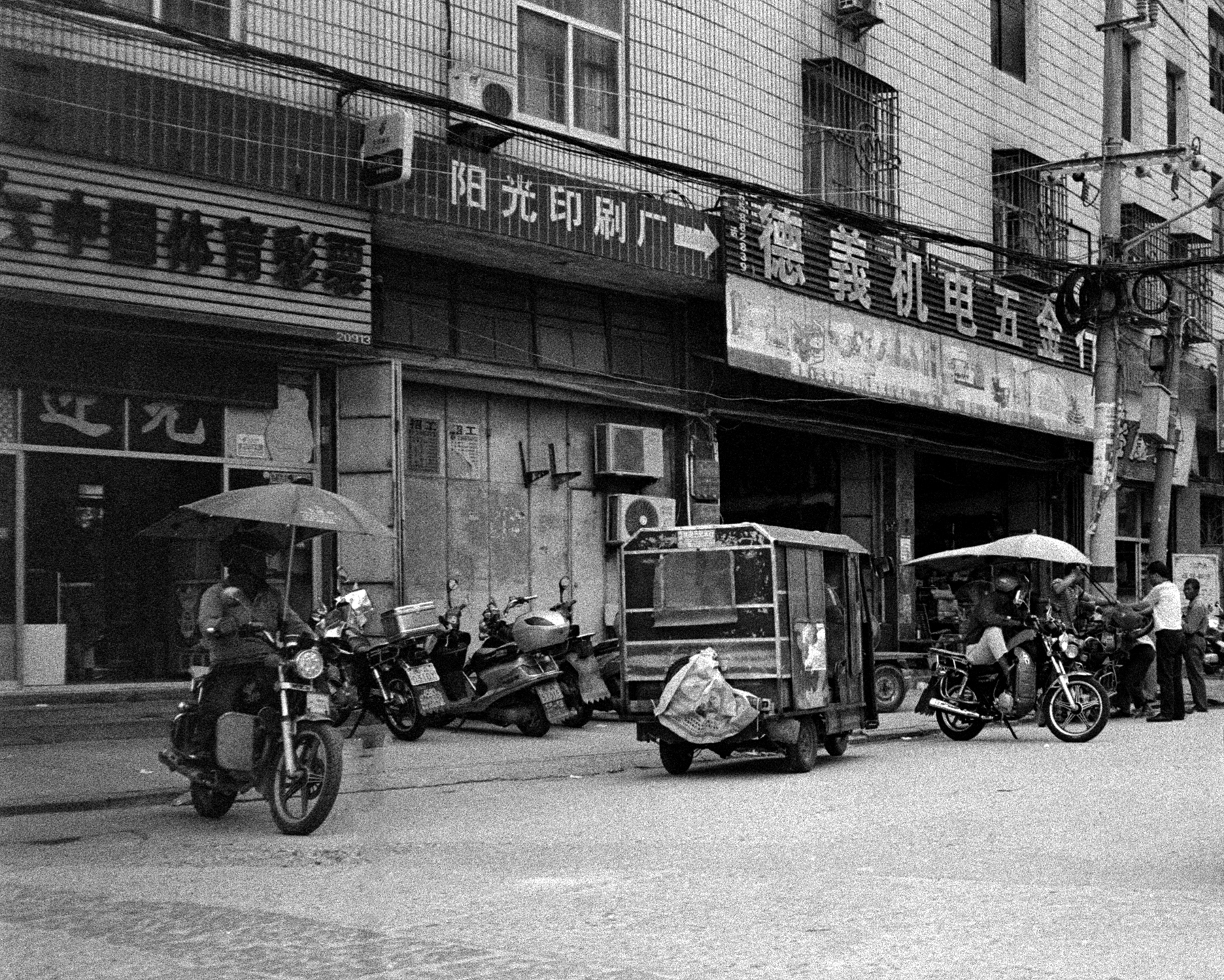

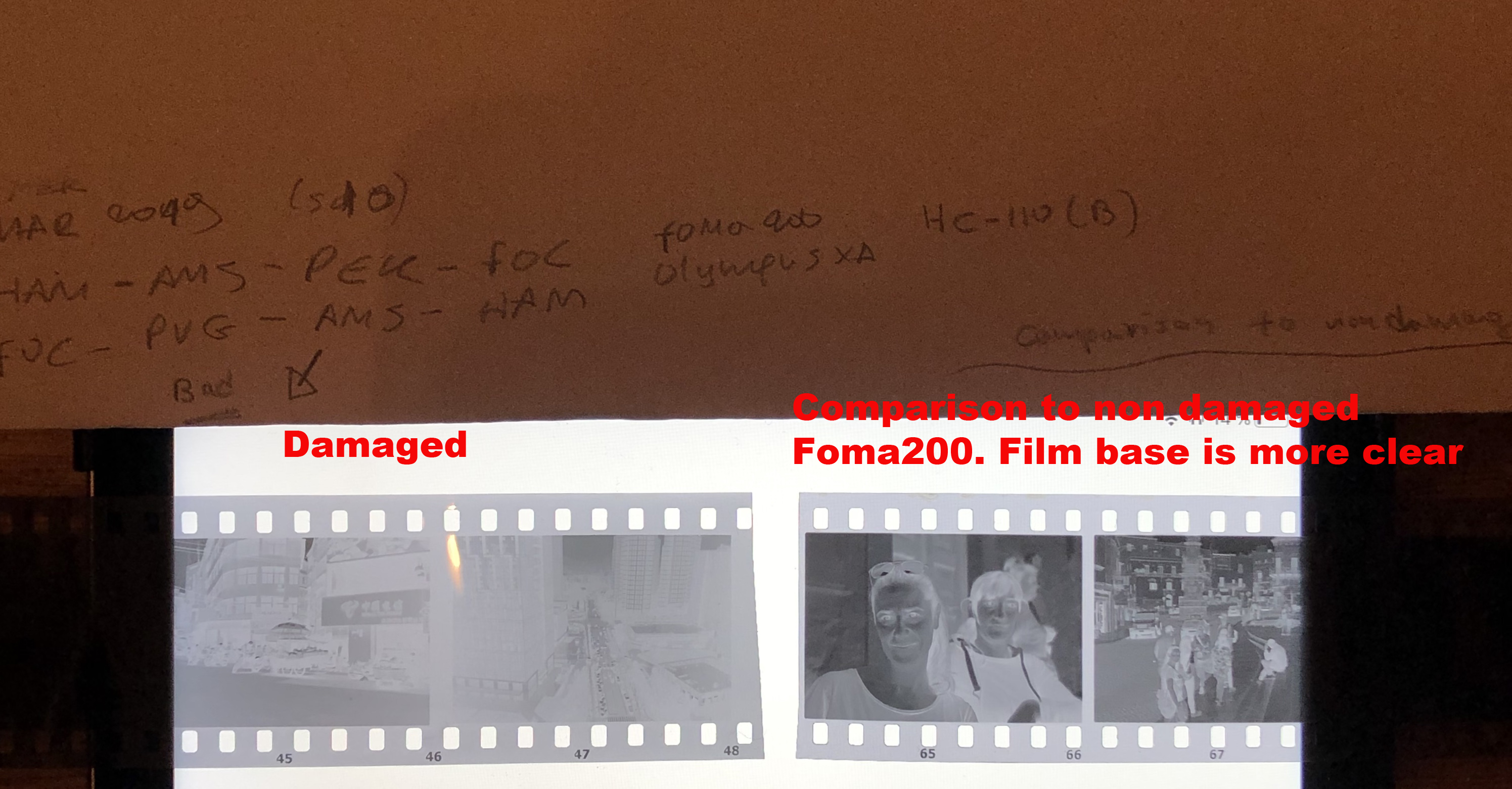

Foma 200, you can see after passing AMS scanner the film base is slightly darker than what I get usually from Foma200
Looking at the scan, grain and lack of detail in the shadow is obvious.
Case 6

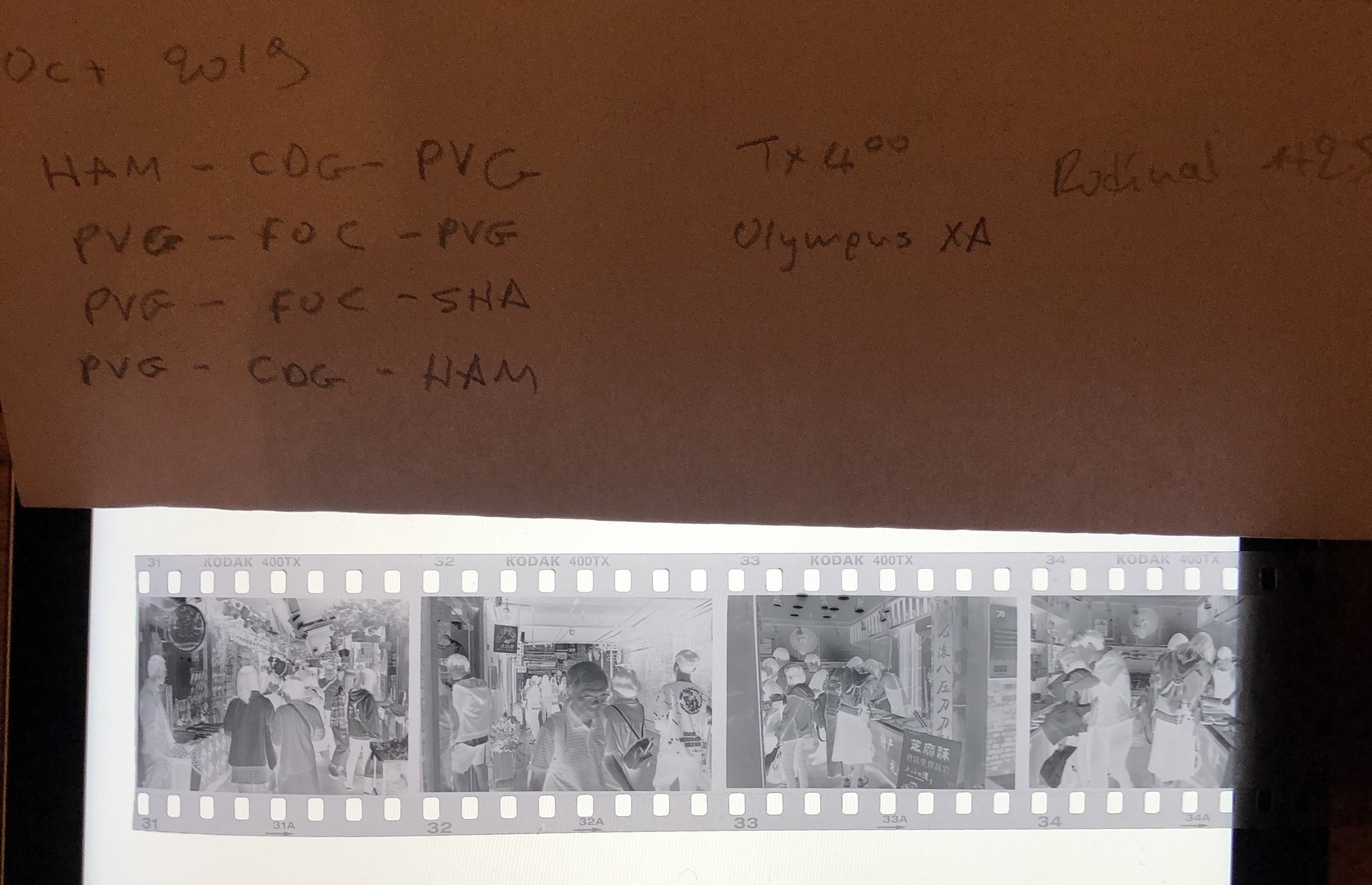

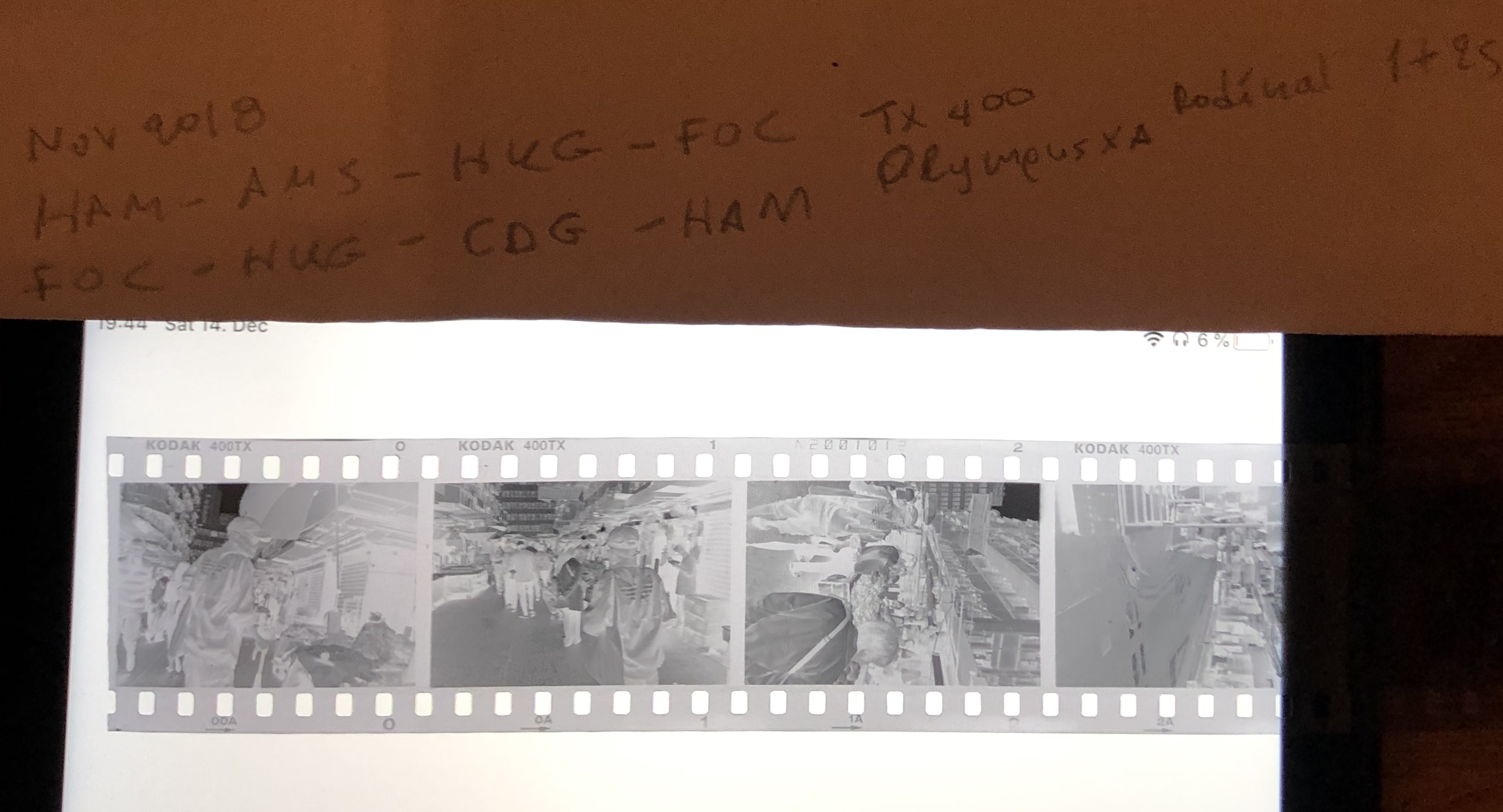

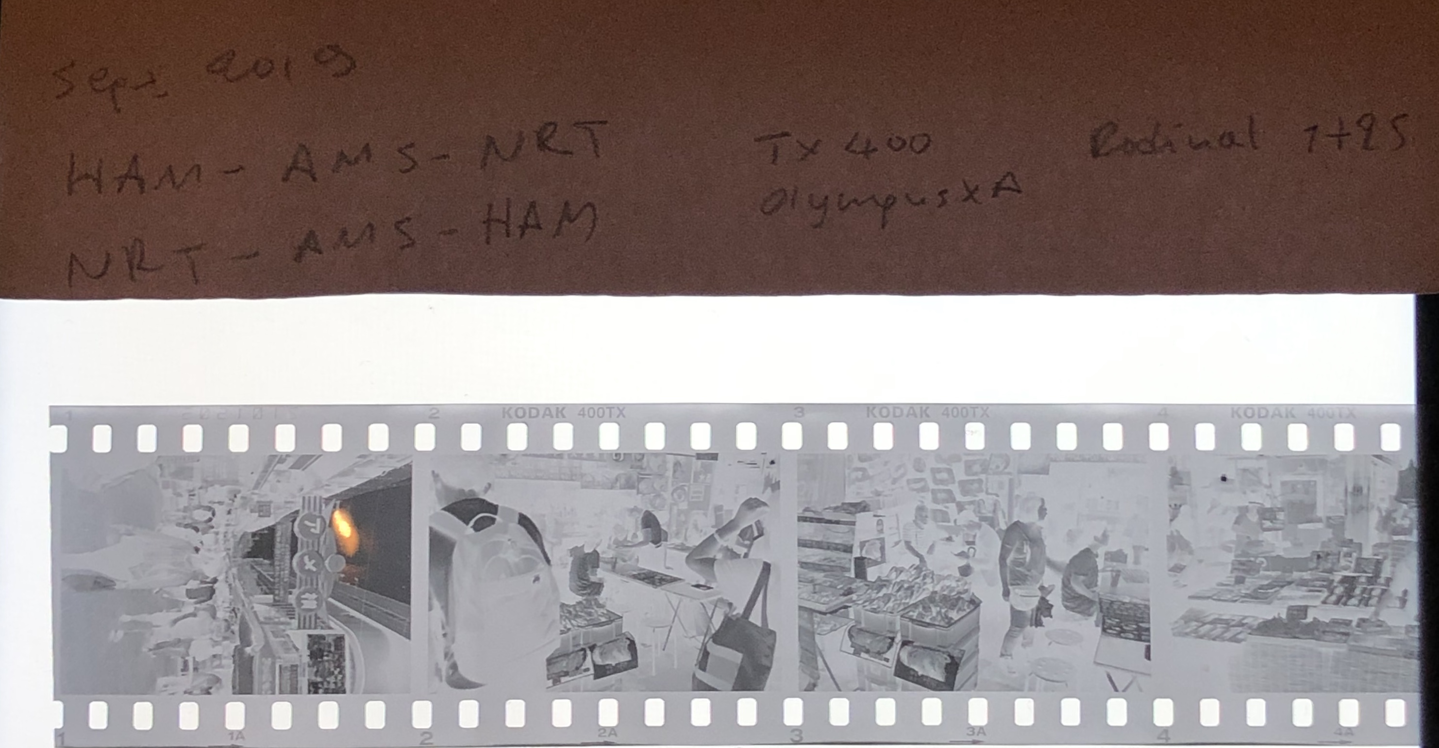

This is the case thad was the breakthrough in my observations. I was always suspecting the scanners in China but I was wrong. Flying to Japan and coming back through AMS (after shooting 25 films...) I realised that all the 400 ones are damaged (half of them)
The film base is darker than a normal tx400
Here a scan, detail in the shadow low and grainy.

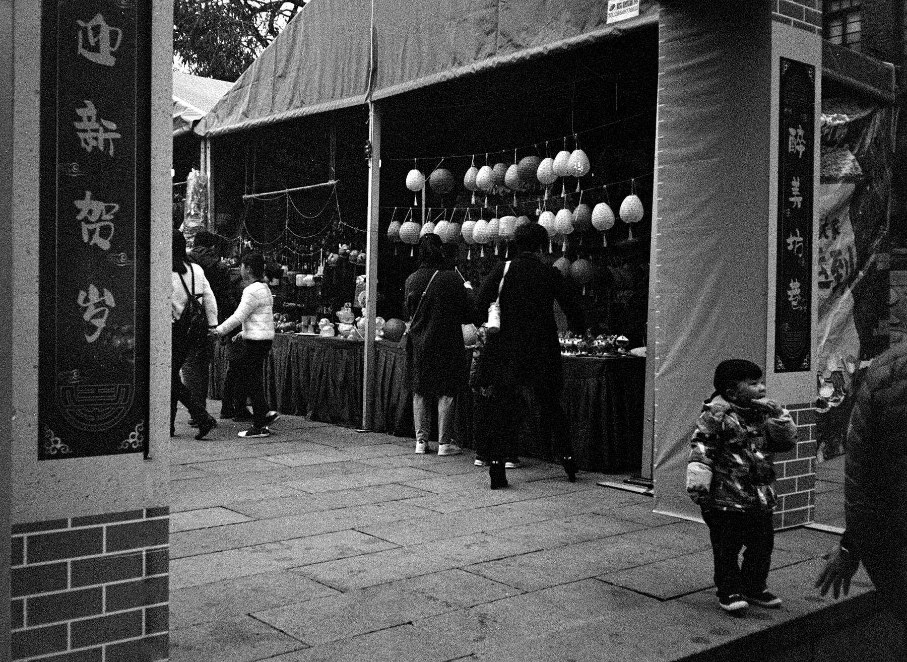

Case 7
A case supporting my observations, I chose to go through CDG to China instead of amsterdam's. The films passed multiple times as you see through hand luggage scanners in China. All turned out in to be in very good condition. No dark film base, no flat images, no exaggerated grain in the shadows
and a scan
I passed through the AMS with 100 ASA film as well. didn't see any visible damage.
I had also a number of flights throughout Europe (not passing through AMS) without any film damage up to 400 ASA.
Do you have any similar observations?

X-rays don't cause uniform base fog.
Of course diffuse X-ray radiation will cause diffuse fogging.
However people are used to see banding artefacts as typical effect X-ray scanners.
That's what I was thinking too - maybe there's something about the new scanners that affects film differently than the old scanners (and lines and patterns) that we are used to.

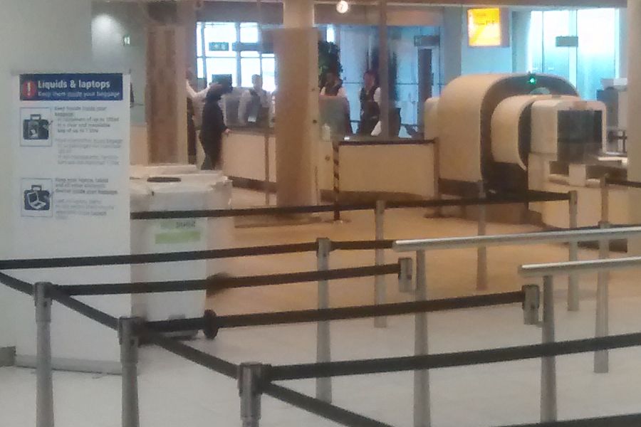

I traveled through Schiphol airport (Amsterdam) in November and saw that the new generation scanners had arrived there as well. See attached (cropped) cellphone snaps. When flying out, I asked the security guy for a hand inspection of my films. He acknowledged that these new scanners are more powerful than the previous generation. The security guy was friendly and he did a swap test instead of the scanner. When I was back in Ottawa, the films had passed through 6 carry-on luggage scanners during the trip. All of the previous generation CT scanner. After development, the Delta 100 films came out "clean", no fog. In Frankfurt a/d Main and Toronto, the scanner operators looked curious/surprised at the plastic bag with the 120 rolfilms. I guess that they don't see that very often. In August my films got fogged in the new scanner of Milan Malpensa airport. So if you see a sign that laptops and liquids can stay in your carry-on luggage, you should ask for a hand inspection as I think that these scanners are NOT safe for even 100 ISO film. I learned this the hard way in Milan, see my post here. I'll do a test next summer when we're going back to northern Italy.

Can you do a full area film scan with the edges of the film showing (i.e. outside the area of the camera frame) ? We need to see the film base...it should be clear, like film #3 in Post 70 of this thread!

Once again, I am unaware of any circumstances in which x-rays cause uniform fogging of film.
I am prepared to be proven wrong, however. But that doesn't look like x-ray damage. X-rays cause patterns, lines, waves...not uniform fogging. Including when used for CT scanning. CT scanning or CAT scanning isn't some magical thing, it's just an acronym for "computer assisted tomography". Yes, it requires several x-ray scans of one object for the computer to build the 3D image...but I don't see how it would result in uniform fogging like we're seeing here.
You still mix up, diffuse radiation, or even radiation from a point-source, with a directed beam producing a pattern.
Putting your film under a classig medical or technical X-ray device will yield similar results as when putting it under your enlarger without negative. The same for diffuse reflected X-rays and light.
That we know banding patterns as usual artefacts from luggage scanners does not necessarily exclude thar there is diffuse radiation.
NEVERTHELESS I am still not convinced that the shown samples are cases of diffuse X-radiation. That is why I hinted at experimental proof.
