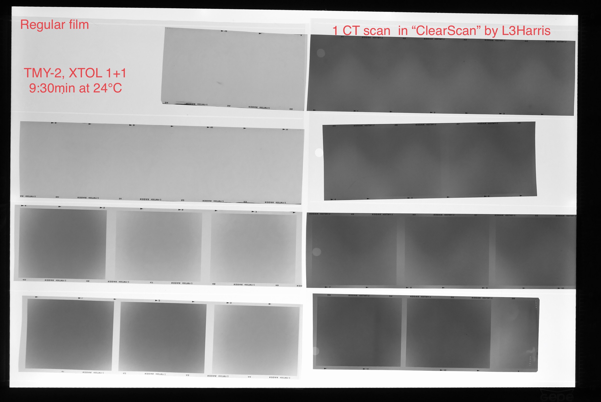

Here is some more real time experience with the new scanners in Amsterdam. I was flying from Germany back to the US, my flight connection was through Amsterdam. I got an additional security check going from the EU flight section to the international one there. They had one of the new carry-on CT scanners there, a “ClearScan” by L3Harris, here is a link: https://www.sds.l3t.com/aviation-checkpoint-screening/ClearScan.htm. It looks a bit different than the "Analogic" machine with the blue rings, but it is essentially the same thing, a CT scanner. I had a bunch of 120 roll film with me and asked for a hand inspection, which they fortunately did, although they did ask for the ISO values of my film. However, anticipating I might encounter a CT scanner on this trip, I left one 120 roll of T-Max 400 in my carry-on. That roll had some blank frames plus some frames exposed to approximately Zones 1-3 on it. I just developed it plus a similar roll that had not seen the scanner, shown side by side on the light table in the attached image - the regular roll on the left, the CT scanned one on the right. The new scanner fogged the whole film, unevenly, with some repeating patterns visible. The fogging is a bit weaker on the inside of the roll due to the shielding by the outside film layers. Measuring the additional density over the film base + fog of the regular film results in additional densities of 0.53 -0.59 for the end of the film (i.e. the outside of the roll) and 0.46 - 0.53 at the start of the film (the inside of the exposed roll). That is essentially the equivalent of a zone IV exposure with just one scan, which tells me that even ISO 100 film would get an uneven (!) zone 2 pre-exposure. If anybody could do a similar test with the Analogic machines, that would be appreciated. Btw, both films went through three regular X-ray carry-on inspections (non-CT). I actually intend to bring these two films with me on any future trip to show the security personnel (or the supervisor) if they refuse a hand inspection. If that helps, who knows.
Thanks acroell, this looks pretty conclusive evidence to me. Either hand inspections are now introduced or you may as well stop taking film on flights. Maybe the film companies will now exert some pressure on airports, making it clear that we have a revival of film and that film users are not insignificant group of travellers, assuming of course that in airport cost to benefit terms we are a significant group

Thank you for posting this report. It provides clear evidence of the effect of the new scanners. I am just curious about the film on the left that didn't go through the new scanner. That seems to have some fogging as well?
No, the one on the left doesn't have fogging apart from the regular fb+f (film base +fog) of TMAX 400 in this developer - the base of TMAX 400 is grey. The darker patches that you see in the lower parts are exposures of - in zone system parlance - approximately Zones 1, 2, and 3 by photographing a wall at about 50cm distance with the focus at infinity. You can see similar exposures in the fogged film on the right if you look closely. Since I did not know how weak or strong any influence of the CT scanner would be, I wanted to have some patches with weak exposures for measuring densities in those areas. A very low X-ray dose might not show up in blank film but might be measured in the density of a shadow area, similar to the "flashing" of photo paper. Obviously, that wasn't really necessary.

Here is some more real time experience with the new scanners in Amsterdam....The new scanner fogged the whole film, unevenly, with some repeating patterns visible.

Well, they actually did do a hand inspection -thankfully - for my other 120 rolls in Amsterdam, swabbed it for explosive residue, although somebody else earlier in this thread reported they denied it to him, also in Amsterdam. Before the CT scanners I never bothered to ask for a hand inspection except onetime also in Amsterdam when I carried Delta 3200 with me, and they allowed it then, too. I guess from now on I’ll always carry some Delta 3200 with me. I am really concerned when it comes to sheet film boxes of exposed but unprocessed film, because it’s not obvious that it’s film to your average person, and after exposure the factory seal will be broken.

Thank you Acorell, that fogging could indeed be caused by x-rays. It doesn't look catastrophic but it would certainly affect most photographs and make them much more difficult to print or scan.
