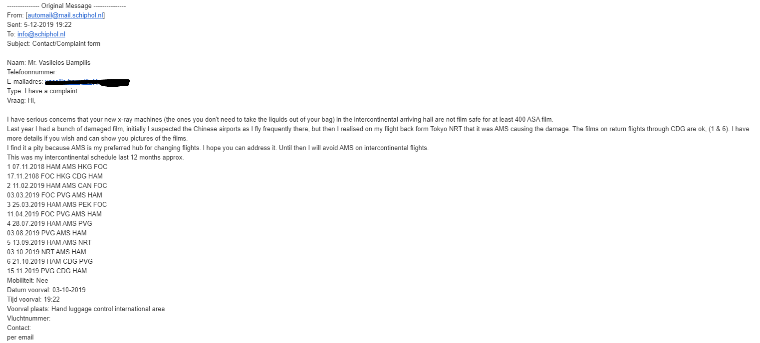

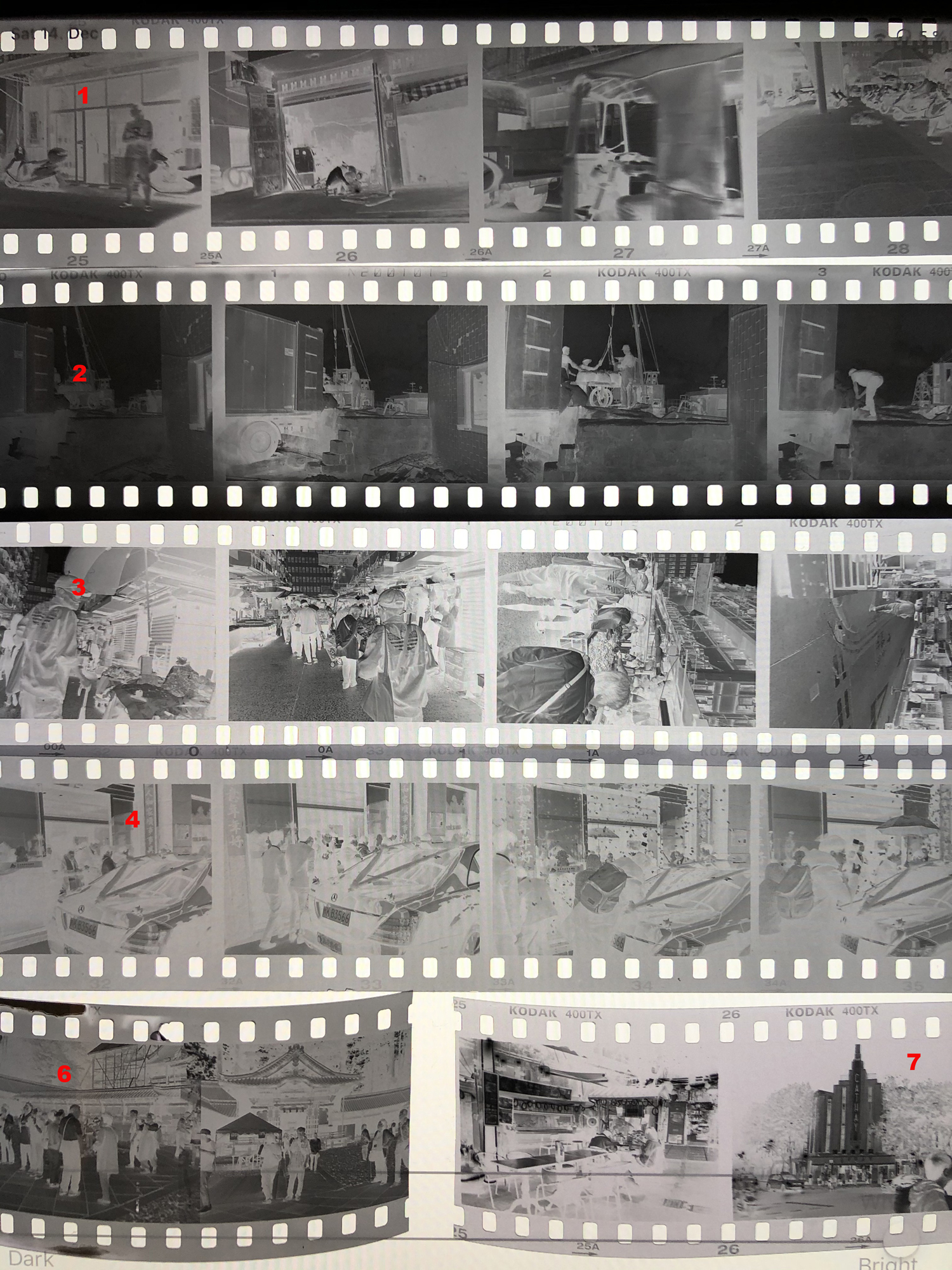

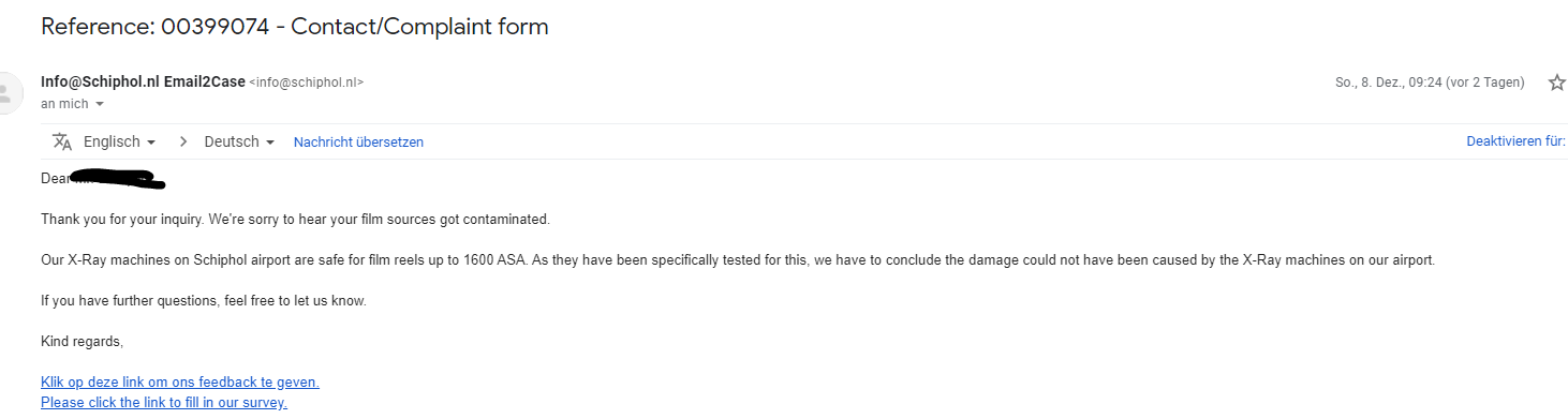

Hi,
unfortunately based on my experience with the new scanners in Amsterdam the last 12 months, they do damage films. I communicated this to the airport but I received a standard answer. I will send details in the forum with pictures from the negatives for each trip that I took through AMS and also through other airports to see the difference.
Hi,

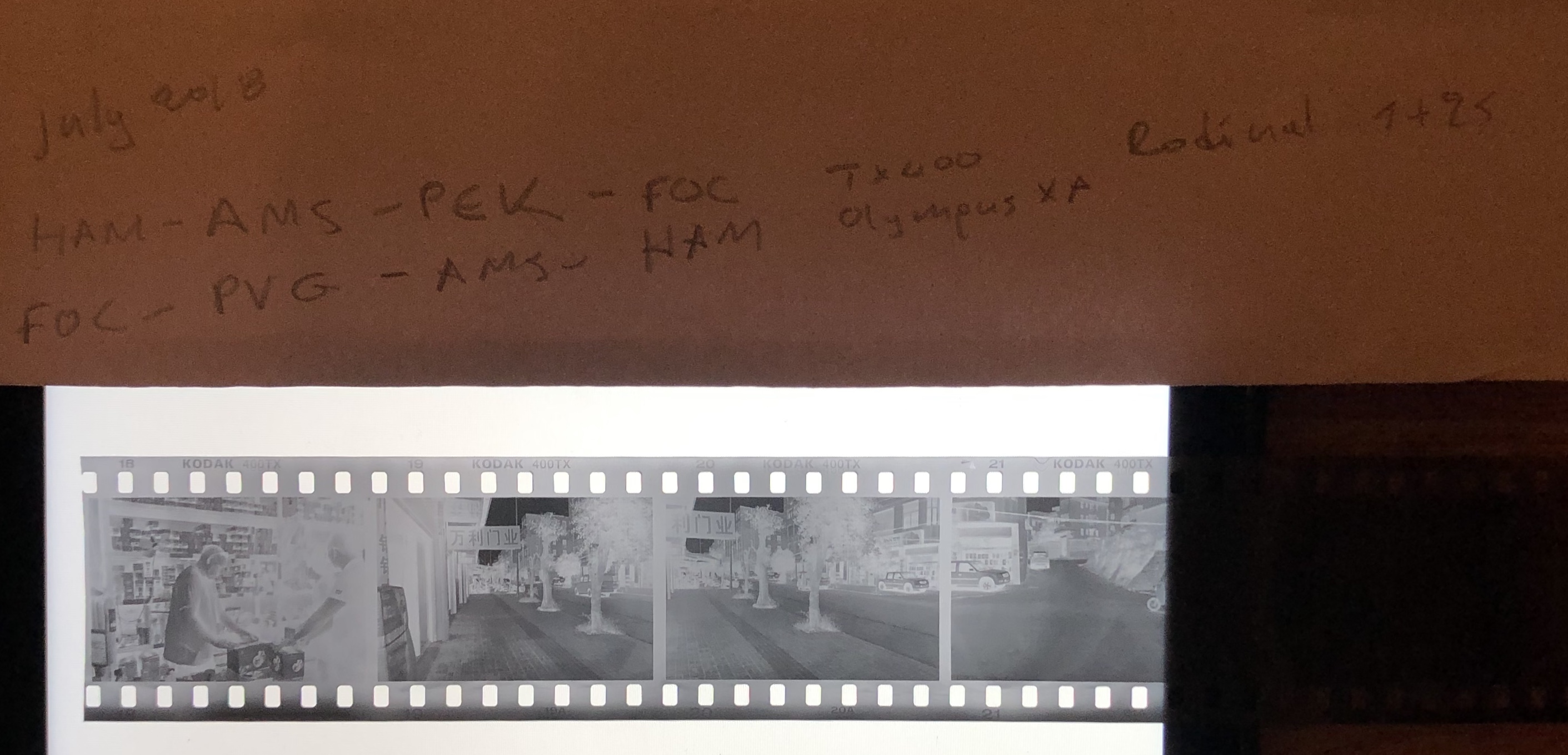

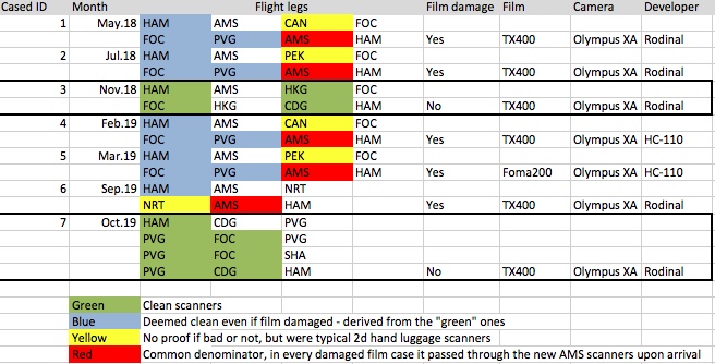

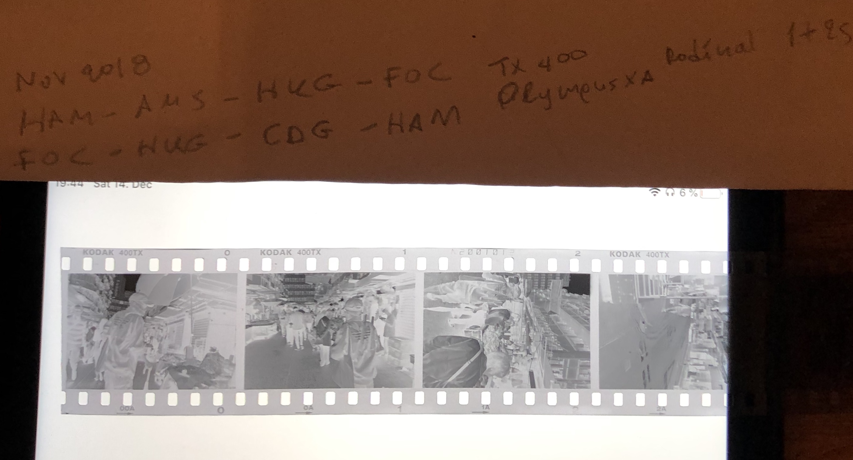

here the observations over the last 1.5 years passing by Amsterdam airport and travelling for the usually routes to China (and Japan in one case).
Same camera, same scanner (reflecta proscan), same development habits since 15 years.

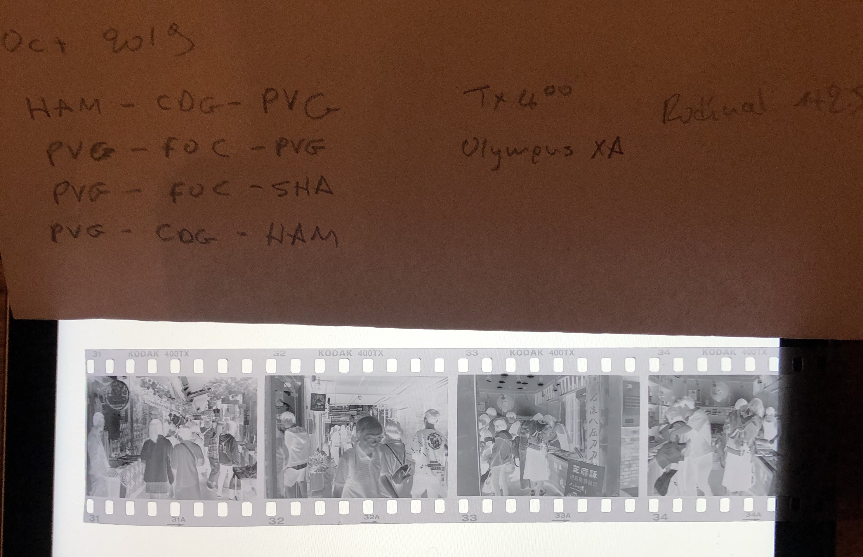

Case 1
Film severely damaged, film base is darker than my usual pinkish tx400. visible damage from scanner. Passed through AMS 3d scanner upon return.
here a scan from the strip:

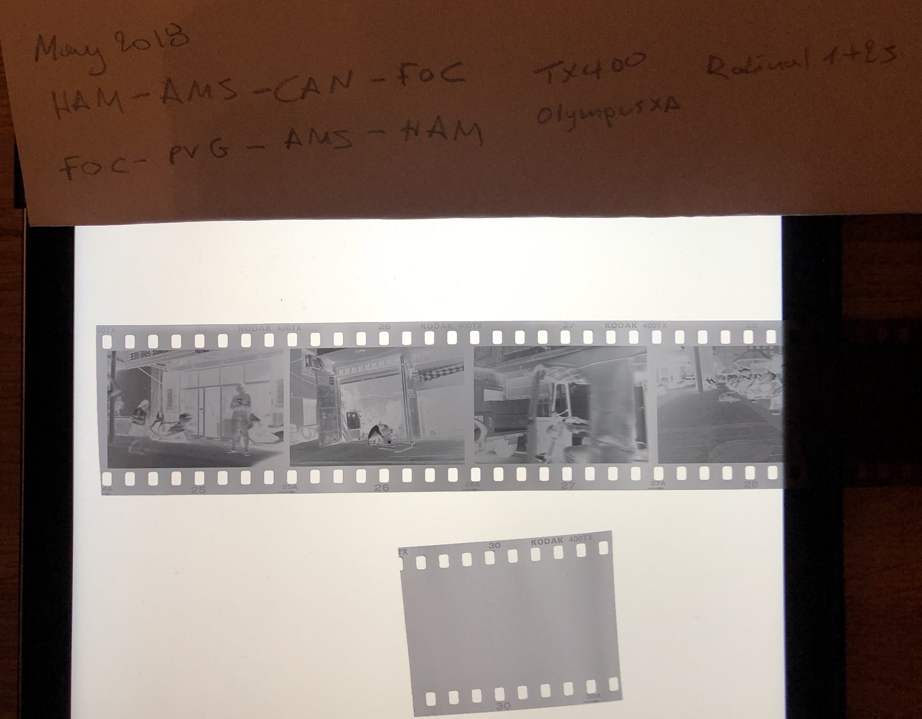

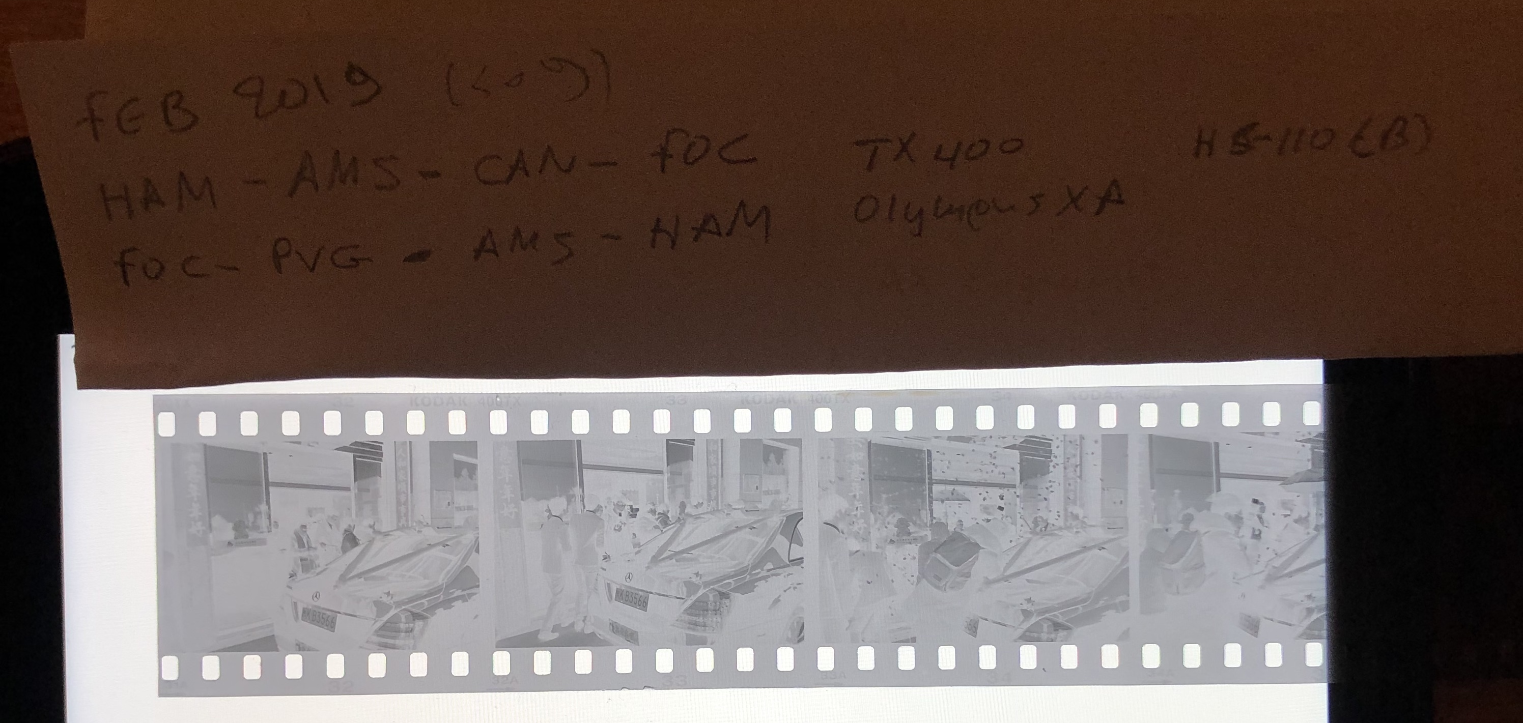

Case 2
Same as case 1 few months later, visible damage, dark base, bad grain, detail in shadow is lost
and a scan

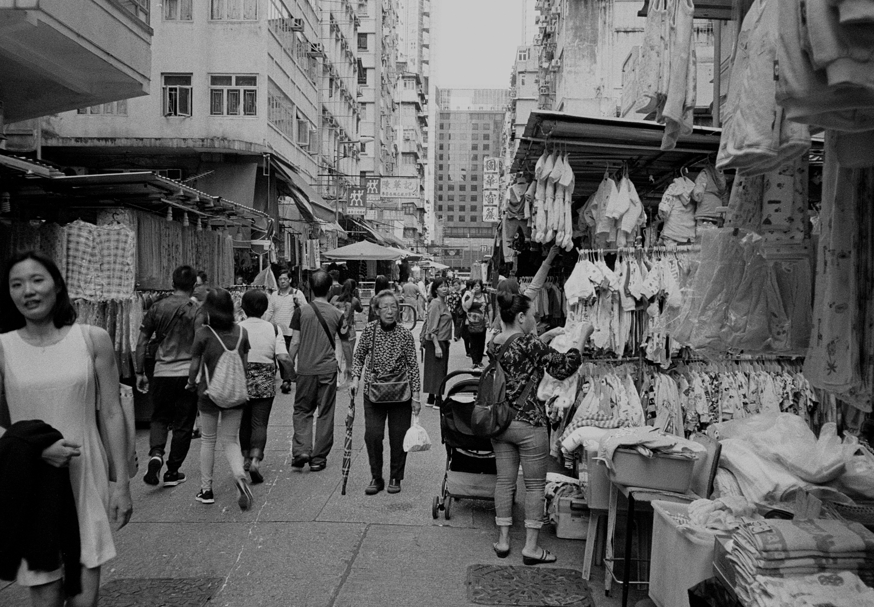

Case 3
No scan in AMS, came back through CDG. TX400 as I know it. Almost clear base,
Here a scan, good contrast, no harsh grain, good shadow detail.
Case 4
Passed the scanner in AMS, darker base, lack of detail in shadows.
and scan

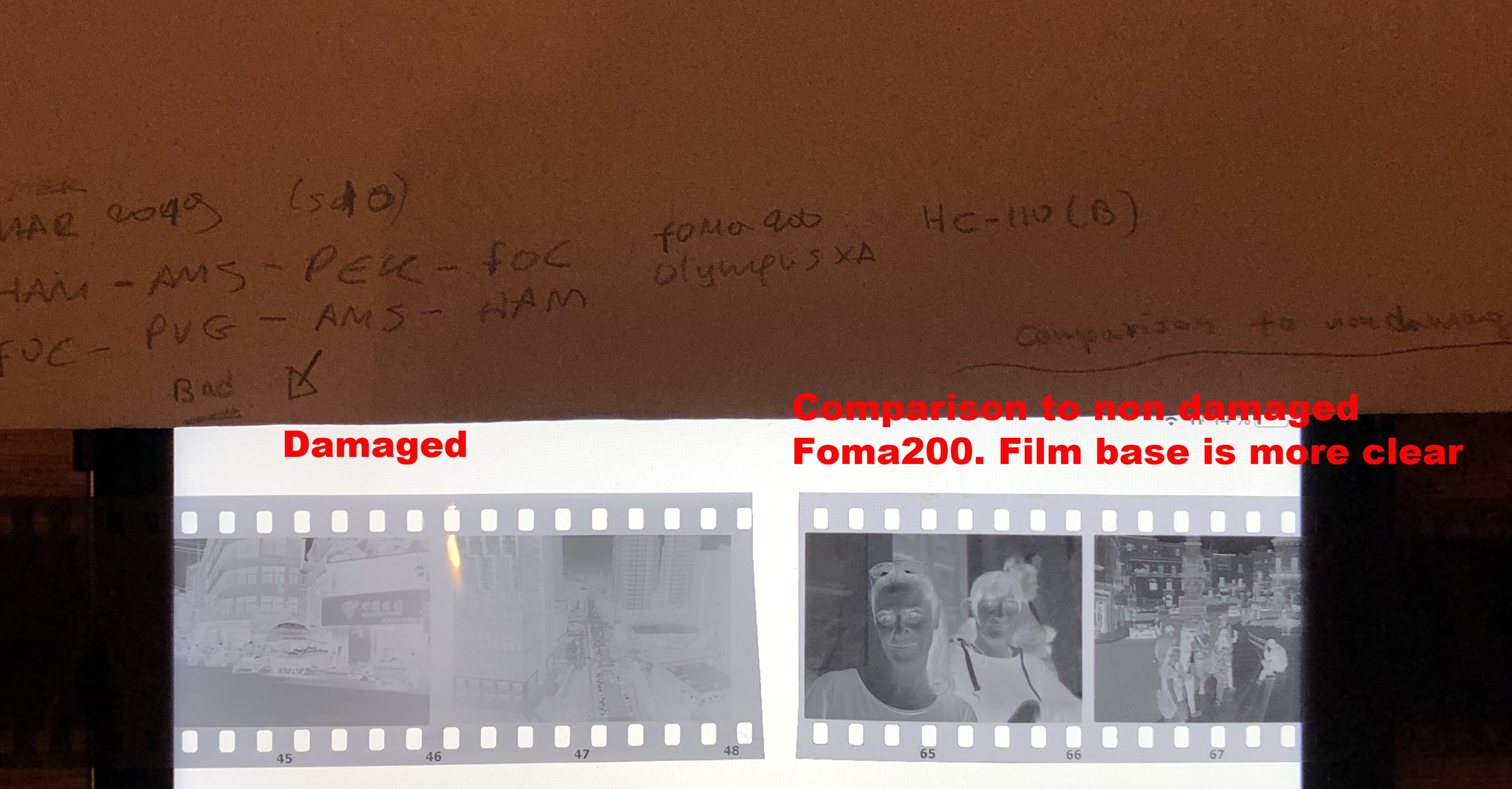

Case 5
Foma 200, you can see after passing AMS scanner the film base is slightly darker than what I get usually from Foma200
Looking at the scan, grain and lack of detail in the shadow is obvious.

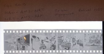

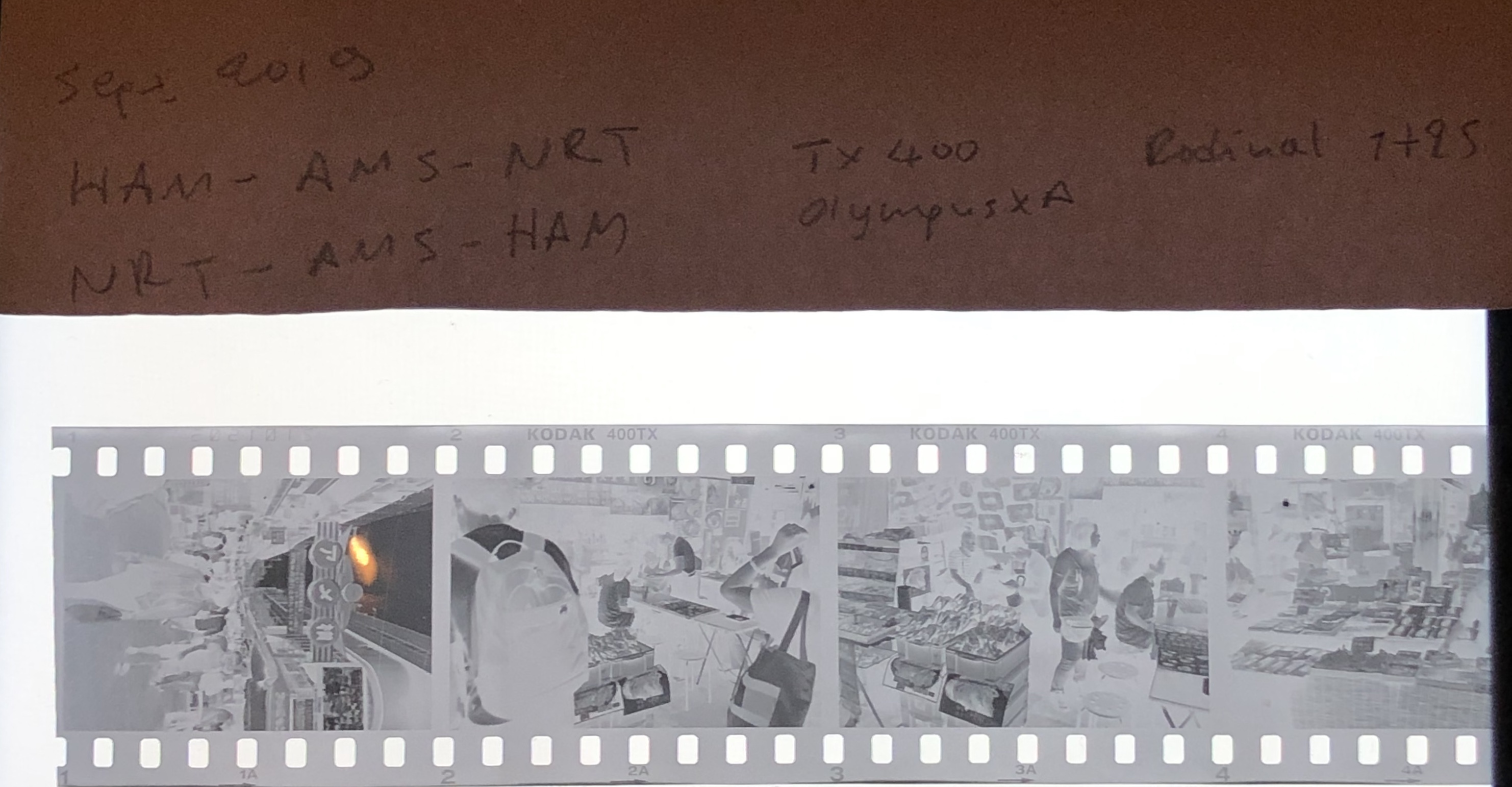

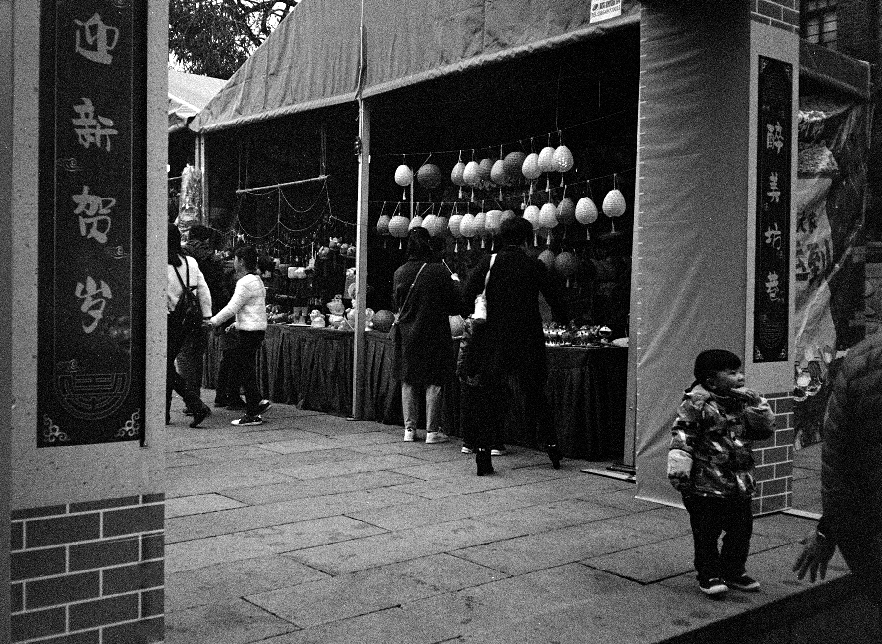

Case 6
This is the case thad was the breakthrough in my observations. I was always suspecting the scanners in China but I was wrong. Flying to Japan and coming back through AMS (after shooting 25 films...) I realised that all the 400 ones are damaged (half of them)
The film base is darker than a normal tx400
Here a scan, detail in the shadow low and grainy.
Case 7
A case supporting my observations, I chose to go through CDG to China instead of amsterdam's. The films passed multiple times as you see through hand luggage scanners in China. All turned out in to be in very good condition. No dark film base, no flat images, no exaggerated grain in the shadows
and a scan

The AMS airport management seems not to be taking this seriously,
Here an image showing all TX 400 of the above cases side by side, you can spot the good ones.

It appears the jury (of one) has conclusive evidence that the CT scanners in Amsterdam ARE DAMAGING to ISO 400 after a single pass!!!, and the 'control' test thru Paris's scanners (non CT) are NOT FOGGED.

That’s completely consistent with all prior knowledge. I commend this kind of investigatory action!

Err...that doesn't look like x-ray damage....X-rays don't cause uniform base fog. Unless I am missing something i the pictures of negatives that you've posted.
That’s what I was thinking. As I stated before, I never had any problems with films scanned on Schiphol, since those new scanners were installed.
