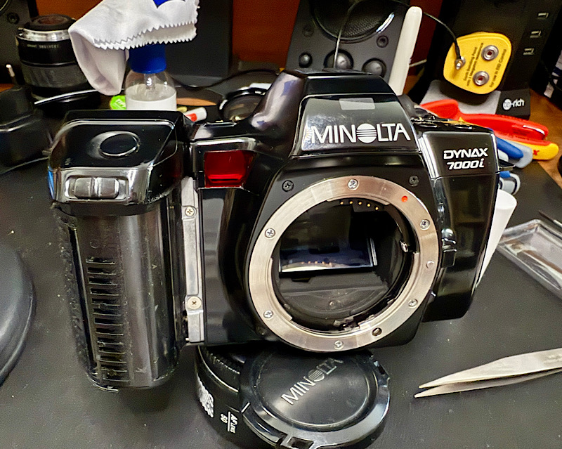

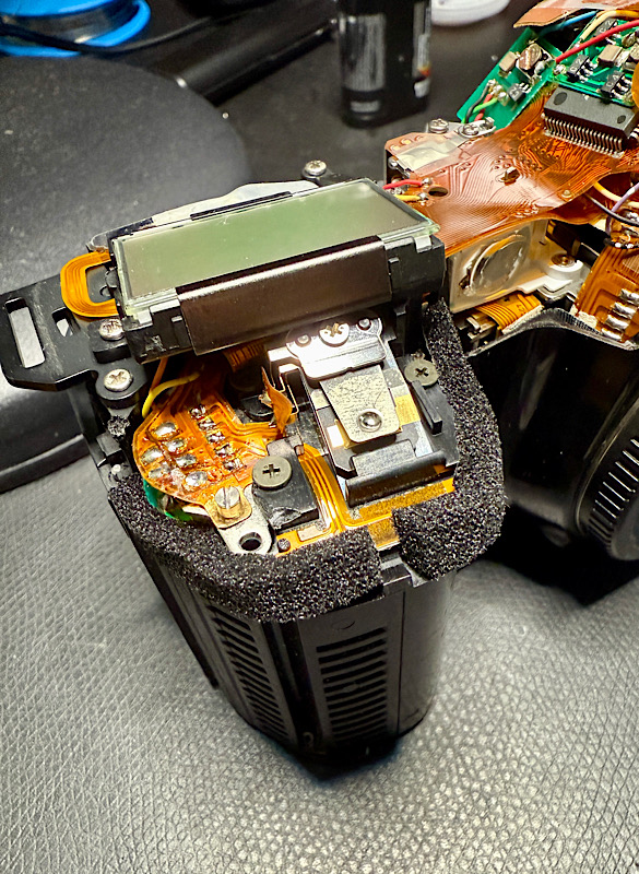

Removal of mirror box and shutter, check of shutter magnets SL1 and SL2
Since I don't believe that IC4 is defective or has a soldering error, I decided not to measure it with the oscilloscope and just removed the shutter unit for examination.
Besides, I wanted to disassemble the 7000i for study purposes anyway.

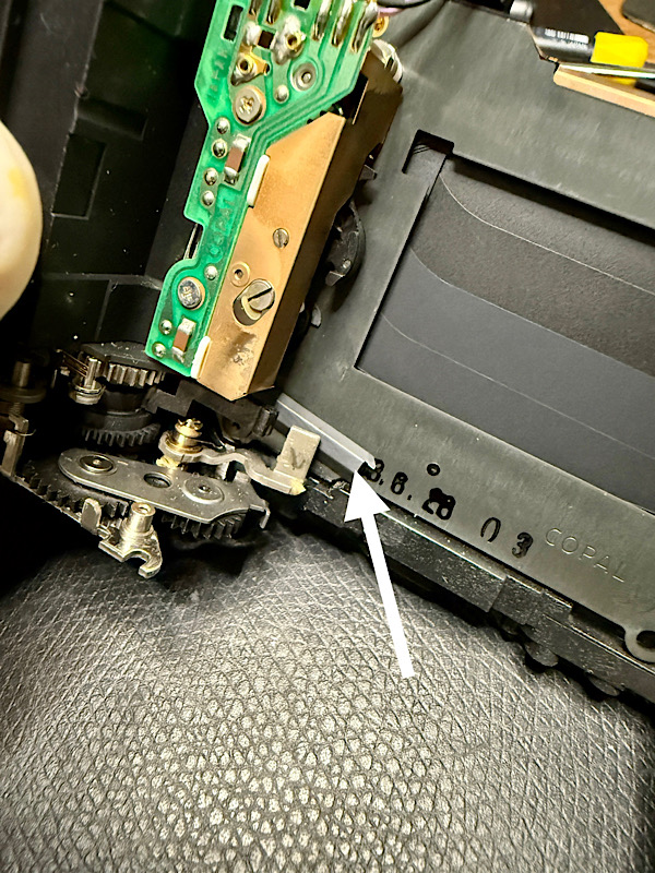

Mirror box removed.
This part in the shutter mechanism area doesn't belong here. It may have interfered with the movement of the second shutter curtain.
It's likely a cover on the shutter frame that came off.
I'll look into it.

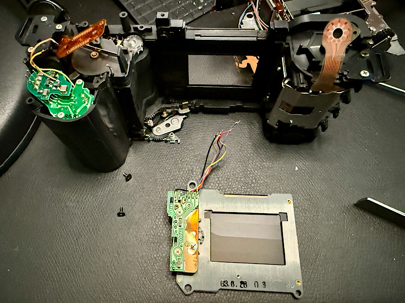

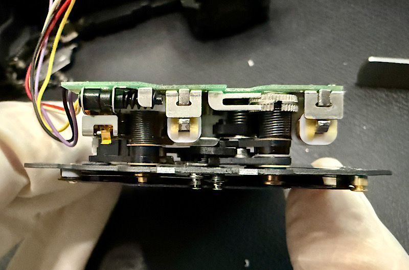

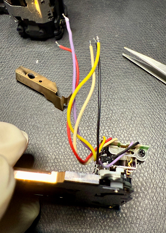

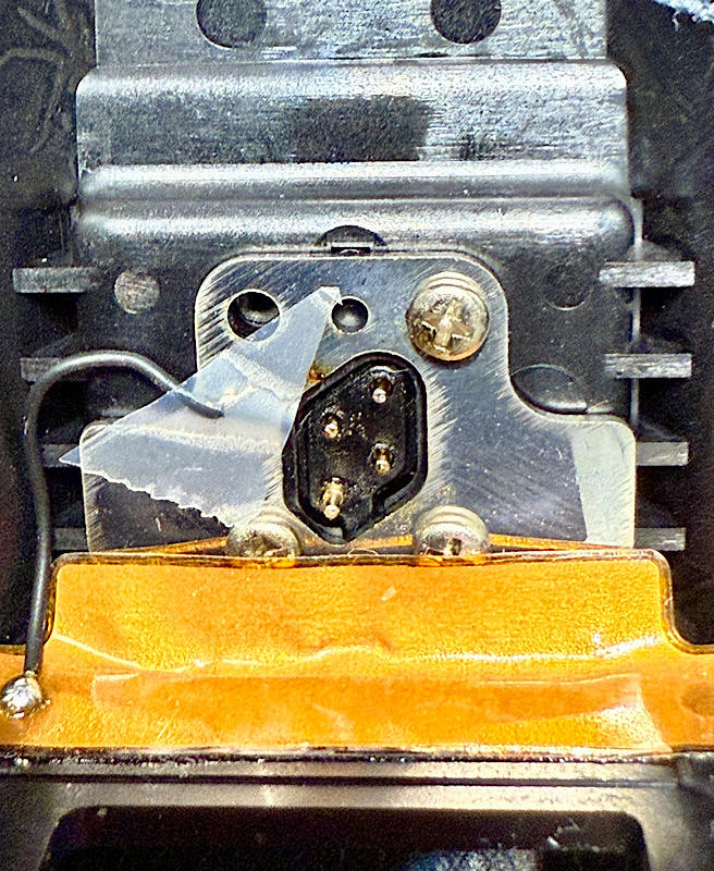

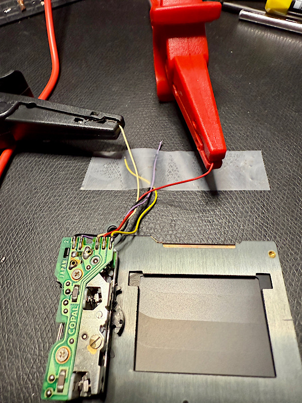

Shutter unit removed.
The cover frame around the shutter mechanism towards the two curtains has been removed.
The contact surfaces and armatures of the two magnets SL1 and SL2 are now visible.
Inspection of the white cable according to Larry Lyells' instructions in the SPT Journal reveals no abnormalities. The cable is undamaged and fully soldered.
This error is therefore ruled out as a possible cause of the short shutter speeds deviation.

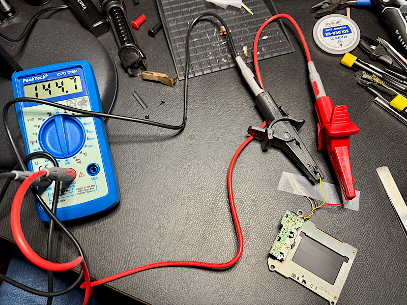

I want to measure the resistance of the coils of both magnets. To do this, I'm looking at how the conductors are connected.
SL1 is connected via the white and red cables, SL2 via the yellow and red cables.
Measuring the coil of SL1 with a multimeter.
The target value is 146 ohms, which is exactly achieved.
The coil is OK.
SL2 also complies with the specification.
All that remains is to clean the contact surfaces of the magnets and reassemble the 7000i. If this resolves the issue, the mission was successful.
However, it's also possible that the cover on the shutter that came off was the cause of the problem.
We'll see.

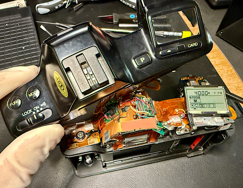

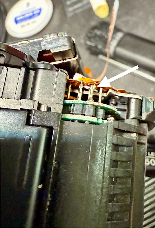

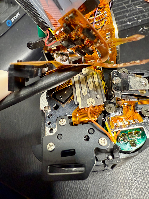

Removal of mirror box, some impressions
The mirror box removal is described in detail by Larry Lyells in the SPT Journal. Therefore, I'll limit myself to a few impressions.
Connecting a solder bridge to the two test contacts of the main switch.
This means that the 7000i can be triggered even without the main switch contact in the top cover.
The top cover can be temporarily attached to make adjustments. For example, switching from P to M and setting the shutter speed to 1/4000 second.

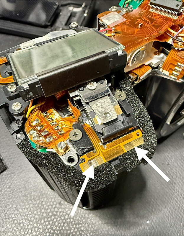

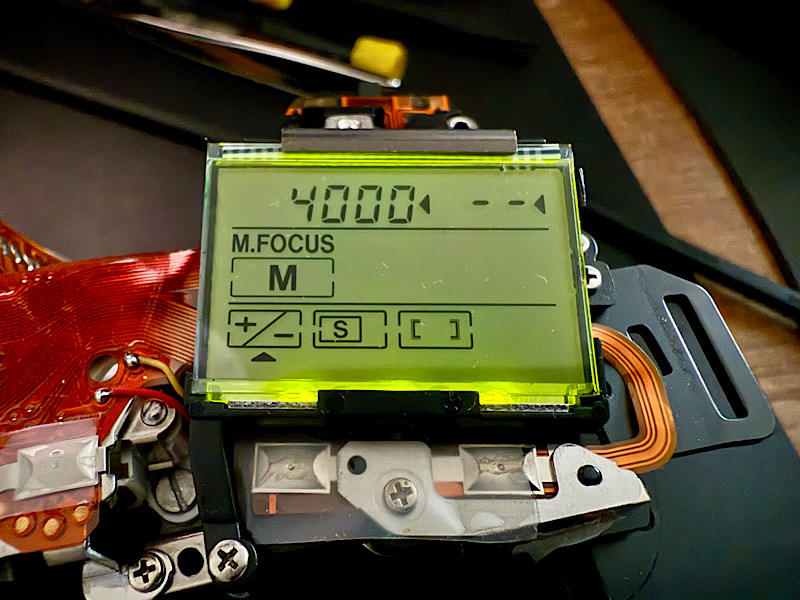

Three green LEDs illuminate the main LCD.

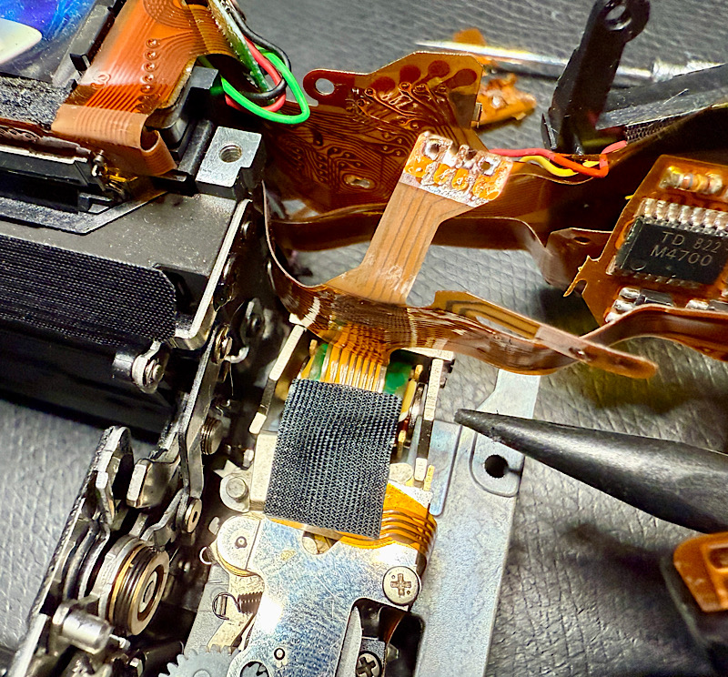

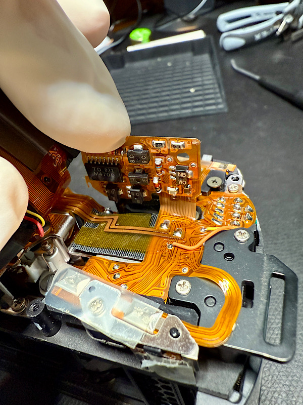

Under the main LCD, the 7000i is tightly installed with several circuit boards stacked on top of each other.

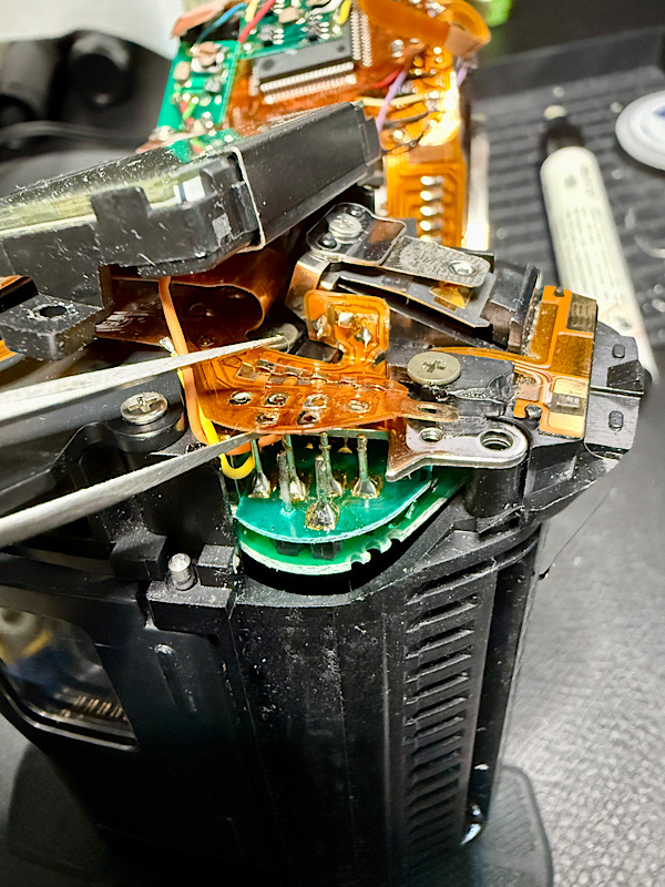

Circuit board fixed on soldered pins.
A pressure-connector plate under the main LCD …
… which lies on the release base plate underneath.
To be able to distinguish between cables of the same color before desoldering, I mark them with white paint.
Removal of screws on the bottom.
Removal of the manual-aperture key.
Mirror box separated.

Messuring curtains travel times
It would be a good idea to measure the curtains travel times before assembling the 7000i and adjust them if necessary. This could also provide information about whether the two shutter curtains are moving mechanically correctly.
The Copal S(quare) shutter should be the same type as on the Minolta 7000 AF.
Both curtains are tensioned by a lever and released electronically. SL1 and SL2 are electromagnets that hold the curtains and release them as soon as current stops flowing through the coils.
For this, I would have to set up my breadboard to examine the shutter in the camera tester; for the 7000 AF, see here:
Post in thread 'Copal S(quare) Shutter: Testing when removed?'
https://www.photrio.com/forum/threads/copal-s-quare-shutter-testing-when-removed.212393/post-2880972
There is a risk involved.
If I misunderstand how the shutter works, I could damage it through incorrect operation. I don't have a replacement. But I also want to learn something new.

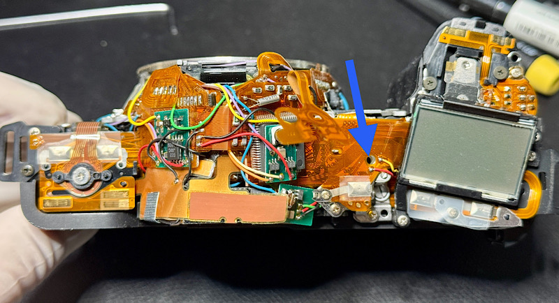

Adjustment of the first shutter curtain possible from the outside
The first shutter curtain (opener with SL1) can be adjusted via an opening in the upper plate without removing the shutter:
1. Curtain-travel time
Reach the 1st-curtain travel-time
adjustment through the hole in the
flex -- C in Fig. 4. Turn the
1st-curtain worm clockwise to add
tension. To reach the 2nd-curtain
adjustment, it's necessary to remove
the mirror box.
The blue arrow points to the opening for adjusting the first shutter curtain. The top cover is removed.
The shutter from the side.
The pink arrow points to the standard ratchet wheel with a pawl for adjusting the spring tension. Here, it's for the second shutter curtain (with the SL2 magnet).
The blue arrow points to a rotating thread that is adjusted vertically via a screw. A screwdriver can be inserted through the opening in the board above.
Hopefully I can turn the adjustment screw in both directions to also reduce the spring tension if necessary.
This design makes adjusting the curtain travel times convenient
The first shutter curtain is easily adjusted to the second curtain using the opening and screw. The shutter does not need to be removed for this purpose.
If the second curtain travel time does not deviate significantly from the target value, the shutter speeds are also correct.

This test shows that SL1 and SL2 are electromagnets and not permanent magnets.
Neither magnet holds its armature without a power supply:

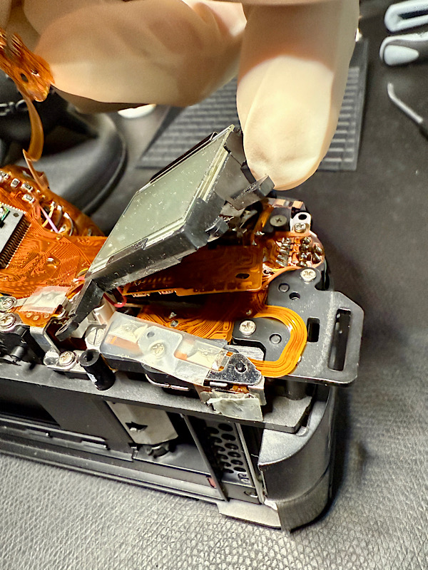

Before assembly, the mirror must be flipped up. To do this, push this part of the mirror magnet.
Aperture control and mirror mechanics.

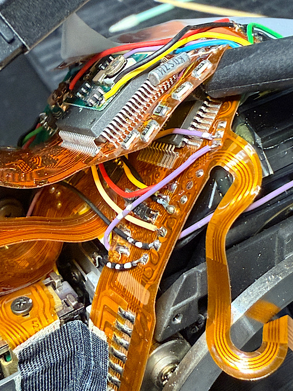

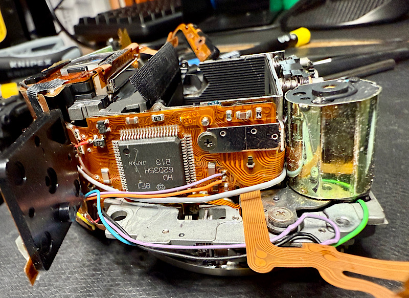

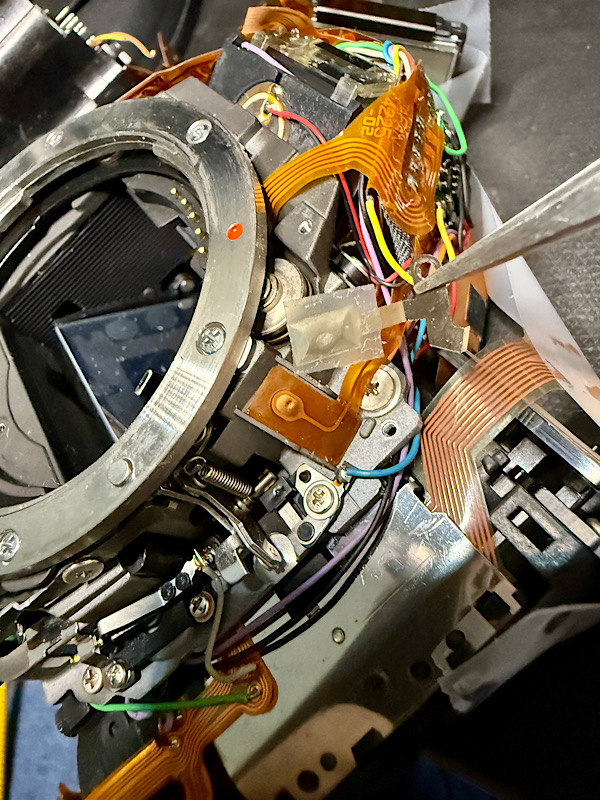

Left side of the mirror box with IC1 and AF motor.
These two cables were obviously crushed during assembly.
I checked the continuity with the multimeter, and both are OK.
DC/DC converter connections.

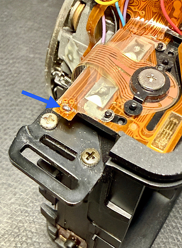

I damaged a delicate conductor path while desoldering and had to fix it with a piece of wire and solder.
I noticed the problem after reassembly and testing when the AF started moving back and forth and the AF lamp didn't work.

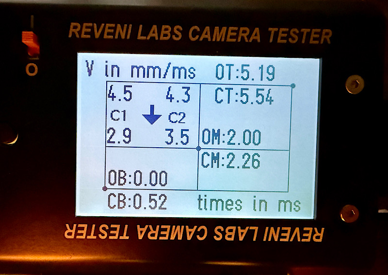

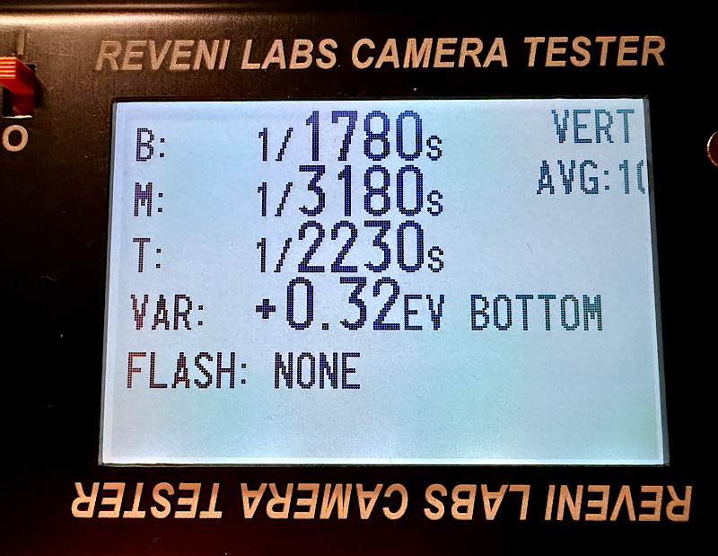

The 7000i on the camera tester at 1/4000 second, which I adjusted as best I could using two trimpots on the circuit board.
I couldn't reach the first-curtain adjustment screw with my screwdriver through the opening in the circuit board on the top of the camera. I would need a thin, long crosshead screwdriver for that. So I couldn't set the curtain travel time.

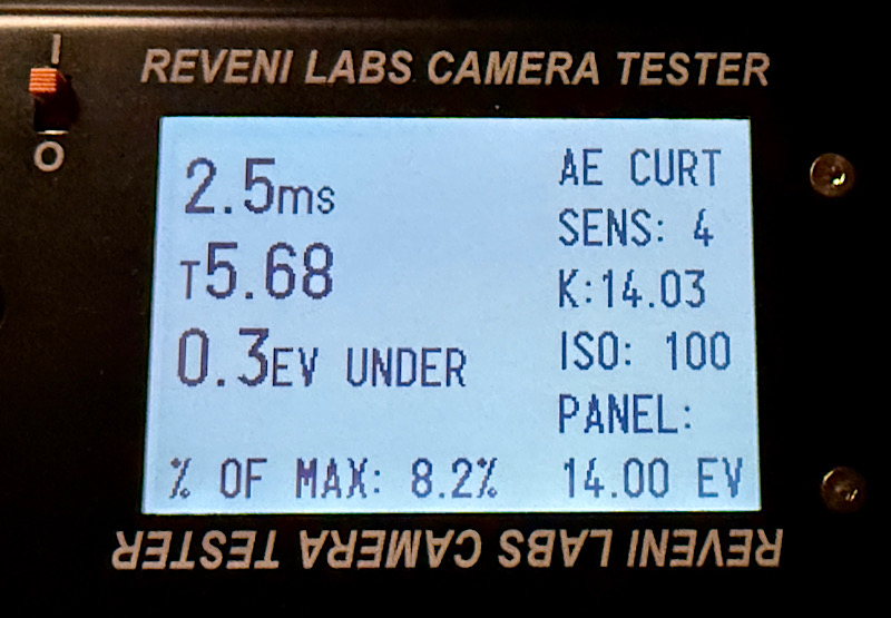

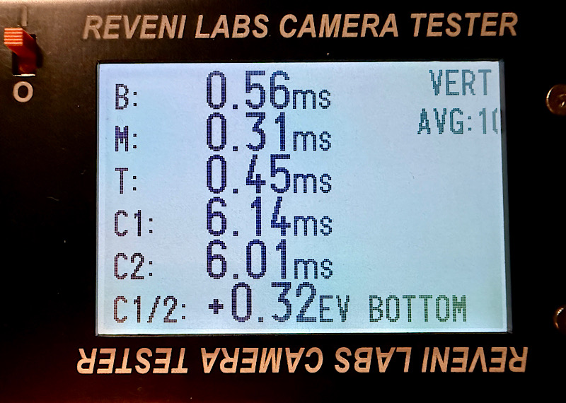

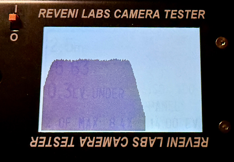

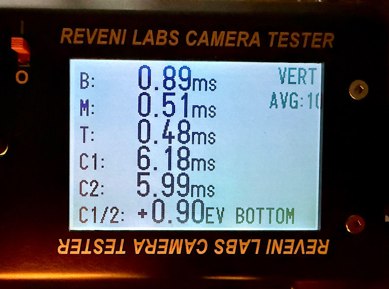

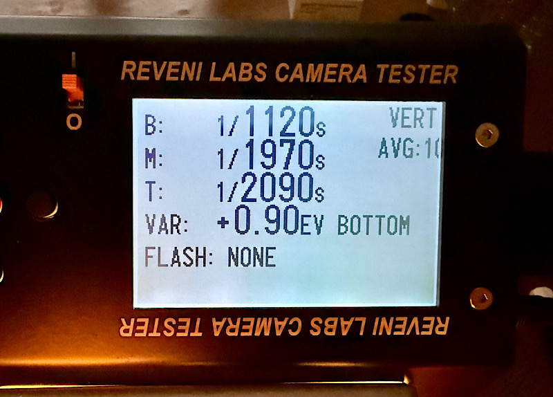

Average, minimum and maximum EV deviation values for each of the three sensors at ten triggers.
Shutter speed significantly below 1/4000 s and a deviation towards the top sensor of 0.90 EV.
Value for the middle sensor in milliseconds and deviations in EV.
Accelaration and time marks of curtains.
The shutter speed of 1/4000 s is not reached. However, the exposure deviation decreased after several exposures. The camera has obviously not been used for a long time.
According to Larry, curtain travel times are 5.5 ms (here 6.18 ms and 5.99 ms). To adjust both curtains, I would have to remove the shutter again, adjust it, and set up my breadboard to electrically trigger the curtains on the camera tester. I don't want to invest that much effort.

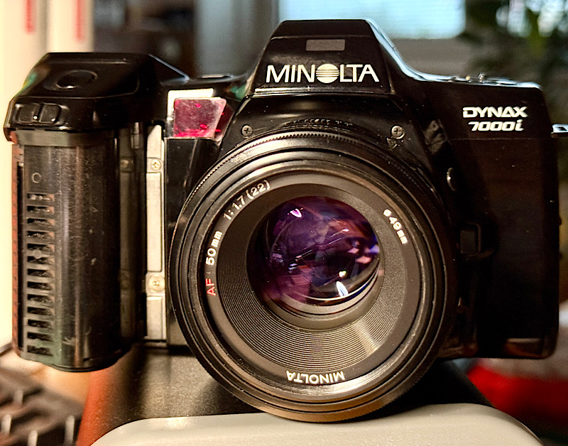

Exposure in P mode.
The Minolta AF 50/1.7 lens I used for the test doesn't set the apertures quite correctly. This deviation is reflected in the result, which still is very good.
Despite a significant deviation at the fastest shutter speed, the 7000i can be used for photography again after the repair.
Test photos to follow 🙂

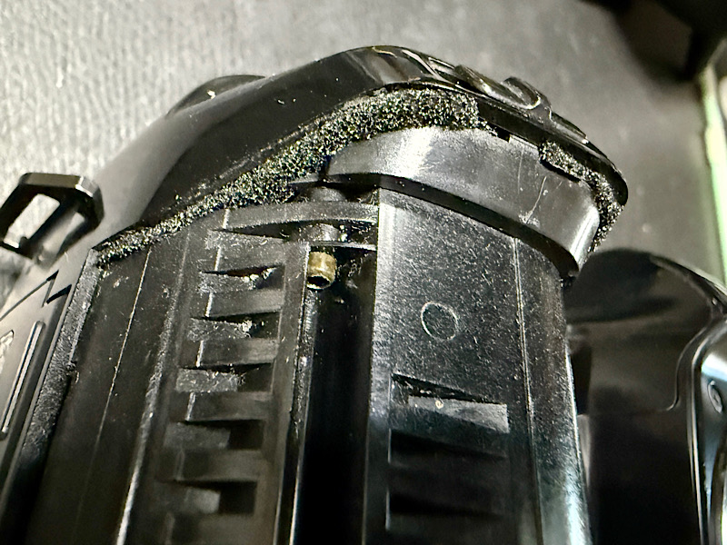

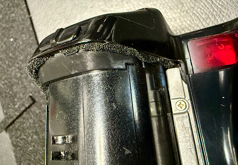

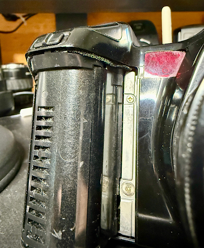

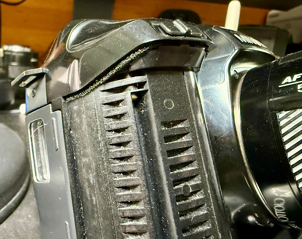

  • Even without the rubber cover on the handle, which had become brittle and therefore had to be removed, the 7000i is comfortable to hold.

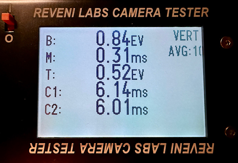

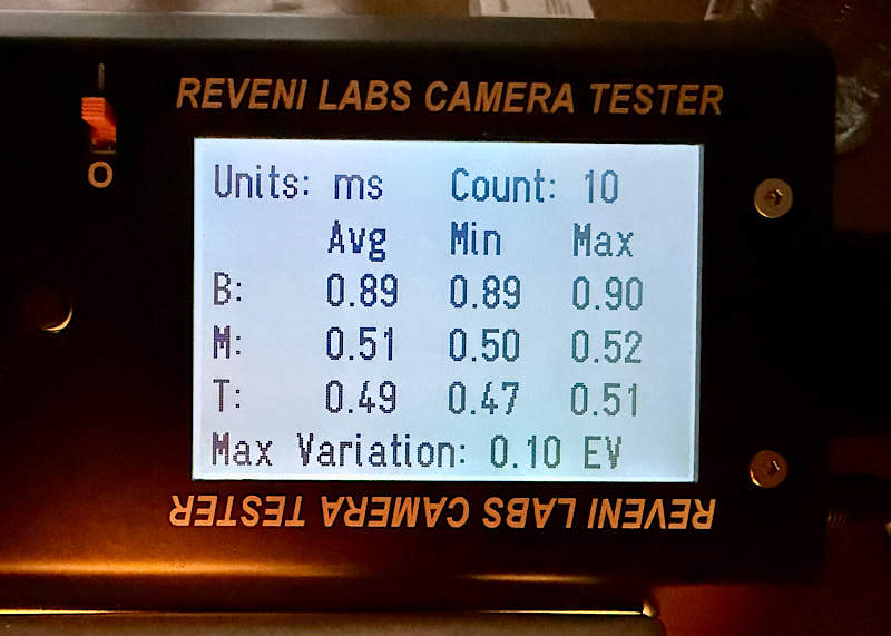

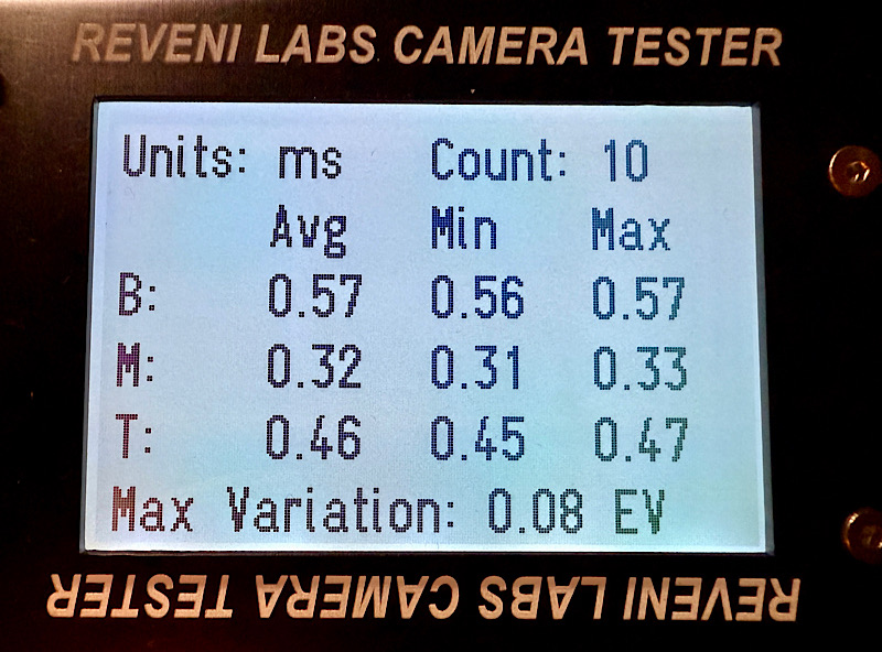

Repeated measurements on the camera tester, result now significantly better
Due to incorrectly set correction values, my camera tester displayed significantly different values.
I corrected this error, and the real values for shutter and exposure are now very good:
Shutter speeds (average, 10 triggers) at the critical 1/4000 second.
The exposure deviation is now within the tolerance range. The actual shutter speed is also now significantly closer to the target value.
Excellent exposure value in mode P (the lens aperture is slightly misaligned).
This makes the repair a complete success! 😃

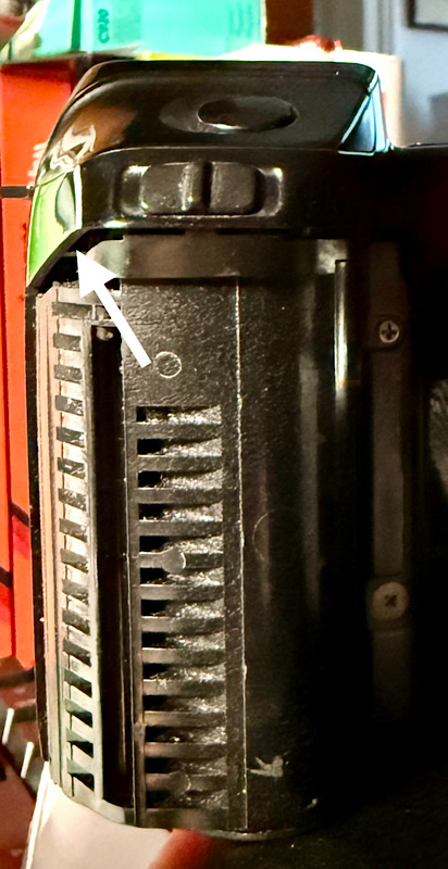

After removing the crumbling plastic covering on the handle, there are gaps around the upper edge. Parts of the circuit board underneath are visible.
This shouldn't be a problem as long as water doesn't get in.
Sugru can be used to fill them.
All information provided without guarantee and use at your own risk.

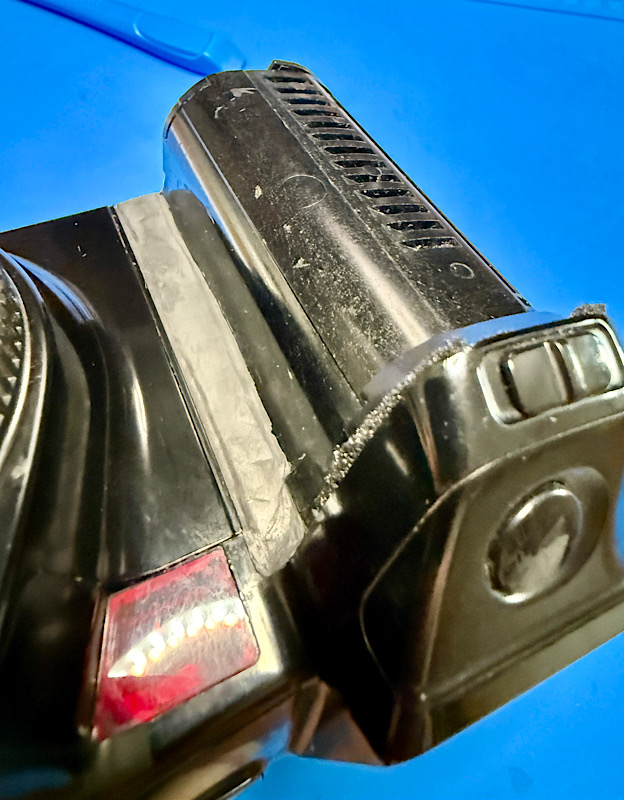

Joint sealing with self-adhesive foam strips
With self-adhesive foam strips for mirror shock absorbers, the gap between the handle and the top cover can be closed precisely.
This provides sufficient protection against moisture and dust. The top cover fits over the upper edge of the strips, thus securing them further.
I don't seal the gap under the red AF-assist light and along the handgrip. This area should be sufficiently closed.
Damage to the hot shoe due to desoldering
The hot shoe contacts are connected to the main board via a strip of flexible printed circuit board. To detach them from the top cover, they must be desoldered via four soldering points.
Due to the heat applied via desoldering braid, the contact pins in the hotshoe have shifted in the plastic socket and can no longer be moved.
I could try to reheat it to its original downward position. But I'm not going to do that, since I'm not using a flash on this 7000i anyway. So I secured the circuit board with the contacts and the black cable on the hot shoe with tape and so insulated it.
One more thorough cleaning of the exterior. This completes the work on the 7000i.
Photos of the first work session during a walk through Vienna follow soon.
Cleaning with a blower, brush, isopropyl alcohol on a microfiber cloth, cleaning sticks and lens cleaning fluid.
I had previously cleaned the mirror from dust and haze using a blower, brush, cotton swab with a wide surface and slightly moistened with purified water.
Dressed up for a walk 🙃
Correcting the joint sealing
I erroneously had taped over the two contact surfaces for the slide switch, which meant the switch no longer worked.
I corrected that.
Now the switch switches again.
Completed

Further joint sealing with Sugru
To completely seal the inside of the camera, I finally used Sugru.
Here's phase 1 after application:
Phase 2 is drying, and phase 3 is fine sanding and painting black.
If I have to open the camera again, the seal will also have to be replaced.
