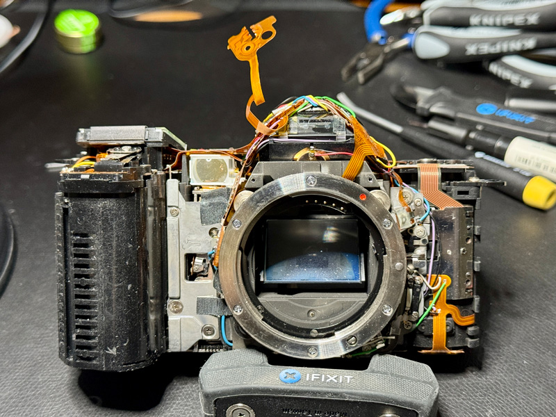

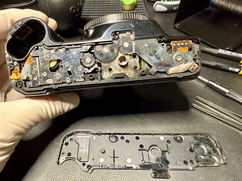

I just have managed to get three defective 7000i practically for free 🙃
I plan to open and examine one of them, following the instructions in the SPT Journal January/February 1991:
A Minolta Service Manual seems not to be available.
I'm particularly interested in the extent to which the 7000i can still be DIY repaired and how the internals differ from the Minolta 7000.
I suspect that with the 7000i I am going to reach the limit of repairability, which I originally set with the Minolta 9000 AF. But I'm open to surprises.
I still also assume that it's not the integrated circuits that are failing, but the peripherals, i.e., contacts, connections and mechanical parts.
Here, too, we are breaking new ground, at least as far as repair reports on the web go. I haven't found anything on this except @ogtronix teardown at
I'm curious to see how the expedition goes 😌

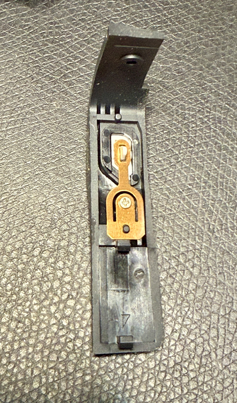

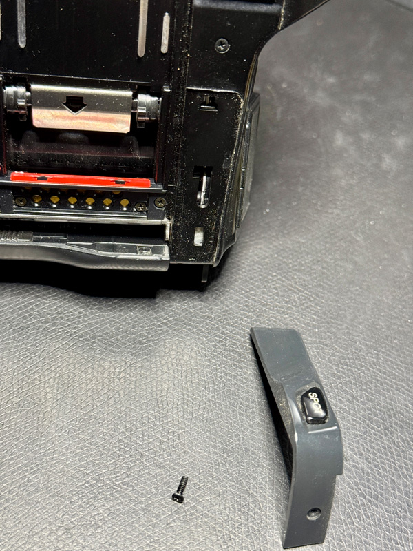

The golden contacts still need a thorough cleaning, including those in the camera.
The card is inserted into the side flap …
… and can be switched on and off.

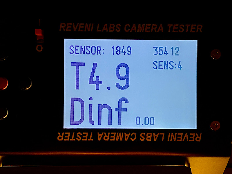

Candidate number two works perfectly

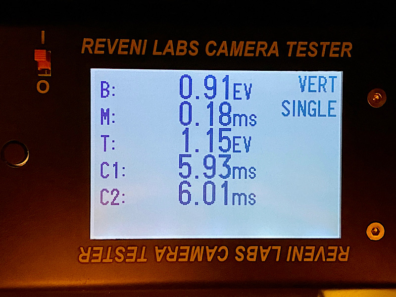

Here are the results on the camera tester for the shortest 1/4000 second.
The distance between the curtain travel times decreased after a few shots and thus also the exposure deviation in the image.
Apparently the camera hasn't been used for a long time.
Shutter test
The measurement is carried out using three sensors.
The camera tester offers four displays for a measurement result:
1/4000 s: Curtain travel times for the opening (C1) and closing (C2) shutter.
Above are the shutter speeds measured per sensor in milliseconds.
5.5 ms is the target curtains travel time following Larry Lyells in the SPT Journal. The result is close.
The shutter speeds shown as usual fractions, below the exposure deviation in the image shown as exposure value (EV).
You can see how the shutter curtains accelerate and decelerate. The exposure error is acceptable and decreases steadily toward longer shutter speeds.
Here the exposure deviation is displayed for the upper and lower sensors, while the measured shutter speed for the middle sensor is displayed in milliseconds. Below that, the curtain travel times.
In the first quadrant at the top left, the acceleration of the shutter curtains is shown in millimeters per millisecond.
Quadrants 2 to 4 show the opening and closing times of the shutter curtains per sensor. In the middle sensor, the first shutter curtain opens the slit after 1.91 ms, and the second shutter curtain closes it after 2.09 ms.
This gives an idea of the uniformity of the exposure slit as it speeds across the image.

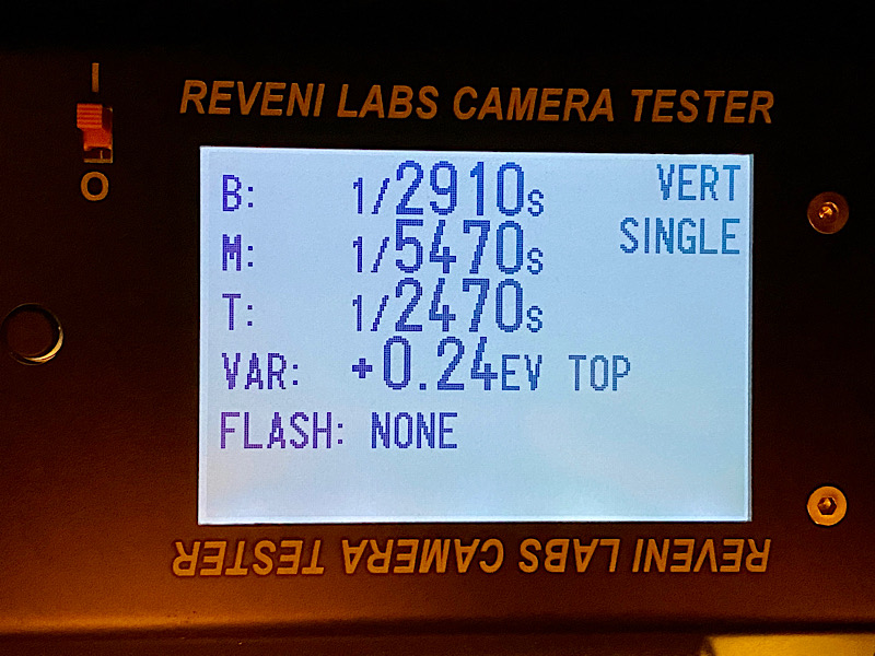

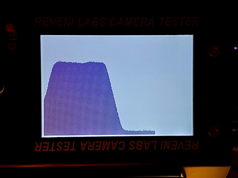

Exposure test
Exposure test with a Minolta AF 50/1.7 lens attached at EV (exposure value) 15 and ISO 100.
The camera tester determines whether the 7000i sets a correct shutter speed/aperture combination for this brightness and at this assumed film speed.
It does, here in program mode. The target and actual values are identical, with no deviation in EV.
The diagram shows the exposure process.
The horizontal axis represents time, the vertical axis represents exposure.
It can be seen that the process is smooth.
What's going on with the tail on the right is interesting. The exposure should have already ended. I'm hoping the shutter isn't slowing down when closing.

I'll counter that with pictures when I open the camera and try to fix the shutter.
There's nothing cheap or inferior about it; the thing is solid and well-thought-out 🥰

It turned out that one of the 7000i
has a problem with the shutter. The camera couldn't even build the medium shutter speeds, but otherwise everything worked fine.
Ideal for a first attempt at repair!
In the SPT Journal, Larry Lyells provides detailed troubleshooting information.
Regarding this error:
I suspect the magnet because the camera was used for a long time by the previous owner and it is unlikely that the solder joints will dissolve or the IC will become defective.

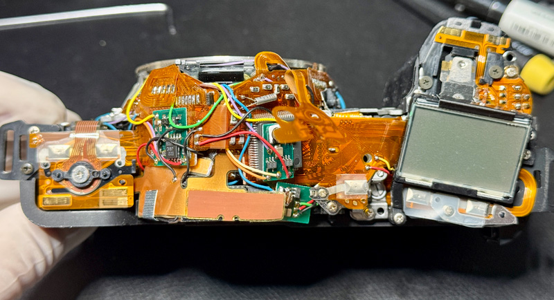

The circuitry of the 7000i is more advanced and therefore more complex than that of the 7000 AF.
Digital technology enables advanced functions and calculations and is housed in integrated circuits.
As with the 7000 AF, there are block diagrams that provide information about the individual functional groups of the circuit (SPT Journal). What happens inside the integrated circuits remains unknown.
This isn't important for repair purposes; the only thing that matters here is that the individual electronic components function, especially their connections.
Nevertheless, you shouldn't give up and can try to understand the basics of such circuits. Then you can get an idea of how such microprocessor-controlled camera circuits work.
Anyone interested in this only needs minimal knowledge of analog electronics: voltage, resistance, current, the transistor as a switch, power supply.
Digital electronics, which deals with binary switching processes and even computers, builds on this.
I would like to encourage anyone who is interested in repairing newer cameras to also delve into this area of electronics.
What may seem confusing and dryly abstract becomes understandable if you approach it step by step.
At least then you'll know a little more and won't just shrug your shoulders when you remove the top cover from a camera like the 7000i.
I've found that older textbooks present the field of Digital electronics very clearly. Of course, this isn't state of the art, but the fundamentals remain the same.

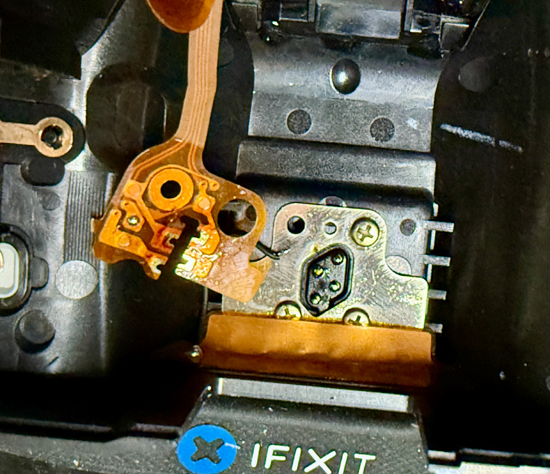

The suspected problem with my 7000i is that one of the two shutter magnets is dirty (see above). This results in shutter speeds that are too long above a certain threshold.
This means that removing the shutter and cleaning the magnet from the outside should offer a chance of solving the problem. Even if I can't adjust the shutter.
The 1/4000 second (and the 1/2000s) may then no longer be within the permissible range, but the camera can still be used.
I believe that cameras like the 7000 AF, 9000 AF, and 7000i cannot be properly serviced without instructions.
Eg. to work on the shutter, the mirror box must be removed. Even with experience, it's hard to know which cables/connections to disconnect and which components to remove.

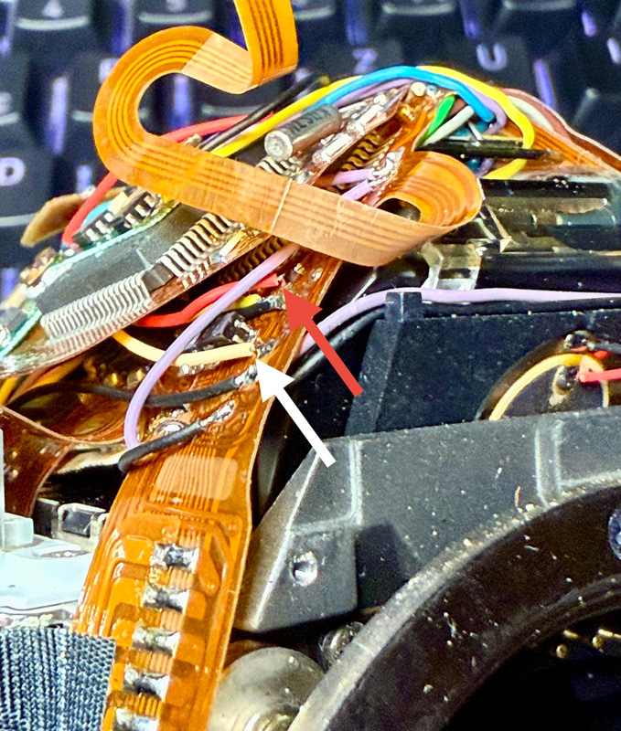

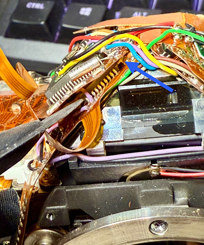

Wiring to shutter block
If the cable is crushed or the solder connection is poor, too little current flows to the magnet's coil. This current must be large enough to create a sufficiently strong magnetic field to cancel out the magnetic field of the permanent magnet holding the armature. This triggers the corresponding shutter curtain. So the magnet acts as an electrical switch.
For this error to happen, the cable would have to have been damaged during production.
Or the camera was opened at some point, damaging the cable in the process. In that case, the camera would not have exposed correctly from the start.
After speaking with the previous owner, I have ruled out the second possibility. I have also ruled out a faulty solder joint. It either works straight away or it doesn't work at all.

1st-curtain magnet SL1, open or dirty interface
If the contact surfaces of the armature and magnet become dirty, there may be a slight delay when the shutter is released because the contact surfaces stick together. This has an increasing impact on short shutter speeds, as a delay here has a greater proportional impact than for longer shutter speeds.
If the delay is, for example, 1 millisecond, the proportion is greater at 10 ms than at 1000 ms (= 1 second).
In practical terms, this means that the two shutter curtains that form the slit for exposure are not moving exactly at the intended interval.
I consider this to be the most likely error mode, as the contact surfaces of the magnets can become contaminated over decades, for example by minimal evaporation of lubricants in the camera. Cleaning should correct this.
However, if the magnets have changed their properties over time, they are defective.

Disassembly - removal of the covers
I start by removing the covers to get to the connectors of the shutter magnets to check them.
Larry Lyells provides detailed instructions in the SPT Journal.
After removing the battery and the battery cover, I unscrew the bottom plate, 8 screws.
Removing the end plate with back cover latch, 2 screws.
Front cover, 2 screws.
AEL cover, 1 screw.
Grip rubber stopper on the bottom of the handle, 1 screw.
Three screws secure the top cover.
One of them is hidden above the handle accessible via an opening.
To remove it, you'll need a 1.5 mm hex driver with sufficient length.
I had to order it separately from Amazon.
The hotshoe in the top cover is directly connected to the circuit board.
Desolder the black cable and ...
... the board.
The rubber grip cover can't be removed because it's glued on and breaks when you try to remove it. The plastic has become brittle over the decades.
I have to peel off the rubber grip cover piece by piece.
The double-sided adhesive tape underneath can be scraped off.
Soaking with isopropyl alcohol helps.
The handle is clean so far. The fine work will come later, once the shutter has been repaired.
I don't plan on replacing the rubber grip cover. The handle doesn't look bad as it is, and the plastic is sturdy.

On the catwalk.
A lot of plastic, everything a bit less premium than on the 7000 AF, but I wouldn't say the quality is any worse.
The construction is sturdy and functional.
I have the first version of the circuit board, recognizable by the green circuit boards attached. This should also allow me to set the 1/4000 second shutter speed using two trim pots.
Good news.
Tomorrow I'll take a look at the terminals for the shutter magnets and IC4, which I hope to find without further disassembly.
Then I'll check the solder terminals on IC4 and try to measure the magnets to get a better idea of the problem. If the magnets resp. SL1 for the front shutter curtain (opener) are fine, it can only be a matter of dirt on their contact surfaces.
To check and fix that, I'll have to remove the mirror box.
So, I still have some work ahead of me 🙃
Stay tuned!
Here's the connection for the white wire that goes to the shutter.
As far as I can see, there's no damage here, and the solder joint also appears clean.
However, most of the cable leading to the shutter isn't visible.
I'll still resolder it.
IC4
I will use the oscilloscope to measure the signal at the white wire terminal, high or low, as soon as the trigger (SW2) is pressed.
If IC4 is defective, the 7000i will go to the spare parts stock.
But I don't think so. Other functions would also no longer work.
Here's the position of IC4; the blue arrow points approximately to pin 23.
I might re-solder here as well, although I don't think it's necessary. Otherwise, the camera would never have produced properly exposed images; I don't think the solder joint has changed since production.
Unlike the white cable, which is flexible, which could potentially affect the solder joint. Although I don't think that's realistic either.
The two connecting wires of SL1, white and red.
They lead to the solenoid coil, which releases its armature as soon as current is interrupted.
If the coil winding is broken, no current can flow, and consequently the armature won't hold. If it is stuck due to contamination by dirt, it does not release.
If it releases only with a delay, this affects the shutter speed. The armature is then not fast enough for the short shutter speeds intervals because it is held in place by contamination.
I believe this is the cause of the problem.
I can test the coil winding with a multimeter (resistance measurement).
To do this, I unsolder the two wires and measure the coil's resistance. According to Larry, it should be 146 ohms.
If the coil winding is broken, it has a high resistance; the multimeter displays the highest possible resistance value.
I can only determine if it's dirty by inspecting it and fixing it on-site. To do this, the shutter must be accessible, which is the case after removing the mirror box.
As I said, these are all assumptions, supported by the information in the SPT Journal. Anyway, how the magnets are actually wired is irrelevant. There's nothing I can do other than clean them.
