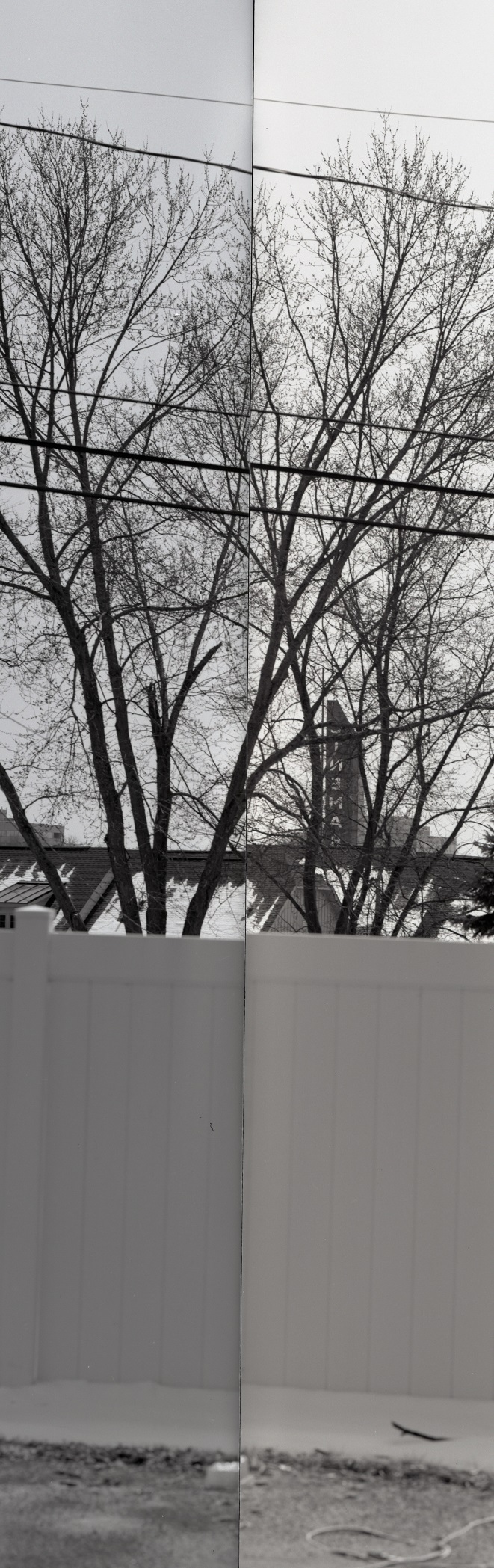

Nice post. Great to see justification to follow the recommended amount of 250 ml Perceptol.
Are you saying that neither negative has the correct amount of stock but the one using 125ml is better but still not up to the standard you'd expect from 250. Neither neg was developed with 250ml of stock from the notation and I had always thought
that the "conservatives" were arguing that anything less than 250ml of stock was sub optimal.
It may be my inexperienced eyes but as a negative I can see little difference between 60 and 125ml in the two top halves . Are there 4 negatives shown here? The bottom two halves seem different from the top two and yes the bottom right does appear to have what will be lighter highlights in the sky and what appears to be the same range of hills(?) but how will this turn out as a print. With VC paper will the difference be noticeable?
Thanks

@pentaxuser - I guess only one sheet of 8x10 is developed (actually half of it) which needs less stock?
@bvy - IDK what happened here. The recommended development time is applied (I guess at EI 100) which isn't shortened for rotary agitation, but there is still very little contrast. Perhaps due to flat lighting? However, the right side looks even flatter, which is the opposite what you expect. The right side also looks fuzzy, which is conform the notion that a solvent developer gives less sharp results, but to me this is quite extreme for 8x10.
Thanks
pentaxuser
I took one image on a sheet of 8x10 film. In the darkroom, I used a paper cutter and cut it in half -- two 4x10 half sheets of film. The recommended minimum amount of stock Perceptol is 250ml per 8x10 sheet, which equates to 125ml per 4x10 sheet. I processed one half sheet (right side) using the minimum recommended amount (125ml stock + 125ml water), and the other half sheet (left) using half the minimum recommended amount (62.5ml stock + 62.5ml water).
I exposed the film at EI 50 -- 1/25 at f/22 (metered EV15 at ISO100). The camera was focused at infinity so no bellows compensation was applied. Ilford's recommended time for Delta 100 in Perceptol 1+1 at EI50 is 13:00. I reduced development time by 15% to account for the constant agitation (11:00). Yes, the image is a little soft. Could be camera shake, but more likely it's the focus -- the buildings in the far distance appear relatively sharp. I'm including an inverted transparency scan of a portion of the image. (The scan above is reflective.)
I do have to admit I was a little careless with temperature. It was around 65F in my workspace, and I wanted to process at 68F to eliminate a third variable. I used my Paterson color thermometer and set the temperature to 69F at the start of each development to allow for drift. What I didn't take into account was (I guess) thermal mass. I took another temperature reading at the end -- the left side (125ml TOTAL solution) measured 66F; the right side (250ml) 67.5F. So on average, there's about a three-quarter of a degree difference between the two developments, the left side being slightly cooler. So I guess we can only speculate if the difference in density is due to that fractional degree difference or the amount of stock solution. Even so, the differences is not so egregious that I wouldn't consider economizing a little if necessary.

It's plausible that Ilford has a built-in margin in it's numbers, but the original question was if one can use 70 ml of stock as a minimum instead of 250 ml for 80 in^2. That's less than in bvy's experiment. The problem is that if you nibble off small quantities of developer you will also see small effects, which are hard to judge, but you can bet that it harmfully influences the result.
Until now I have done a limited number of HP5+ in stock Perceptol instead of ID-11, but I see only gradual differences depending on contrast of the scene and developing time. Until now my conclusion is that the effect of Perceptol on grain and perhaps other properties is also quite subtle (contrary what some may suggest). Which makes it difficult to design a good test.

Thanks the print makes it clear what I had erroneously thought might be 4 negs is in fact a fence and the "hills"in the lower half are the bottom of the fence. If the fence is closer to the lighter colour as in the stock 125 ml then it would seem that highlights are not as bright as they should be but allowing for what you have said as to the development factor differences plus the benefit of VC paper I do wonder what the practical differences might be in a print.
60ml was what I used in a 250ml tank at 1+3 for a 135 film but Ilford did tell me that 70ml was the minimum, based on a 280ml tank. Maybe 280ml was a standard size when llford came up with its 70ml but most would have used or still use 300ml so that's 75ml - 15 ml more than my 60ml - which might make a safety factor kind of difference.
In your case that's still 40 sq inches of negative for 125ml or 60ml economy style. In a 36 frame 135 film I'd assume the developer is in fact developing say the equivalent of 40 frames or 60 sq inches so even economy style it should be 60ml + 50% of 60 ml so 90 ml stock for my 135. If Ilford stated that 70ml stock was the minimum and my prints looked OK ( to me at least) then it does suggest that there is considerable leeway in what is minimum stock.
I think I recall some of the negs on that particular 60ml stock at 1+3, I must try and find them again plus the prints and re-examine them
