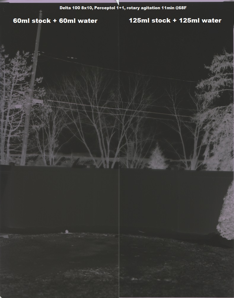

Draw your own conclusions. Right side is the recommended minimum amount of stock for 40in2 of film. The left side is half the recommended amount. Both half sheets were scanned in the same pass with no adjustments.
Nice post. Great to see justification to follow the recommended amount of 250 ml Perceptol.
