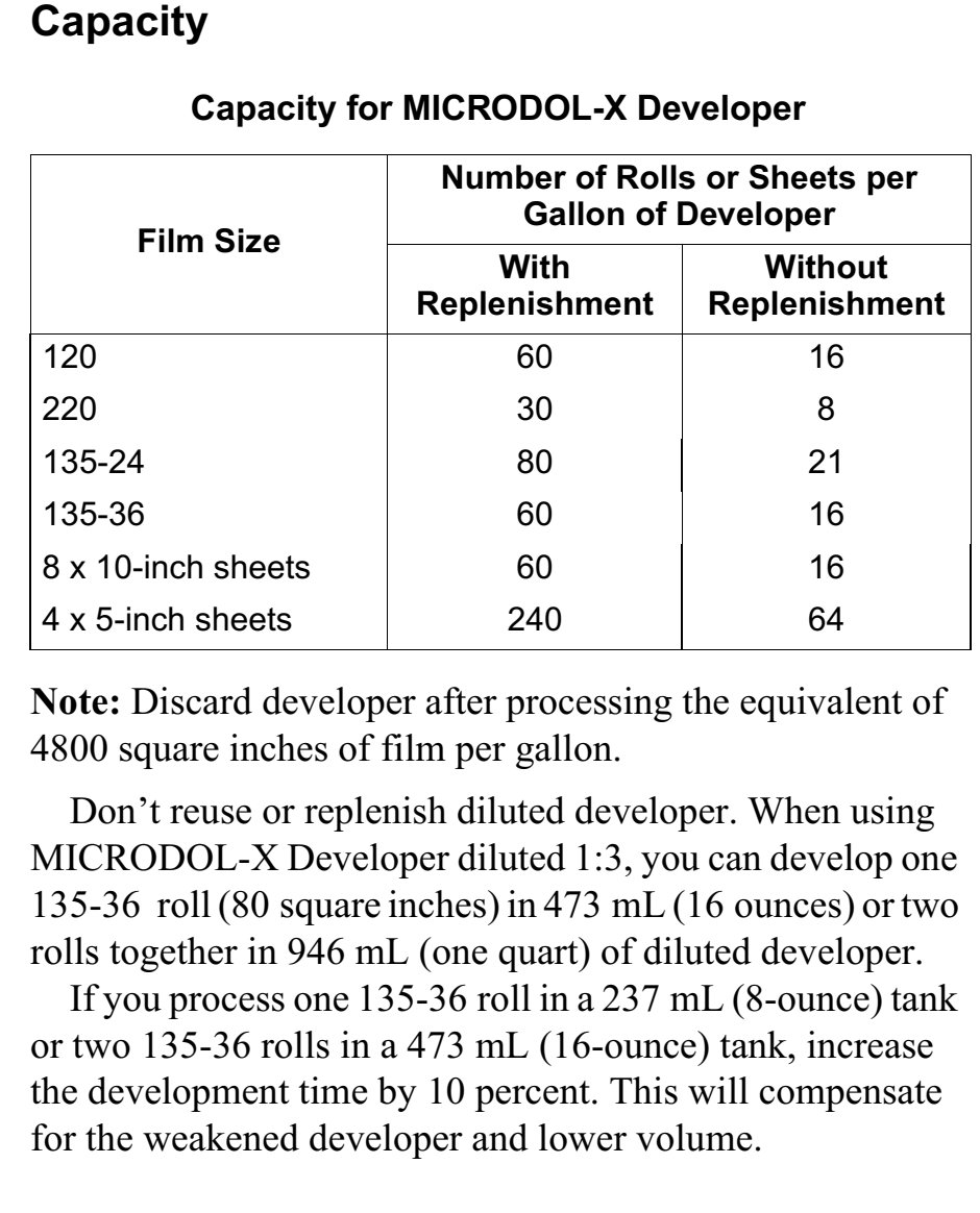

mnemosyne
Jan 19, 2011
759
Europe
OK, now i am super confused:
If i have a 1:1 full strength solution of Perceotol 1 Liter, how many films can i develop? Also, does it have to be one big development orgy or can i continue developing another day as well (until the limit is reached)?
Maybe this helps. It is taken from the Microdol X tech sheet. AFAIK Perceptol is very similar to Microdol-X

70 ml of what? 1+0 solution? As you already know, i need 290ml of developer minimum for a roll.
hacked - sepiareverb
Feb 17, 2007
1,103
St J Vermont
Well this will keep the thread on the new posts list.
The question is what Ilford recommends around whether one can develop a single roll of 135-36 (8x10 equivalent) at 1:1 in a single roll tank ( which would use 150mL of stock solution), and whether one can develop a single roll at 1:3 in a single roll tank ( which would use 75 mL of stock solution).
We are wondering about the official line on the minimum volume of stock developer needed in the tank for each roll when Perceptol is used in diluted form.
In reading over the data sheet again, I don’t see anywhere that Ilford lists a minimum quantity of developer per roll. The Microdol-X tech sheet posted above indicates that 150mL is the minimum volume for a single roll as a single 35mm roll developed at 1:3 dilution should be run in a 500mL tank, which was correct in my experience. I have found Microdol-X and Perceptol interchangeable in my darkroom, when I made the change to Perceptol no developing times changed at all. I used to run Plus-X in Microdol-X at 1:3, but since moving to Perceptol and UN-54 I have found 1:1 gives better overall results, and not because I used a tank that was too small with 1:3 dilutions. I am actually about to do some experimenting with Perceptol at 1:3 and FP4 since recently printing a couple of old Plus-X in Microdol-X 1:3 negatives.
