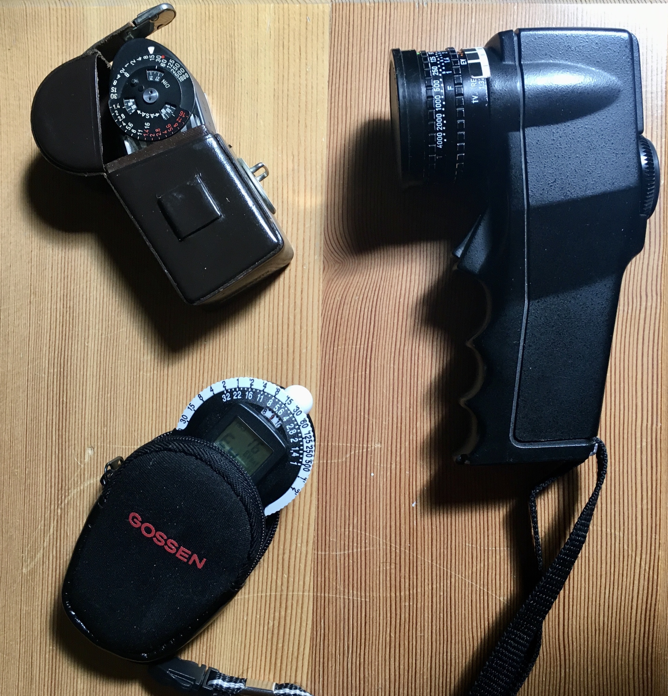

My working meters. In order of use... 1- Pentax, 2- Digisix. 3 - Leicameter
