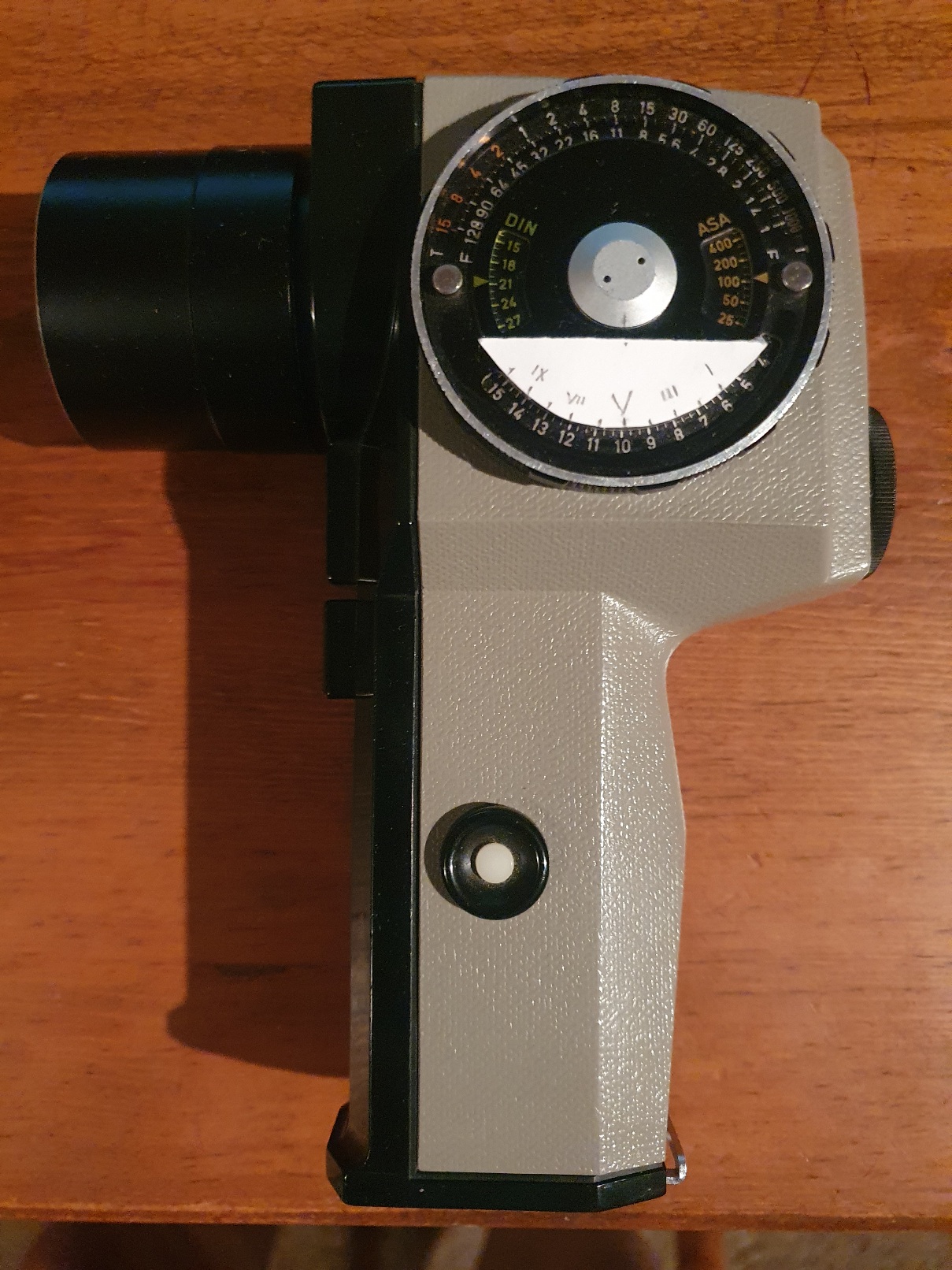

I have a Pentax Spotmeter complete with a zone scale and I've never used it (too big). I have a new KEKS accessory shoe meter and I've never used it (too small). I have various Leica meters that are unusable because of failure, and likewise Weston Meters. A Gossen DigiPro F rarely gets used (annoying). But the jewels of my collection are the humble Sekonic L-308B and L-208. The batteries last forever, they are easy to stuff in a bag, they are light, and just feel bombproof. I'd be very upset if my L-308B was damaged, lost, or it failed because it's been my most used meter with LF, MF, and 35mm for over 23 years.

I've been considering getting one. Love the simplicity of it. One thing I don't understand is your "Zone modified" comment. People say this often about this meter, but I fail to understand what does it mean? It's a simple EV scale... ready to be used with the zone system. What is there to modify?
The Pentax Spot Digital was/is notorious for the inaccuracy of its respond to colors. Fred Picker, Zone VI Studios, was a photographer and photo teacher who would buy up spot meters, tear them down and replace the internal filters factory installed to adjust the color response of the meter, recalibrate for his filter set (generally loosing a one to two stops of working sensitivity), reassemble, then add a Zone System coded exposure scale. He then resold them with a leather holster and a $150-200 price markup. Whether they were worth the modifications was a running industry debate at the time. He did the same thing with the much more pedestrian Soligor Digital meter as well. The objection of shops to repair these meters today is probably just that they have no "factory" technical information to reference for adjustment standards, and they just are not worth the time it would cost to feel your way though the circuit settings and calibrate one of these things for a one-off job.
chriscrawfordphoto
Mar 12, 2007
1,893
Fort Wayne, Indiana, USA
A couple years ago, I did an extensive set of tests comparing the regular Pentax Digital Spotmeter, the Zone VI Pentax Digital, the spotmeter in the Sekonic L-758DR, and the Gossen Ultra Spot 2. I tested their color sensitivity, infrared sensitivity, and flare.
Color sensitivity of the regular Pentax and the Sekonic were almost identical. The Zone VI Pentax was 1/3 stop less sensitive to red and 1/3 stop more sensitive to blue compared to the unmodified Pentax and the Sekonic. I think the Zone VI is best for older B&W films like Tri-x and FP-4, while Sekonic and the standard Pentax are better for color photography and Kodak's Tmax films.
