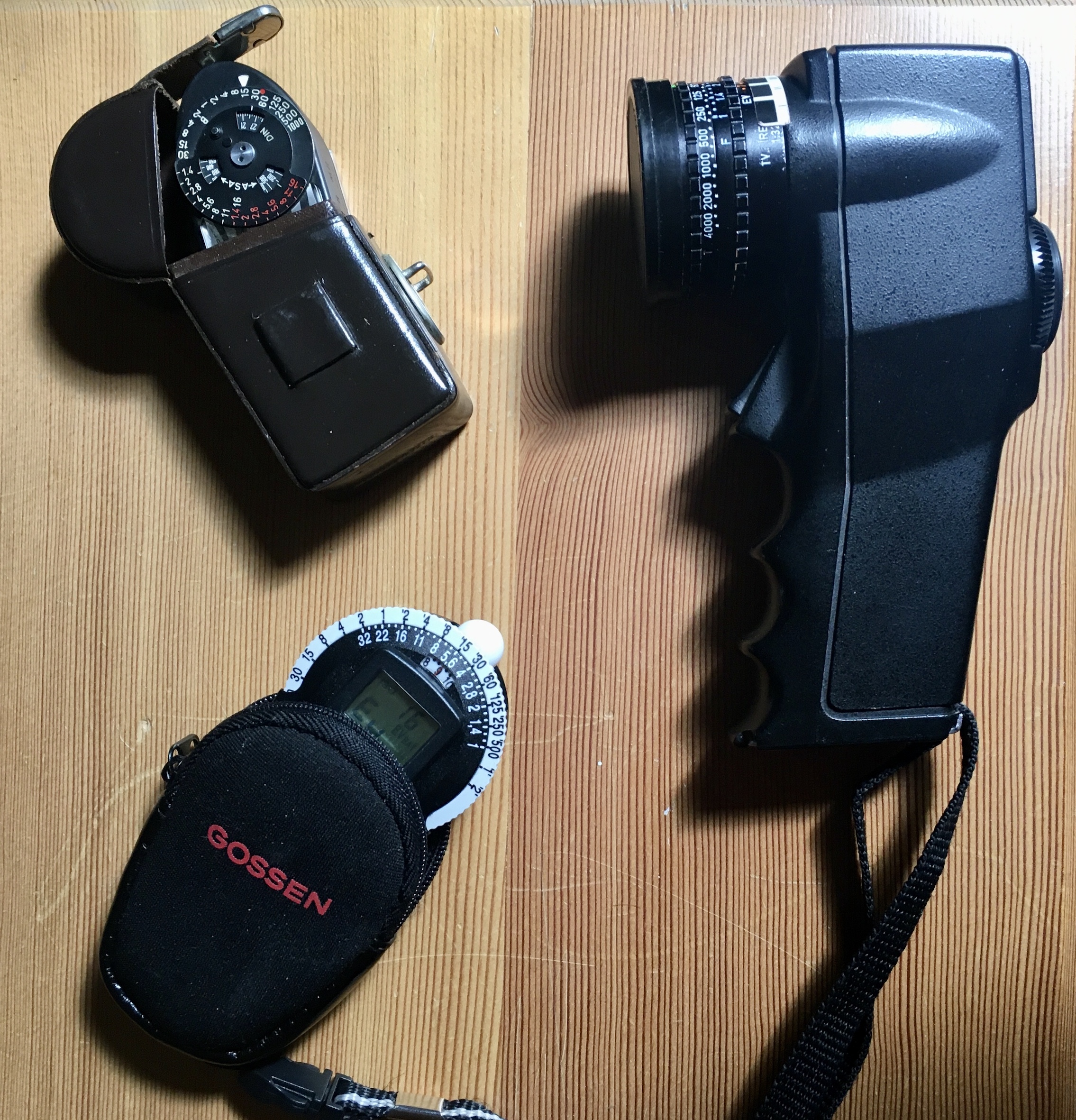

Here is an image of some of my meters. Not included is the Soligar spot meter, a few more Westons, a Vivitar and a Bower, the spot meter is the boot of my SUV with some LF gear. The Weston V is shown with the inveracone, the GE which I do not know the model number is show with the cover off. sitting above the main body of the meter. Of all these I perfer the Weston V, it can be used with one hand. The Gossen although quite accurate needs to 2 hands to get the LEDs just right. In the bottom right are a Sekonic and Norwood Directors. My understanding is that Sekonic bought Norwood and moved the factory to Japan? Although the dome is quite yellow from age it is still spot on.

This thread reminds me of the old saying that if you have a watch, you know what time it is. If you have two watches, you never know what time it is.

All of the metes I posted are within a stop of the Gossen which is dead on with mu Minolta 9 film and Sony A900 SLR with 50mm lens and in average mode. I did find a couple of Weston's that have dead cells, I just put in a box to take the recycling center at the Goodwill. I use the GE with my Argus 3, the Gossen and Weston V and VI with various MF gear. I hate to admit, but I do use my Pentax K2000 DSLR as a meter as well. In spot mode with a 28 to 90 zoom it reads just as well my spot meter, one of the reasons I have spent the money to replace the Soligar.
I used a Minolta Autometer IIIf for years - still have it. But lately I've used my Olympus E-PL1 micro 4/3 camera as a meter and director's viewfinder.
Would you describe yourself as a belt-and-braces kind of guy? I mean, that’s a LOT of light meters! 😉

Not really, just gathered up over 50s years. The only meter I bought for a particular purpose was the Soligar zoom, for Zone, the others were given to me, found at garage and estate sales for a few dollars, others came with camera I bought. As they are not worth much never sold any.
