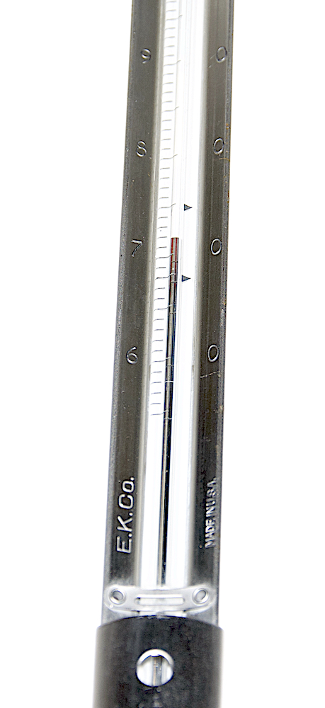

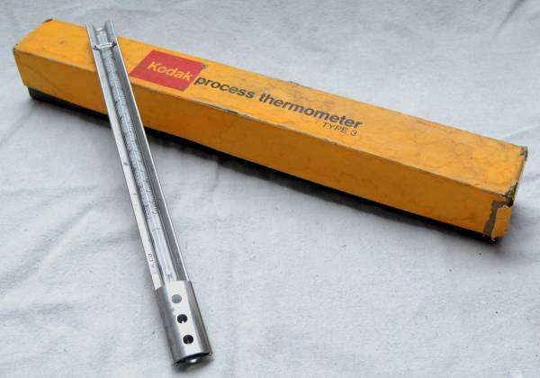

I have a number of thermometers in my darkroom for comparison:
Kodak Process Thermometer type 3 (like pictured) features a metal support and protective casing for the bulb. Main advantage, other than durability, is the wide and very easy to read mercury column. Disadvantage is that mine reads in "F" so readings in my darkroom need to be converted.
I use this as my 'standard' by which other thermometers are compared. This is a beautiful item from the heyday of Kodak's involvement in film.
I'd recommend this one as they are still available on the internet and, as previously discussed, they can last many many years.
You said it reads in F? I can see in the picture there is the C scale on the left side? You can see clearly the C scale on the picture of mine.
“…like pictured” except mine reads in “F.”
Here is a picture of my actual thermometer. This is super easy to read, even under safelight. Even though it does not have the "C" scale, it has large indicators right at 20C and 24C!

Get the real deal and be done with it : a Kodak Process Thermometer. These were individually certified, just like all true scientific lab thermometers. Even if you use cheaper thermometers or even an electronic one, you should have one of these on hand as a reference. But it's the only option I now use.

Kodak Type 3 Process Thermometers were around $250 new, which is right about what someone would pay for a certified scientific thermometer similarly clad today. But they turn up form time to time for considerably less today, either used, or never sold to begin with. Certifying involves an actual test of that very item, not just a "guarantee", which might not mean anything more than BS marketing. And being metal clad, these are quite durable.
RA4 is fairly tolerant. I try to keep within a couple degree plus or minus of 30 deg C. More than 3 deg plus or minus, and you risk a little color shift. But there are other processes like making matched color separations negative where it is helpful to be way more precise.
What is most important, however, is consistency. Any given thermometer has to read the same each time. And just like with light meters, it's helpful to have a standardized reference on hand to check things. But I don't use secondary thermometers at all, just the trustworthy Kodak Process one itself. Even my electronic thermometers just sit in a drawer unused.

My Kodak Process Thermometer Type 3 doesn't have a warranty. It does said the Celsius scale is accurate to +/- 0.125 degree at 15,20,25,30 and 40C. and to+/- 0.25 degreee over the rest of the scale.
