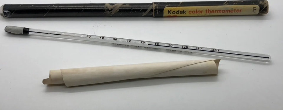

Just got this for $19 shipping included.
