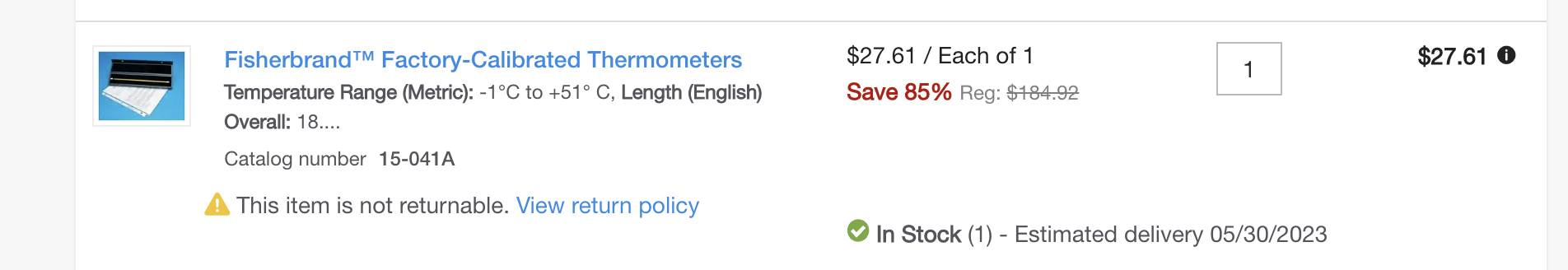

Fisher is having a blow out sale on calibrated mercury thermometers. This one is full immersion, so it is used to test your other thermometers.
