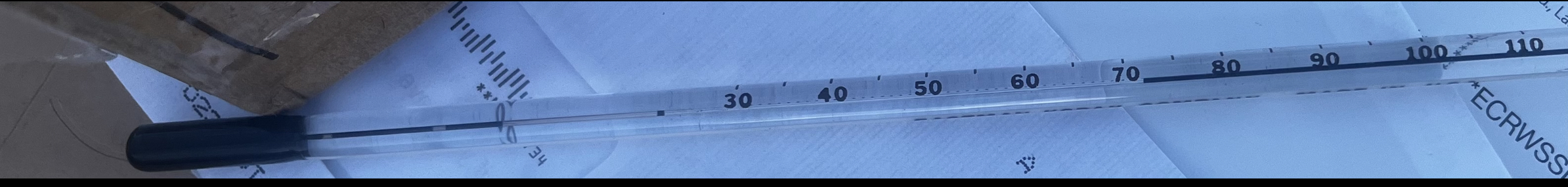

First one came like that. I wonder if freezer would make it join back

Hold the top end and shake it down with flicks of the wrist. One shake and check to see if there is movement. Repeat until it will not improve. Then heat gently and see if it links up but not real hot. The later try cooling down and see if that helps.

There's a near-vacuum both between the main column and the detached beads, and above the column or beads -- so the only way cooling would help is if you cool the bulb and heat the top of the thermometer. Usually heating the bulb to or slightly past the top of the scale is the way to go.
