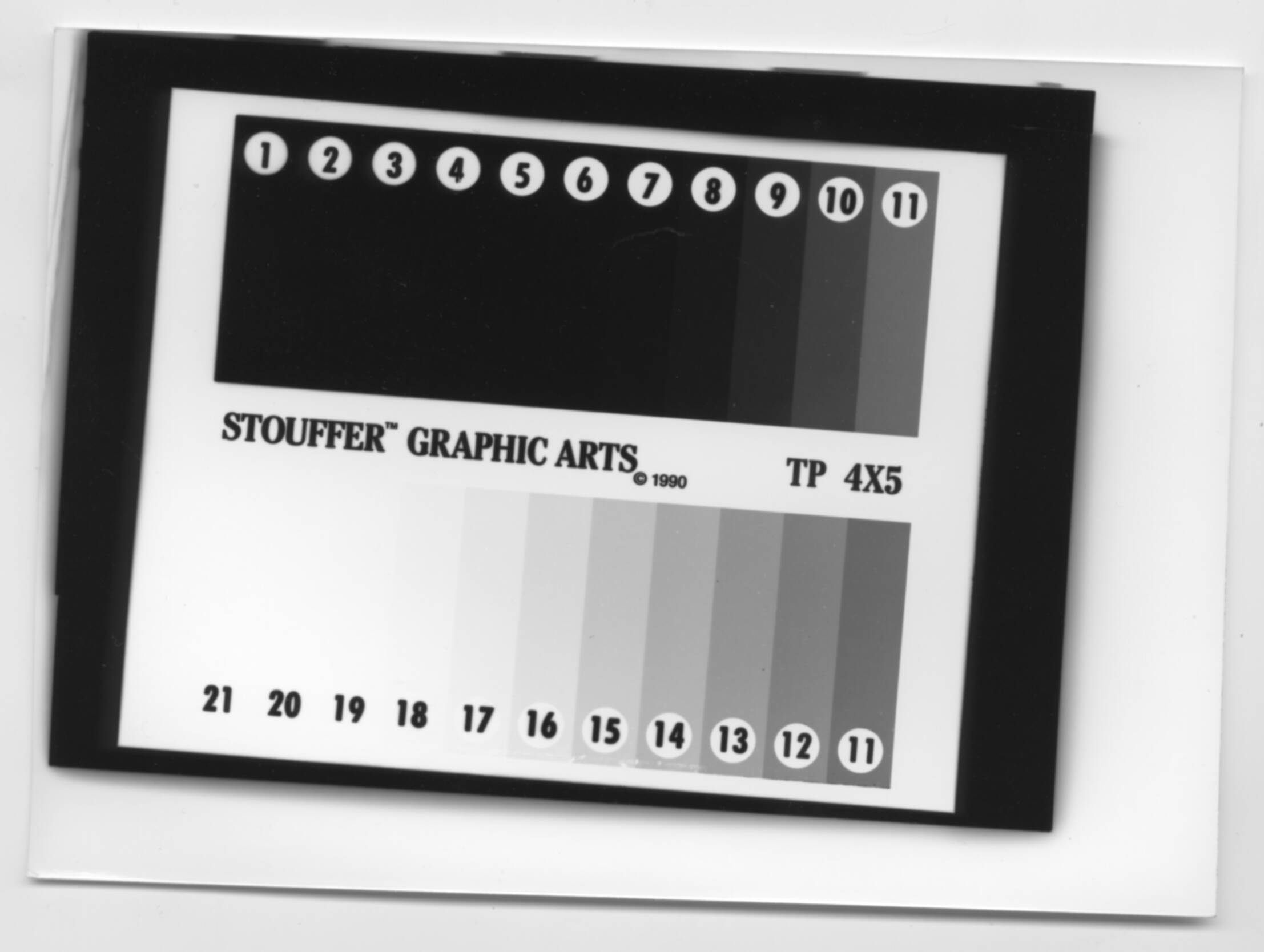

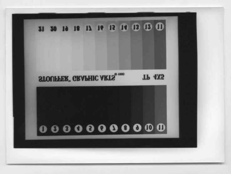

My biggest concern about having a lens between resolution target and film test clip is flare. Look at the two attached images of a Stouffer wedge printed onto B&W paper, one was contact printed, the other one through a Schneider Kreuznach lens. The enlarger was set up in such a way that both prints received the identical amount of light in the transparent section of the wedge.

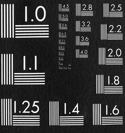

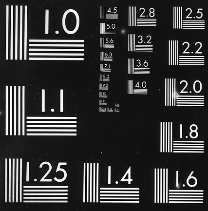

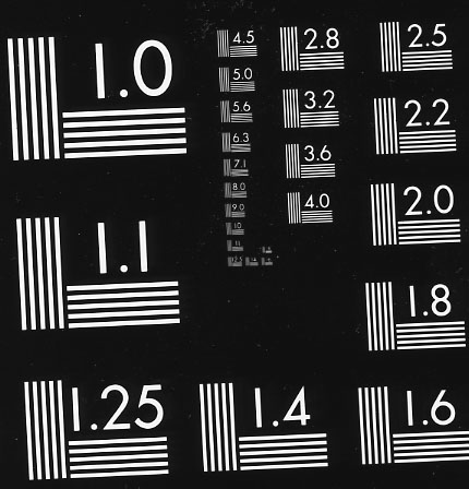

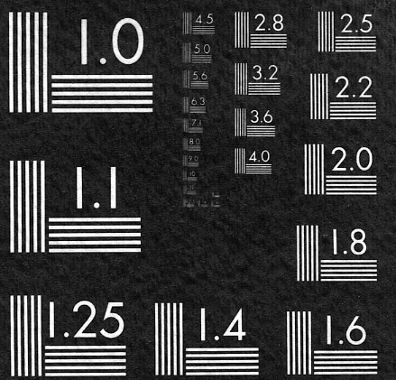

Here are 4 examples of contact prints.
1. Handcoated on baryta
2. Ilford MC check
3. Handcoated on Strathmore smooth
4. Handcoated on Strathmore watercolor
This is a negative chart only test and shows how surface affects resolution of a high contrast chart being contact printed using a heavy glass pressure plate.

Ron, is there a chance you could post higher resolution images? At the moment resolution seems to be limited by pixelation, not by the actual medium.
Look in the book for higher resolution neg and pos images. I can re-scan, but the first scans (that I liked) would not upload due to size.

Flare is obviously not an issue if you start with a 50:1 contrast ratio, like Mr. Fleischer claims he does. It turns into a huge issue if you start with 1000:1 contrast ratio, as exemplified by my test prints, and as I would likely encounter if I superimpose a Stouffer wedge with a repeated resolution test pattern.
