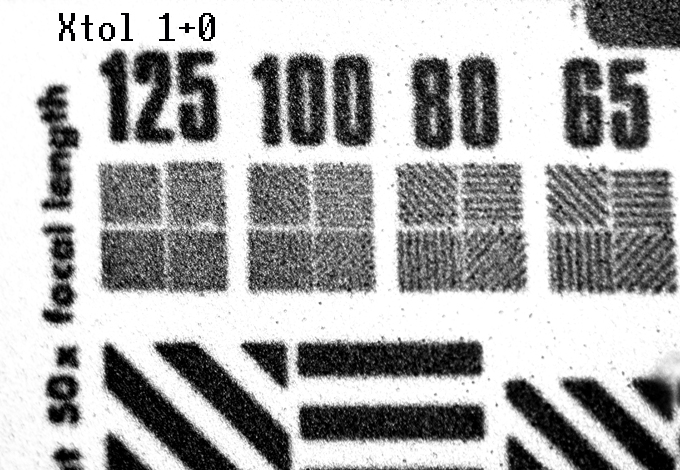

I have an older chart which, photographed from the correct distance, gives a direct reading in lppm.I read the attached as 80-90 lppm.
I photograph from various distances, I just measure the size of the chart on the negative
