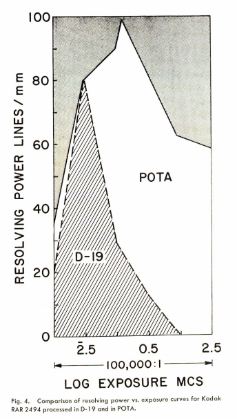

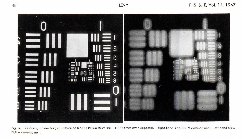

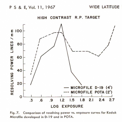

Since you won't allow me to ask whether you by any chance meant heat transfer film, I would like to dig up some older topic in this thread, which is resolution vs. exposure. From my very limited experiments I sort of knew that excessive exposure causes blooming effects, but now I finally got around to reading Marilyn Levy's famous POTA article (Photographic Science and Engineering, vol. 11, pp. 46), and sure enough, Levy claims a strong relationship between exposure and contrast.
Attached to this posting are three graphs which compare exposure vs. resolution for POTA and D-19, the latter one a high contrast MQ developer, not too much different from D-76 and the like. With increasing exposure resolution builds up at first, only to go down again as film goes into saturation.
Graph labelled "Levy Resolving Power vs. Exposure.png" depicts the resolution of Kodak RAR 2494 recording film exposed with variable light intensity.
Graph labelled "Levy Resolution vs. 1_1000 Exposure.png" shows two film areas contact printed through USAF 1951 resolution target at normal exposure and at 1000 times normal exposure.
Graph labelled "Levy Resolution vs. Exposure High Contrast Target.png" shows the resolution of Kodak Microfile film exposed with variable light intensity. Different film from first graph yields very similar results.

Alan, I am not after the sharpest developer. A good general purpose developer, as far as I am concerned, is a developer which gives good overall results and which can be easily modified to tilt its balance in one specific direction (speed, sharpness, grain).
If you look at Xtol, people do this "tilting the balance" by changing dilution from stock (fine grain) to higher dilutions (speed & sharpness). Add some lye and you'd probably gain a tiny bit of extra speed at the expense of grain and fog.
My first film tests were done with real image matter, and they were inconclusive at best, and sometimes outright misleading. This is why I ordered that Lasersoft resolution target now, hopefully I will get more meaningful feedback whether certain modifications have an effect and to which extent.
