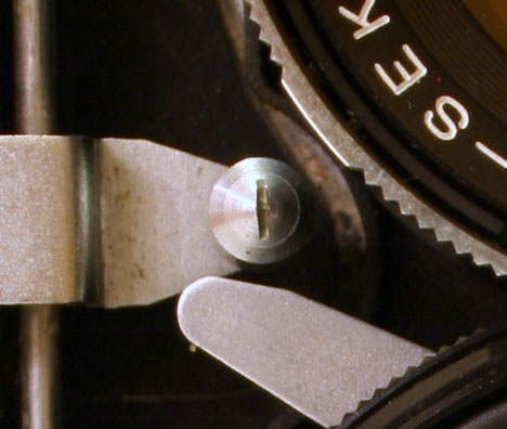

hi Paul,
it doesn't seems like that the arm is bent. when i press the shutter mechanism after cocking the shutter with crank it goes 75% down on first try but not down enough to trigger the shutter. After first try then it won't go down at all. i have to manually fire the shutter lever on the lens, cock the shutter from the crank and move to next frame and repeat the steps.
thanks
The lock after the first press is the multi-exposure prevention. That is normal. There is nothing on the shutter release slide to change. Make sure the nub for the release is present as in the attached image.
Does the shutter release travel normally when the lens is not attached? You should be able to see the lock when looking at the inside left of where the lens mount is. There may be some debris in the way at the bottom of travel.
I get the idea that then lens may be what needs servicing and it's possible that, according to Graham Patterson, you have a very early 80mm that will not work on the C33.
