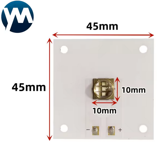

Related to DLP/projectors, On my DLP project I found an LED that is about 10X10mm square 50W. It works very well but I can't find it anymore. I have one spare and that's it. It was made by a company called YM in chine. I've found one other manufacturer that comes close:
The YM store:
Basically for my project I was looking for an LED with a lot of available power that could be focused on the surface of the DMM/DLP mirror. Any light outside that area is just wasted light.
The 27W module should be easier to cool:
The 50W module takes some know-how to get it to not burn up. Anyway, these modules are needed when the requirement is a point-like source of UV power. Although these are not point-like, you can add apertures or integration tubes/rods to homogenize their input. It is way easier to find COBs that have significant separation between emitters. Hopefully they continue pushing the boundaries to get us more power per unit area.
ww.aliexpress.com/item/3256807041983851.html
The window material is quartz. on the one I have the window is flat and I have to narrow it using a Fresnel, but they have since come up with these that have a lens already on the LED which is great.
The YM store:

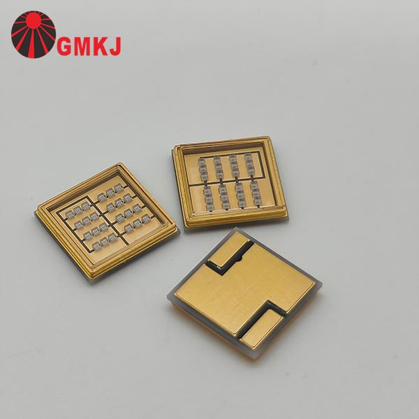

The company I got my UV LED modules from is called GMLEDs, it looks like they have a single 400-405nm LED module that can do 50W:
Seems like it just has a flat quartz top rather than a lens.
You could email them and ask if they have something like what you need, that's what I did and they were very responsive. Their website isn't easy to navigate so they might have things that aren't listed or are hard to find.
Very nice! Yeah the package is the right size for my optics.
The YM store:
