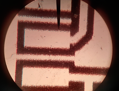

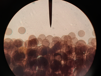

You bet; I was looking at an inkjet printed negative the other day through a microscope and it was an enlightening experience.
(It's PCB artwork, hence the 'line art')
Zoomed in on one of the edges:
The droplets are orders of magnitude larger than film grain. Alignment is also quite poor compared to film, but this will depend on the individual printer; I think mine isn't great in this department, but there will always be a little spread in the direction of the head travel, regardless. More importantly, note how translucent the droplets really are; density only builds where many droplets overlap. This means that 'resolution' in the real world becomes a very fuzzy concept indeed, as it depends strongly on what kind of contrast ratio (i.e. number of overlapping droplets) you're looking at.
