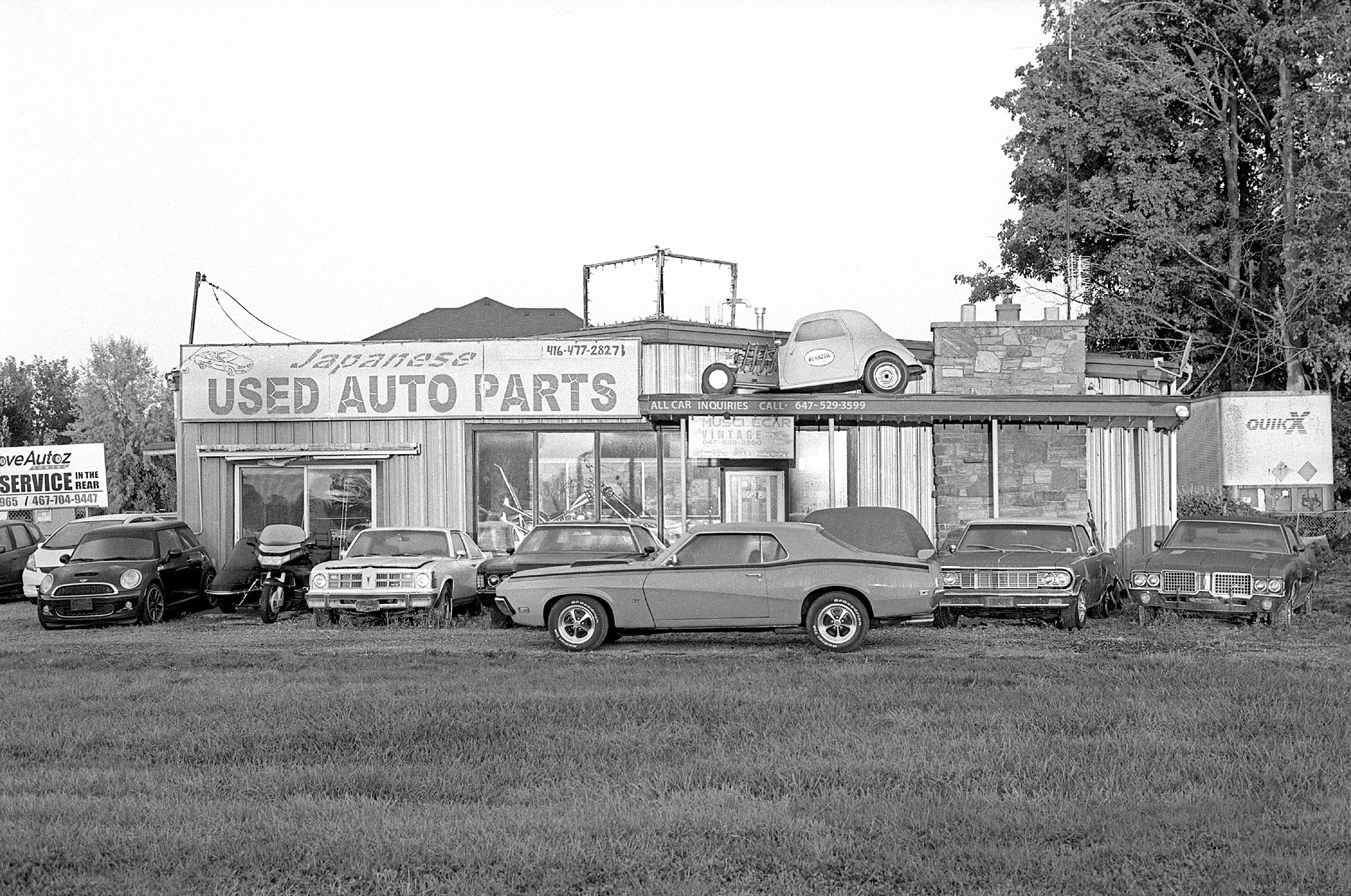

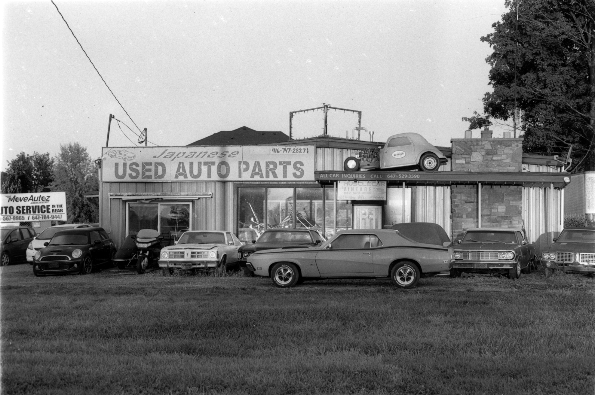

I started with the scanned negative named PNX2509_SDIV_3200dpi, and here's what I did to it:
I didn't crop it.
Darkened the image because it looked over/under exposed.
Straightened it by pulling down the lower right corner a bit. That made the horizon line perfectly level, (at least for the image I started with.)
Removed various scratches and dust specks from the scanning process of the original negative.
Fixed some dark patches either introduced during the developing process or shadows from the rising sun.
Removed a distracting highline wire from the top left area.
Cloned over other distracting elements such as some patches in the grass, etc.
Gave it some minor sharpening.
And I especialoly enjoyed the Mercury Cougar XR-7 positioned in front.
I didn't crop the image because of the way I work when I'm shooting. What I frame in the viewfinder is what I want in my final image to be, and I assume other people work that way as well. That's why I left the image uncropped because that's the way it was originally framed by Don_ih. I wanted to respect his vision.

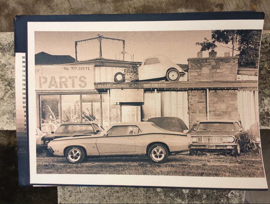

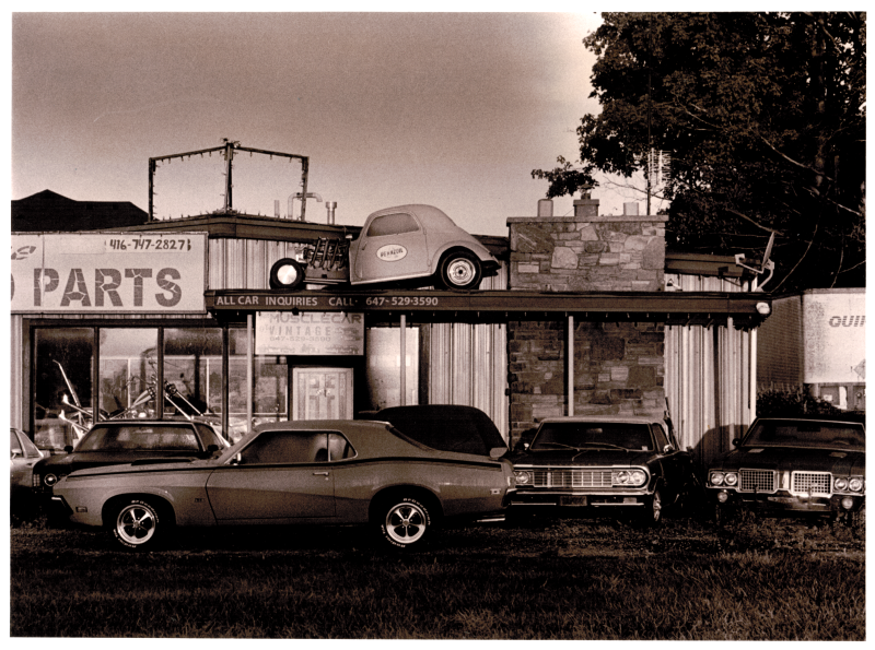

Scan from a darkroom print, on Ilford MGRC Satin, 18x24cm. Developper is Adox MCC, dilution 1:4.
The sign above the building: USED AUTO PARTS was the inspiration.
The print is multiple exposures on the same sheet of paper, the negative first under-exposed so that a ghost image of the slightly cropped negative formed the base for the rest.
That sheet was put in the paper safe while I got on with the next part of the printing process.
The head of the enlarger was raised and refocused before returning the sheet of pre-exposed paper.
It was swivelled 180°, so upside down relative to the first exposure.
The easel was then shifted around under the enlarger head, with areas dodged while exposing areas that interested me.
I wanted to fill the spaces that were empty, and move those vehicles around in space.
Four separate areas were exposed this way, et voilà le résultat.
This is a very simplified description of two separate days in the darkroom and of all the trial and error that went on!
Four prints were done this way, each one different, and unique.
None can be duplicated, at least in a darkroom.

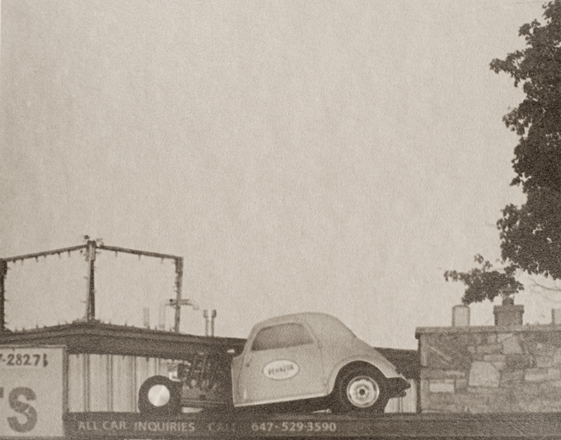

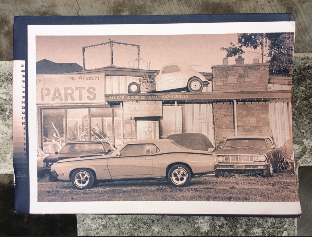

I went with a 18x24cm darkroom print, using old (and slightly fogged) Tura VC paper. The print was then bleached and selenium toned, and this combination has been giving me these very warm tones that I'm enjoying (and that I tried to replicate when I scanned the print)
The print was cropped from the original negative because I felt there was too much going on there - it wasn't easy to decide how to recenter the image. I struggled with the sky, which was burned in in this final version, but I still wasn't able to get it where I imagined it.
At some point I became really obsessed with the zone with extra density that goes down from the engine of the hot rod on the roof, but ended up ignoring it.

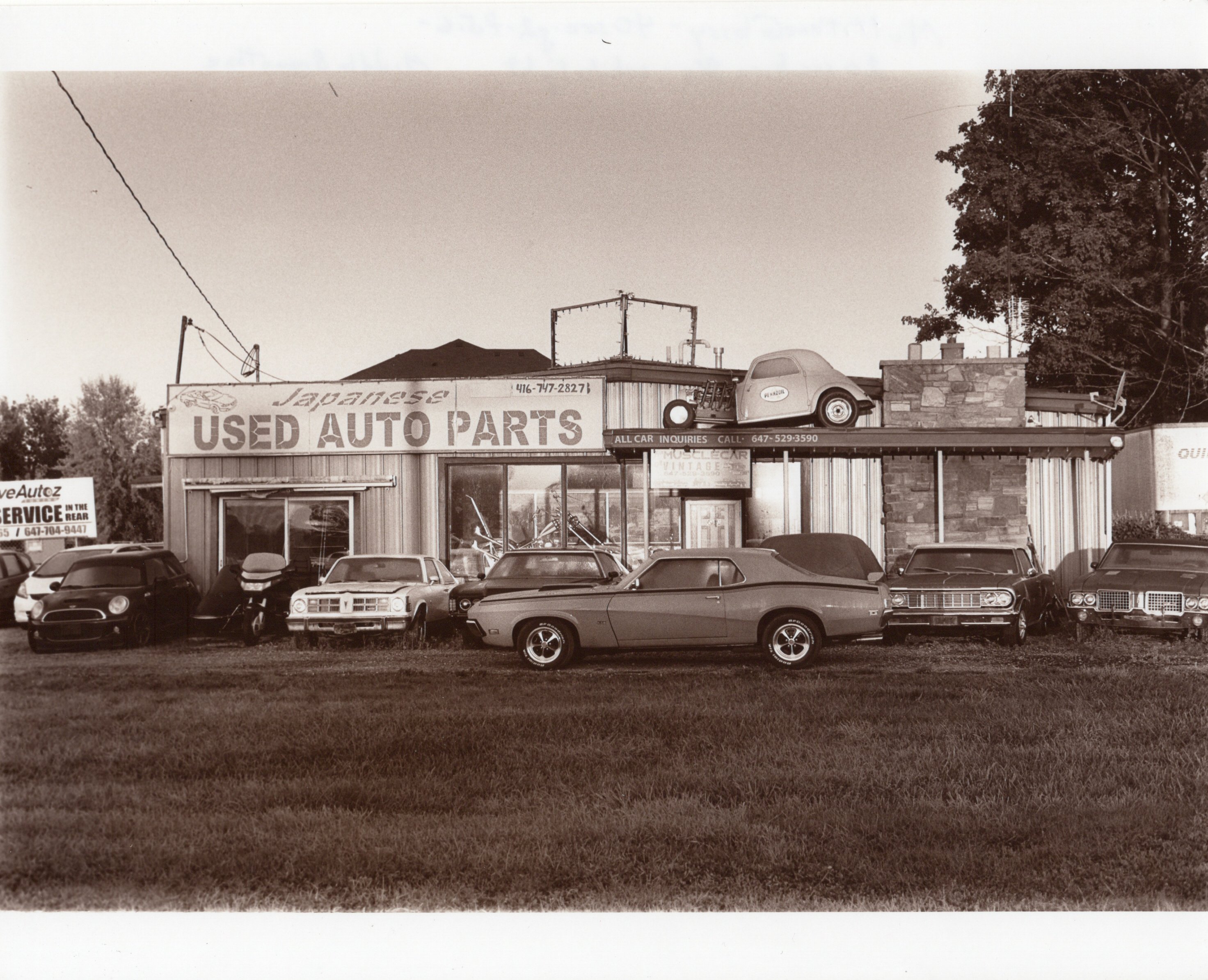

Here what I emailed Don, along with an attached image:
"Here is my print of your negative. This is the third try, all were very close. For this one I burned in the sky a little. I pretended that someone took this picture to show the business (like it was theirs), and just wanted a normal-looking picture of it.
I used Bromophen 1:2 on Ilford MGRC Deluxe glossy paper, with a #0 Ilford filter under the lens. My enlarger is an Omega DII, with the standard lamp housing, which has a frosted tungsten lamp. So it's more like a diffusion enlarger than a true condenser enlarger. The lens is an EL Nikkor 50 mm f2.8. The developer was a bit weak, but I don't think enough to matter."

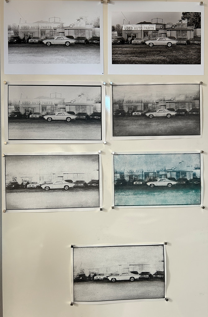

Some recording of my process. The top two are inkjet prints. The other 5 are bromoil prints. The one on the bottom is the one that made it.
