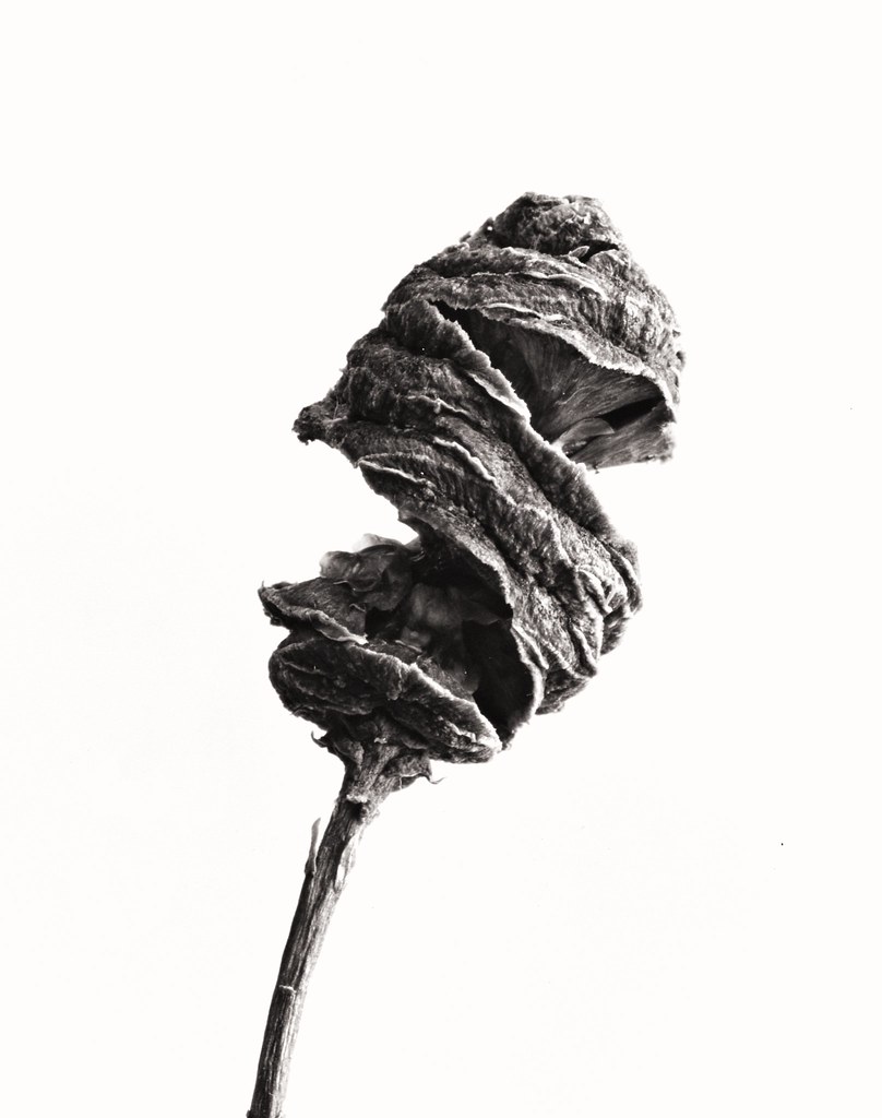

I try to make pictures in this way but I don´t use a 500mm lens in 1:1 because it needs an extension of 1000mm (40inch) Here I used a 320mm Rodenstock aplanat in 9x12cm size:
Karl Blossfeldt used the 9x12cm format, a little bit smaller than 4x5" (10x13cm)
All pictures from him were made in a 1:1 ratio with a 500mm aplanatic lens at f/36 (source: das deutsche Lichtbild, 1928)
