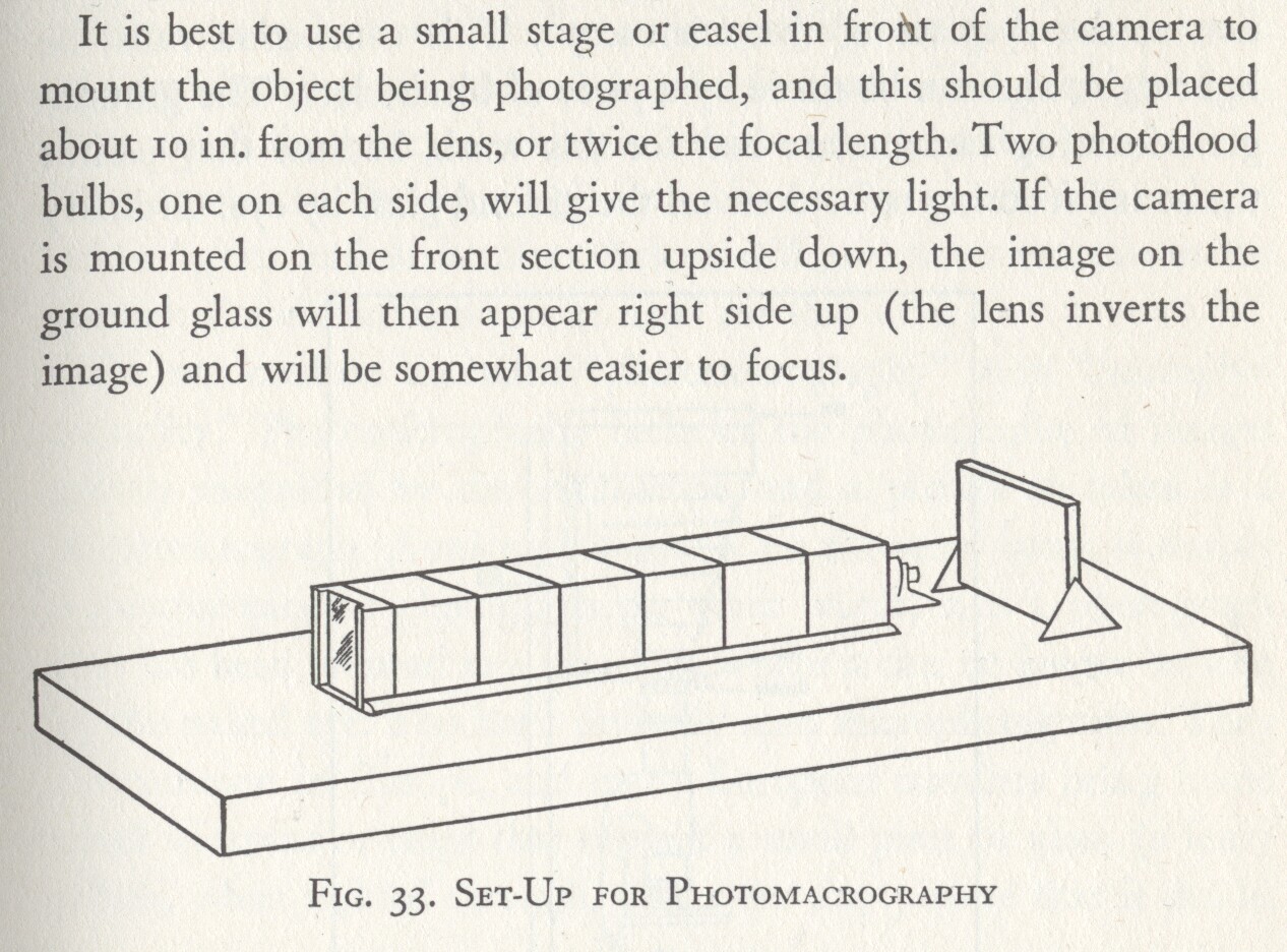

In his book, Complete Introduction to Photography, J. Harris Gable illustrates how to setup for Large Format Macrophotography
The part that really amazes me is where he suggests mounting the camera upside down will make the image on the ground glass right side up...
(We all know that won't work... If he had said something like "mount the subject upside down in front of the camera"... that would work to make the image on the ground glass right side up).

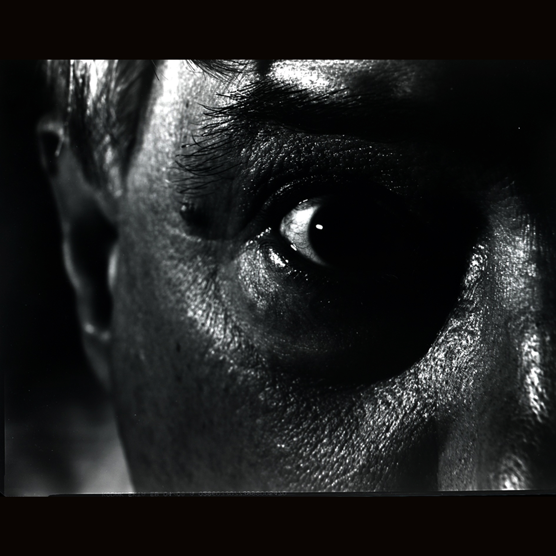

This is a self portrait of my left eye done with an 8x10 Kodak 2-D on Ektascan ultrasound film. Don't remember now, but thwe lens was probably a 210 Symmar convertible. Two Vivitar 283 strobes were within a foot of my face. The lens was close enough that I just reached out and tripped the shutter lever.
The image fills the 8x10 negative, so it is at least 1:1, maybe larger.
No close-up screw-in lenses(+ diopter) were used, just extension. Looking at the image again, the DOF might be an inch?

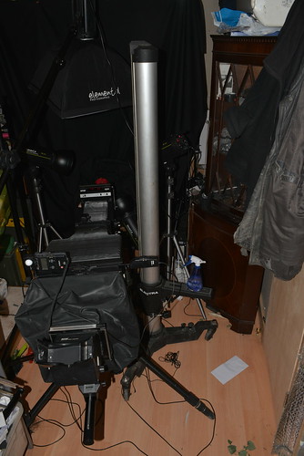

I have the toys but not really the space to do this but give it a go a few times of year for kicks really. Things get a lot easier when you buy yourself 2Kw of flash gear, and mostly you are probably always going into diffraction and a smaller format might be more realistic or yield better results.
For those that really need to know Provia 10x8 Sinar P 10x8 30 year edition but with P2 10x8 format set, 1M base rail and a couple of 18" extensions F32 and 1/30th using Sinar digital shutter.
