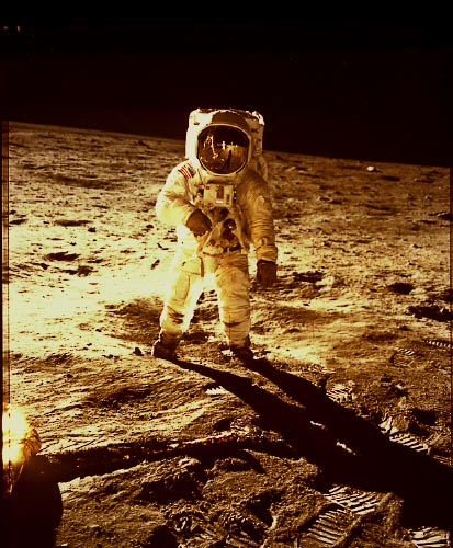

That would sound about right. I know all the Apollo missions used Ektachrome as far as im aware.
For Mercury, they used HS Ektachrome cross-processed in C22 and exposed at ISO 400. In the capsule, they used ECN. For Apollo, they used Ektachrome, but could not get good quality prints (what have I said before??) and sent the transparencies to EK for duping as negatives. The negatives ended up on my desk, and we used the first production run of Ektacolor 30 professional in the 3 step EKtaprint 3 process in a Calumet processor. I personally made 16x20s to send back, but was told, once they got the trannies back and the prints, that I could keep the negatives.
I still have them.
PE
They are right here!
