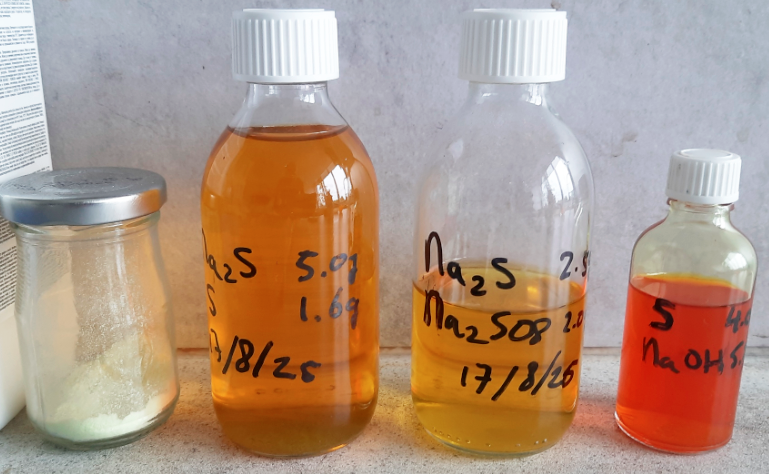

Not very diligently, but I did dunk one or two small lith test prints into this toner. It seemed to work just fine!
Maybe a little more detail: I tried the preparation made from sodium sulfite and plain sulfur, as well as the sulfer + sodium hydroxide preparation. Both in fairly random dilutions of something like 1+50 or so, as a direct toner, on small lith prints. The lith prints were on Fomatone and pink-ish to begin with. Toning was very swift; I totally overshot the mark with the first one within a minute, turning the pink into a dull brown. The other print I treated more carefully (I think the toner was more dilute as well; I was winging it really) and shifted more subtly. The smell was typical rotten egg and quite powerful at that.

If you want Polysulphide toner for cheap, a local JADAM organic farmer/gardener might be able to help since they often make and use it themselves:
JADAM Sulfur (without salt and soil) is essentially a polysulphide concentrate. It works nicely at 1:100 dilution as a toner for both Kallitype and Cuprotype prints.
another synthesis process which I adapted from a patent:
Sulphur: 40 g
Potassium Hydroxide: 10 g
Boiling water: 100 ml
Shake vigorously for at least 10 minutes.
Let the mixture stand for 24 hours.
Filter the liquid and add water to make volume 1 l.
This also gave me good results but the keeping quality was low. Might have something to do with the reaction continuing after the formation of Poylsulphides. Not sure if 24 hours are strictly needed for the Polysulphides to form. Nice thing about this process compared to the other two is there is no need to work with Sodium Sulphide.
To make 100 ml of the toner concentrate as per Dr. Youngsang Cho's instructions for JADAM Sulphur:
Sulphur: 25 g
Sodium Hydroxide: 20 g
Water: 50 ml
Add the ingredients in the above order. Use a glass beaker with capacity 500 ml. The reaction generates substantial heat, so wear appropriate protective equipment. The mix changes colour as it starts digesting Sulphur. Once the reaction is complete and the solution has cooled down, filter it and add cold water to bring the volume to 100 ml. Store the solution in a glass bottle, tightly stoppered and away from light.
Dilute the concentrate appropriately before using for toning.
