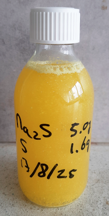

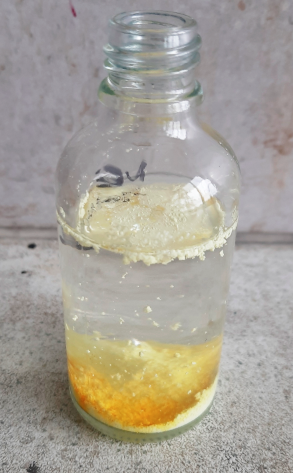

Neat! That's easy enough to try. Sodium sulfide I had on stock anyway, and I also had a little bit of sulfur that I kept from a jar of sulfured out fixer (who knows when some elemental sulfur comes in handy, eh?)
This is in 150ml, so a little stronger than in the post you linked to. Just mixed and shaken, hence the cloudy appearance. What's interesting is that the solution turns quite bright yellow within a few seconds of mixing, even though elemental sulfur as such isn't water soluble. So something's happening alright. I reckon things will go faster if it's heated up, so maybe I'll put the bottle in a beaker of hot water later on, see what happens.

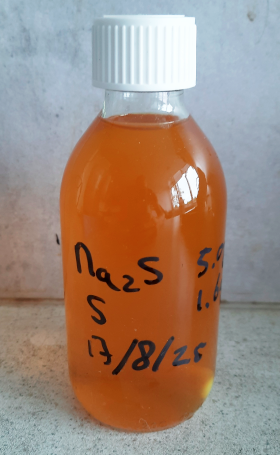

Edit: half an hour later, while looking for (and finding) the persulfate, the polysulfide conversion seems mostly complete with only a few clumps of sulfur floating around. Note how the color has changed to a less vivid ocher:

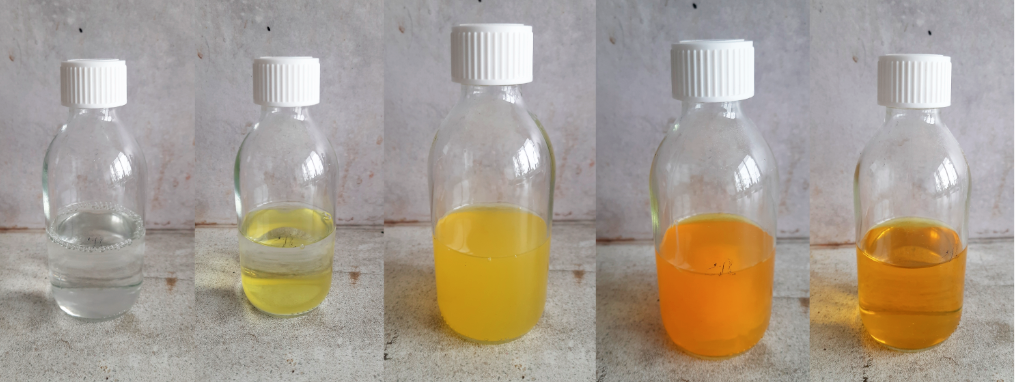

Not to worry - some haphazard experimentation gets us somewhere, I'm sure:
From left to right, all the same bottle:
  • 2.5g sodium sulfide in tap water
  • Immediately after 1g of sodium persulfate to it. Solution remains clear, but the powdered persulfate at the bottom already starts to react
  • After shaking the bottle, tones shift to more orange. Solution is still cloudy at this point.
  • This is after adding another gram of sodium persulfate
  • Let it sit for a minute or two and it clears right up.

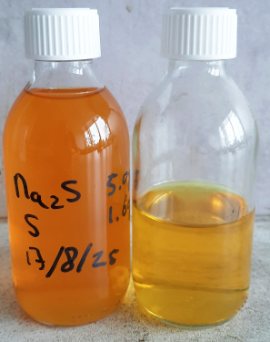

Here's the preparation compared to the bottle I made with Na2S and plain sulfur. The concentrations are different. I suspect the molecular weight distribution of the polysulfides are also different in the bottles. But I figure the functional properties are probably about the same:
Maybe if I add a little more persulfate the bottle on the right turns darker. IDK.

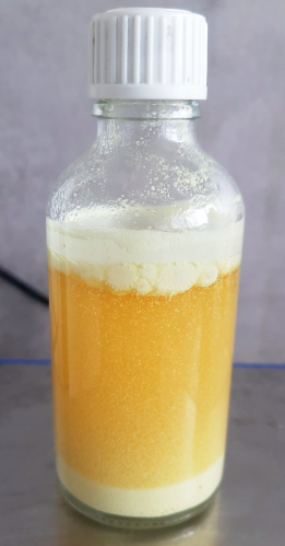

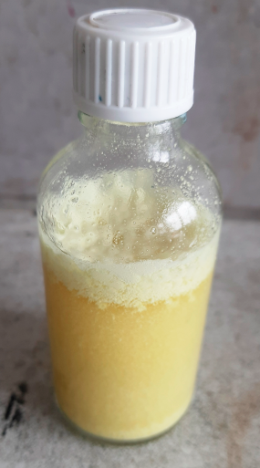

This is 4.0g sulfur + 1.0g sodium hydroxide in some 40ml of really hot water:
Note how something is definitely happening where the sulfur and the hydroxide meet.
After vigorous shaking for a minute or two.
If the sulfur is allowed to settle, the solution can be seen to already have turned yellow/orange. So it appears to be working alright.
