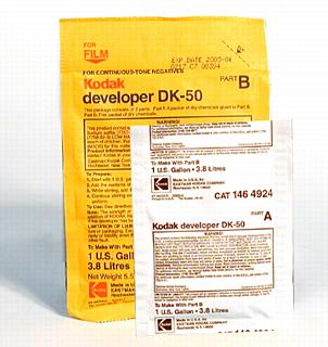

I think it came in bags as well, did it not? I revived an old thread on this developer.
Photographer's Formulary sells a packaged version.
Mark. Since FP4 is the closest thing to Plus X, how would you proceed to get that look out of FP4?
Other posters contributed a couple of possibilities. I think you want an upsweep in the curve, and a developer that's well buffered and diluted some might do that. The formula for DK-50 has 10 g/L of metaborate, so it's well buffered. That looks promising.

Someone said DK-50 gives similar results to HC-110. I already have some HC-110. Is this applicable to my needs or should I continue looking for DK-50? Also is there an aftermarket DK-50 being made? Or is it only from Kodak old stock on Ebay?

Curious. Would I get the same curve using DK-50 and HP5+ too? This might be my solution for killing two birds with one stone.
As I mentioned on page two of this thread, I use DK-50 1+1 with HP5 for Carbon Transfer printing. It bends the shoulder upwards, giving better highlight separation. It also has lower B+F (which is best for said process).
