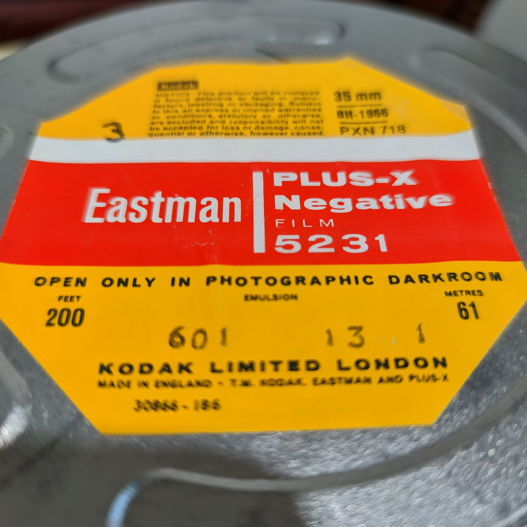

I have some Plus-X but have no idea when it is from. If anyone recognizes the box and can tell roughly what period it is from - I would appreciate .
I also have some Tri-X Pan that expired in 1982 - I plan to do a head to head comparison. I could also add Double-X 5222 to the test, but it wouldn't be very fair since it's fresh...

I have several 400 foot cans of Plus-X 5231. It is motion picture film, like 5222. I shoot it at EI 80 (same as the original formula of Plus-X!) 64 EI in tungsten light. It's great film stock!
The motion picture Plus-X is different from still film Plus-X. Whether the difference is meaningful to the OP, depends on what the OP needs from the film.
Yes, although that difference can be less or more now, depending on the storage condition of the film.
