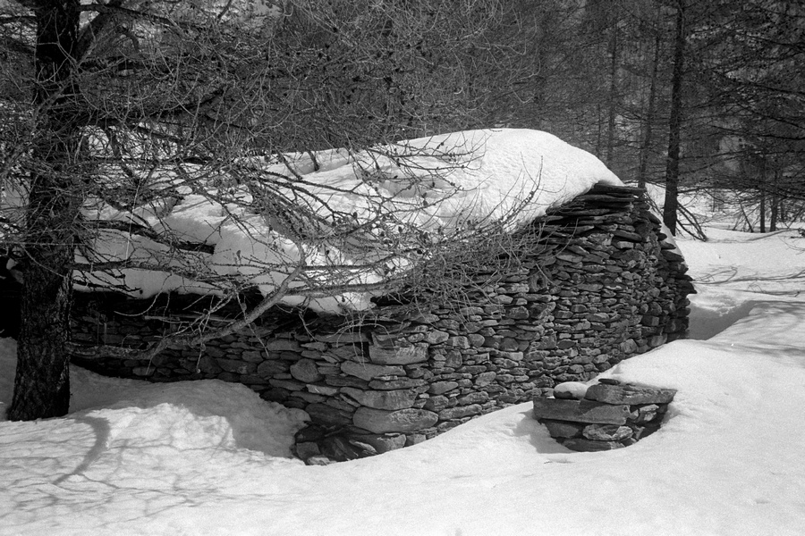

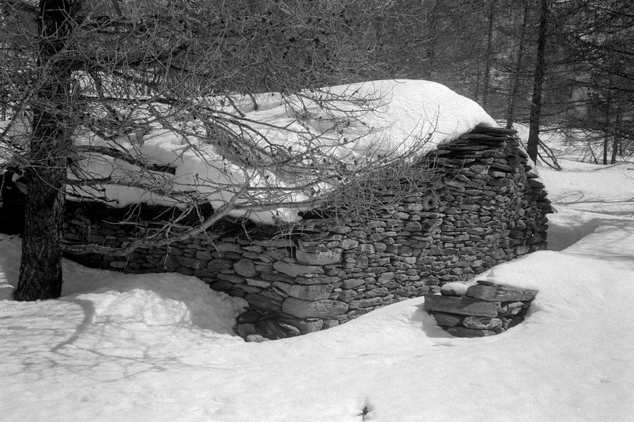

Back in April 2009, shortly before Plus-X was discontinued, I made a test during a hike. Last picture of a 125PX roll, and first picture of a FP4-Plus roll. Same scene, camera, exposure. Developed in both cases in, D-76/ID11 1+1, respective datasheet time minus 10% (contrasty scene). Straight scan with LS-2000, same parameters for both frames, histo cutoff at 1% for shadows, 0.2% for highlights.
Now, quick, which is which? The unique rendering of 125PX should make that question trivial.
I'm going to take a wild guess that plus X is the lower photo. It has more contrast. There is less shadow detail, and the highlights are almost blown, which suggests to me that the curve might be upswept. However, I am prepared to be wrong.
I like the second photo best, although the first one probably has more information content.

I'm going out on a limb... I think the FP4 is the top one... better rendering of shadow 😄
Bottom is Plus-X but really they're about the same.
Congratulations! Correct guess. I have to admit that you fault my prejudice that "golden eyes" were self-delusion.

The Plus-X is noticeably 'Crunchier' but again, I'm sure with the right developer you can get the FP4 to look like that. Or even a slight bit of post processing.
