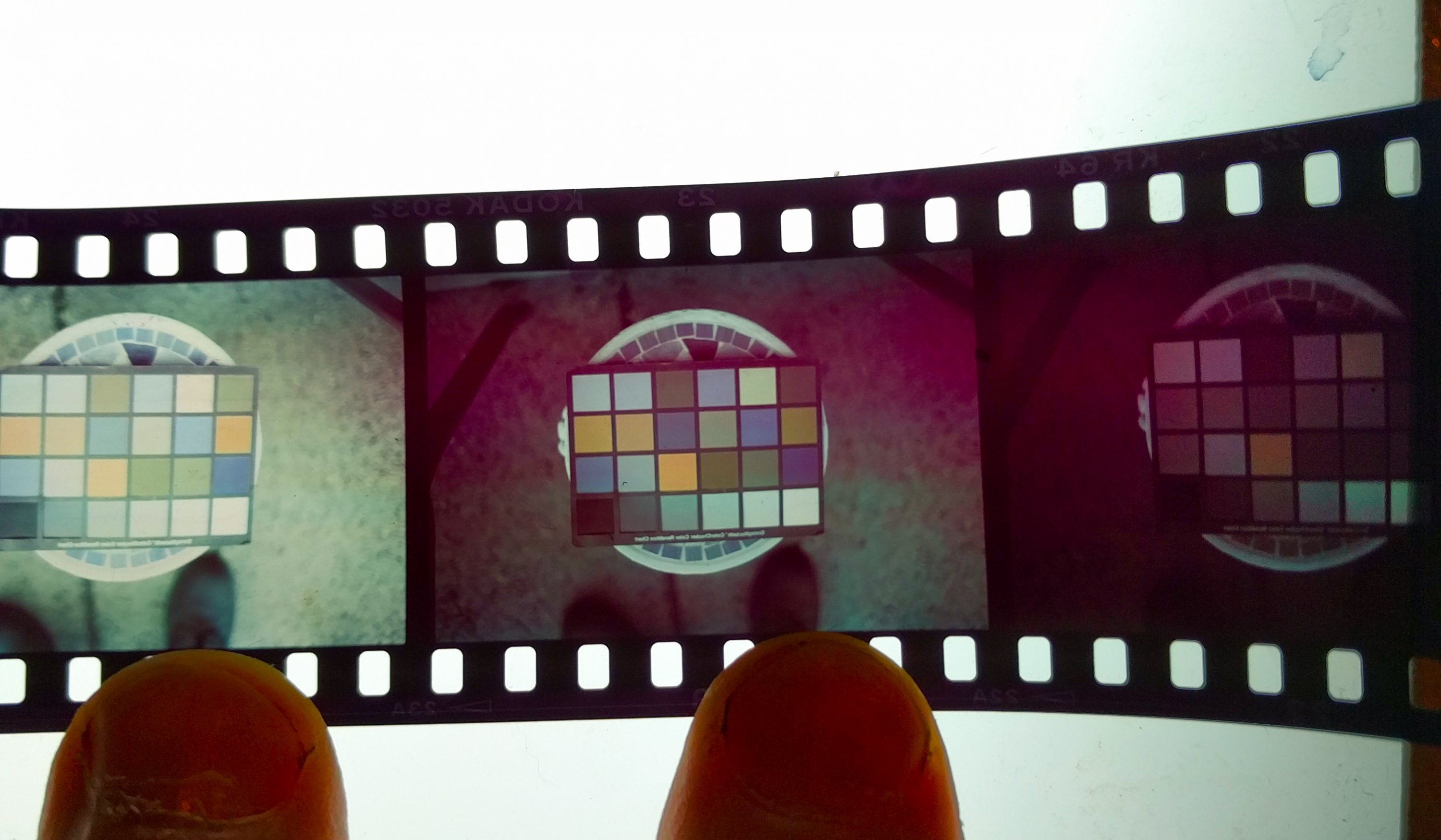

Development must go to completion. If you cut development time, then it might not. This could be quite bad. Reduction of coupler at the same development time will get it to go to completion but with less dye.
At least, that is my reasoning.
PE
Ok! Last test looks decent! Colors are a LOT more saturated, balance is still off a bit, but its looking promising!
PE
Yes I agree, that lengthening would be better, although these chemicals are not the original, so may behave different, although I agree that the longer they are developed, the more dye is formed and may help with the life of the film post-developing.
Increasing the Cyan development time may be all thats needed, will wait and see.
PE
I can see the logic in that. I'll go that route in my next test run.
Looks like after halfing the time on my magenta layer while it looked good, comparing it to my color charts shows I've lost most of my reds... So it wasn't QUITE as effective as I first assumed. I have good yellows now, so there's that.
Also comparing the edge density to my non-PH adjusted test, I'm absolutely NOT developing to completion. So I should fix that.
I see what you mean about the reds, but you have made good progress.
Yellows do appear good also.
Probably lengthening the cyan development time will correct that, and keep the full magenta development as before.
IIRC, you said you had to shorten the cyan development because it was overpowering?
Yeah, so maybe you increase the cyan time and decrease the quantity of coupler like PE suggested?
Yeah, Cyan was 3 min, yellow 8, and magenta 6 before I started mucking with PH. This last roll was cyan 3, yellow 8, magenta 3.

PE
