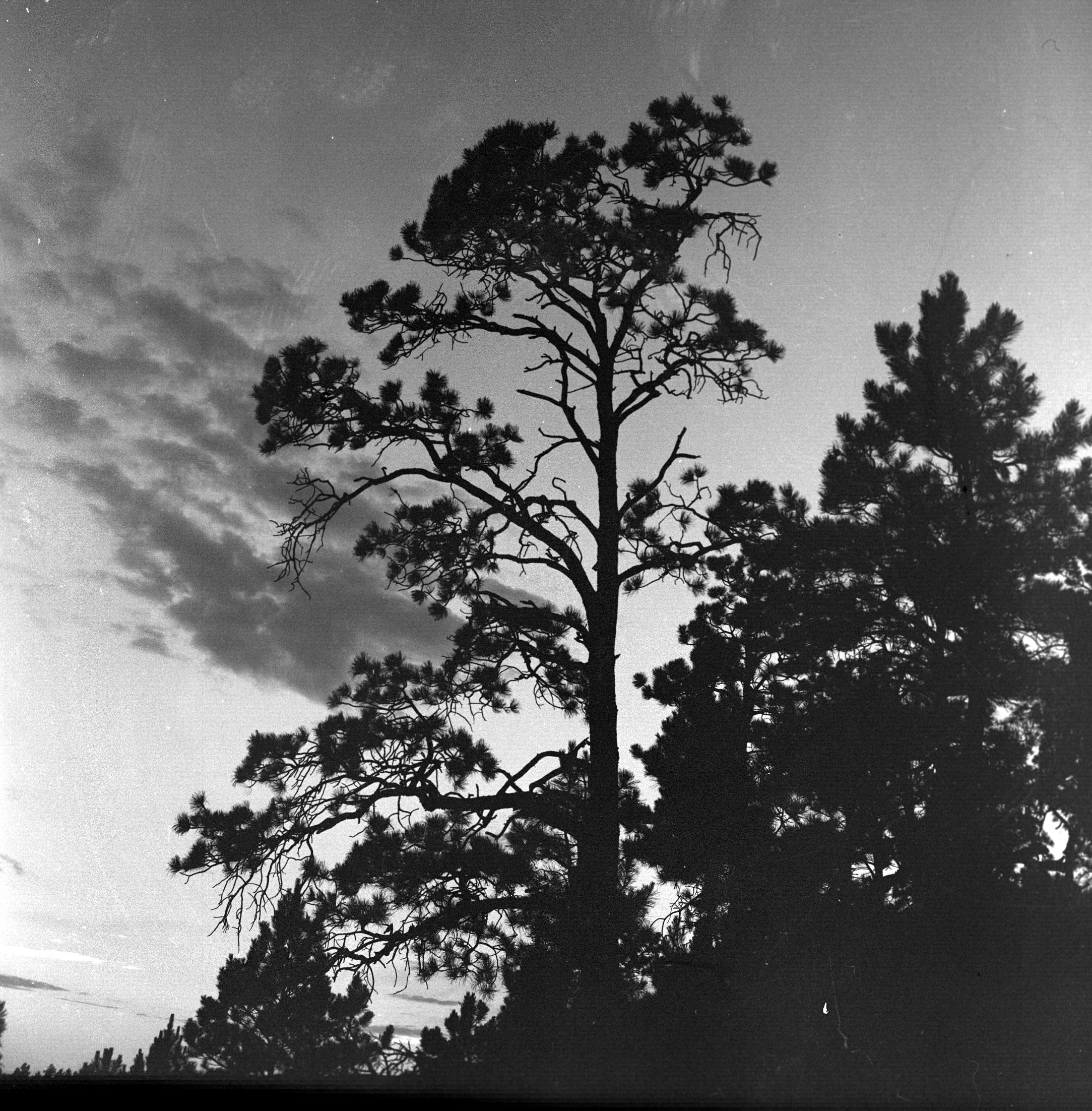

Initial attempt with Kodachrome / B&W
Nothing to lose - this was 120 that at the time intended to be a color image.
I still have not decided what to make of this outcome. It has the ortho look of films of the 1920's, although my scanning-esthetic may have over-manipulated it to my liking. Rather grainy.
Developed in HC-110B, at half-again the usual time. The RemJet fell off after the fix in 1-tsp each of 20-muleteam borax and dishwasher detergent in a liter of water, with a wad of cotton. Afterward the usual HCA and wash.
What with the overall orange (this must disappear somehow when processed correctly) it probably won't print well in the usual way. Kodak used to have a paper intended for this sort of thing. The film has a thickness and curl that makes getting into the Coolscan holder a little tricky. Best to wear cotton gloves.
Tri-X it ain't, but I have half a mind to shoot the remaining unexposed film. Might be cool to be one of the few in this universe shooting Kodachrome film.

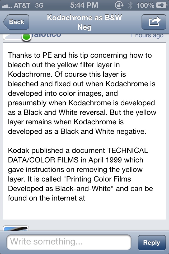

Thanks to PE and his tip concerning how to bleach out the yellow filter layer in Kodachrome. Of course this layer is bleached and fixed out when Kodachrome is developed into color images, and presumably when Kodachrome is developed as a Black and White reversal. But the yellow layer remains when Kodachrome is developed as a Black and White negative.
Kodak published a document TECHNICAL DATA/COLOR FILMS in April 1999 which gave instructions on removing the yellow layer. It is called "Printing Color Films Developed as Black-and-White" and can be found on the internet at
www.[B]kodak.com/global/en/consumer/products/pdf/ae31.pdf
[/B]This yellow layer is composed of colloidal silver; that is silver grains so small that they can go into colloidal suspension. At this small size they interact more directly with light rays, apparently absorbing blue light more efficiently and thus appear yellow.
The instructions that Kodak gives are simply to mix 1 oz, 28 grams, of anhydrous citric acid into one gallon of Kodak Rapid Fixer which has been mixed to the proper concentration to fix films. The Kodachrome photos are fixed in this for 7-14 minutes at 75-80 degrees f, after having been soaked in Photo-flow and rinsed. The ingredients for Rapid Fixer can be found at Dead Link Removed
The main ingredients for the Rapid Fixer are: ammonium thiosulfate, sodium acetate, boric acid, sodium bisulfite, aluminum sulfate and sulfuric acid. The ph of this material must be low. The sulfuric acid probably has enough potential to oxidize the colloidal silver particles, especially since these are so small. I'm guessing that these will be oxidized first and then fixed out by the thiosulfate. The instructions do warn that this Rapid Fixer can reduce the metallic silver forming the image.
I'm guessing also that the citric acid provide citrate ions causing the yellow silver to form silver citrate. Perhaps this salt is less soluble than the acetate salts and will isolate the silver atoms and drive the reaction to dissolve out the colloidal silver. Would these citrate salts be less soluble?

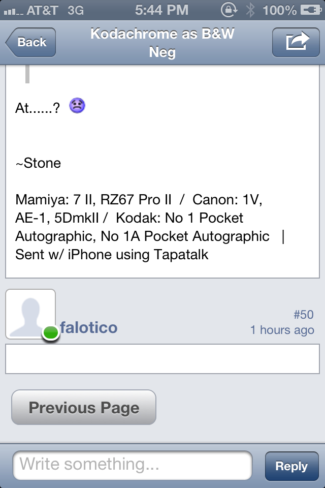

At......? :sad:
~Stone
Mamiya: 7 II, RZ67 Pro II / Canon: 1V, AE-1, 5DmkII / Kodak: No 1 Pocket Autographic, No 1A Pocket Autographic | Sent w/ iPhone using Tapatalk
At www.[B]kodak.com/global/en/consumer/products/pdf/ae31.pdf
[/B]I don't know why the internet address did not print out correctly in the above post. Sorry.
Is it just me or are you posting blank posts?
~Stone
www.kodak.com/global/en/consumer/products/pdf/ae31.pdf
My apologies again. I definitely am NOT posting blank posts, but I seem to have stumbled into a computer syntax error with this web address. If you can read it then copy it and paste it into the address line at google. Then click on the item "Printing Color Films as Black and White". This should bring up the Kodak document. The web address reads out in longhand as: www dot kodak dot com backslash global backslash en backslash consumer backslash products backslash pdf ae31 dot pdf
Otherwise, try a google search for the title of the Kodak document, "Printing Color Films Developed as Black-and-White". Hope it works!
