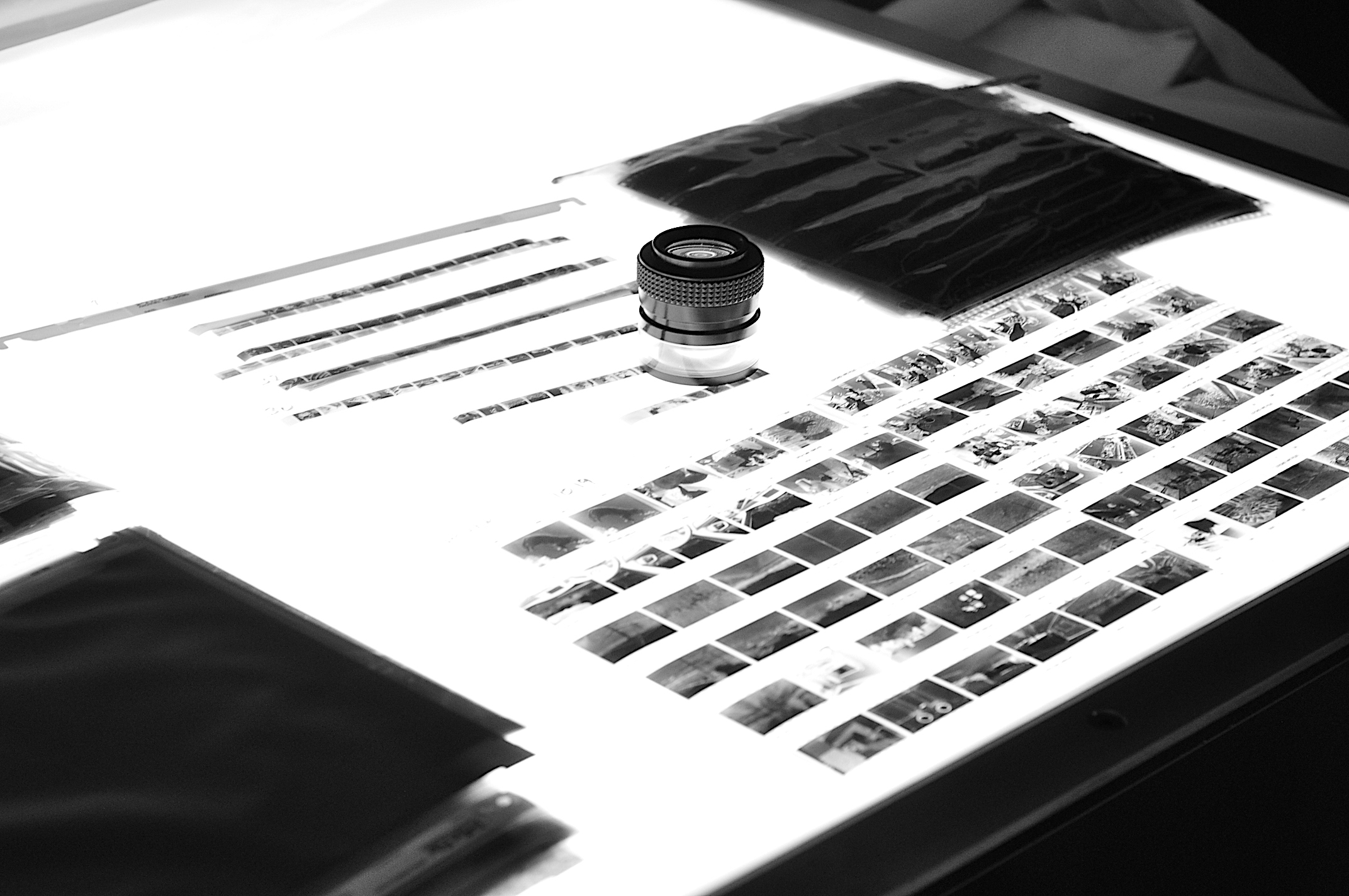

I use this wide field 8x Kenko loupe. I find looking at the negatives with a magnifier is the best way for me to tell which ones are going to make good enlargements.
