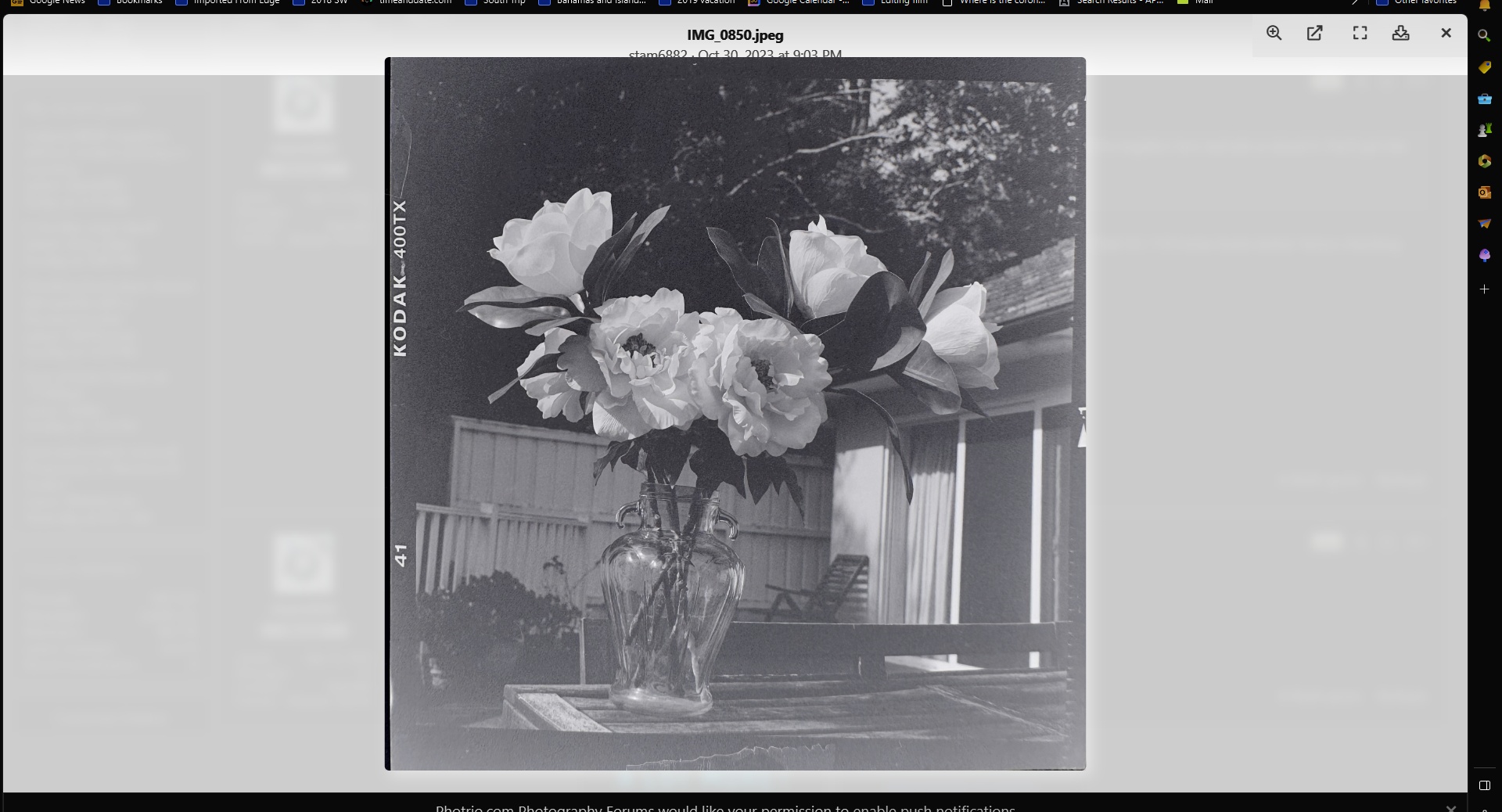

Here is my test shot. I usually develop my 400TX with HC-110 but first time trying D-76 (1:1, 9.5 minutes). I feel HC-110 tones looks better hence checking.

Because the contact sheet applies a certain amount of contrast.
there's contrast inherent in the negative, non? If you bring a negative to a professional printer, do you think they'll make a contact sheet?.... or just put the negative in the enlarger & start making test strips........
Yes, but you cannot tell exactly if the negative will make a good print. A lot of folks over-develop their film. It's only a means to an end. Without experience, it's hard to judge. A negative should look "flatter" (less contrasty) than a print.
That is perfect! Development looks great, there’s some specular highlights that are going to print white but they’re appropriate.
I’d have given a bit more exposure only to give a chance for a little texture in the blank background. But your exposure is the “correct” exposure.
You’re good to go.
You’re good to go.
I would have given considerably more exposure, to be frank. The leaves around the flowers will render solid black the way they are now. I would personally have preferred more shadow detail.
This mostly goes to show that what you need from a negative is kind of personal, too. If the intention here was to render the flowers themselves in a pleasing way while allowing the rest of the scene to drop into the abyss, then the exposure is evidently OK for that purpose.

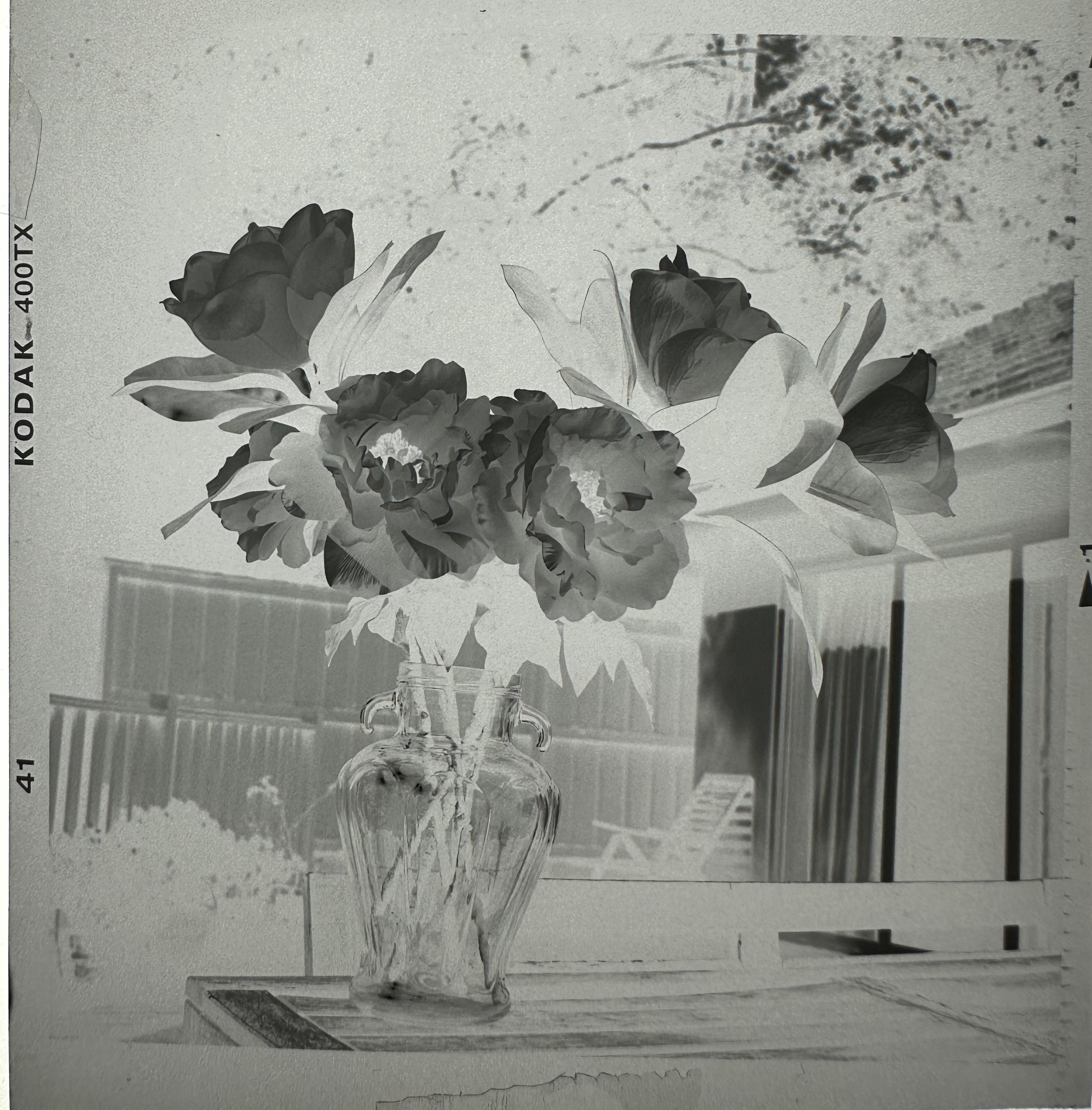

There seems to be a white haze over it when I reversed it.
I expect that haze is a consequence of how the image arrived on Photrio - most likely a cel phone or digital camera snap of a negative on a backlight, resized and uploaded here.

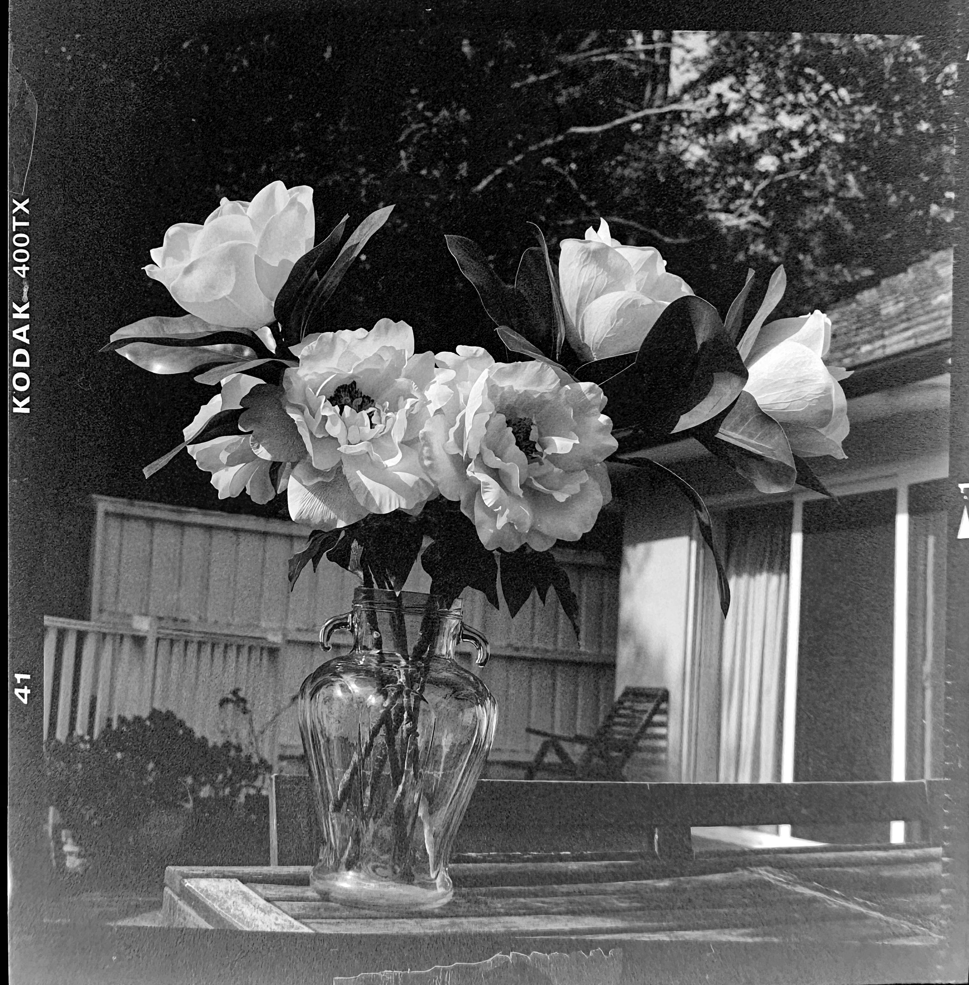

Here's an inversion with a little editing to see better throught the haze. Theses quick and dirty scan and edit (I used the snapseed app on my phone, took me seconds) are good enough to have a approximation of how it could look on paper. Here we see that the dark leaves with little details will "merge" with the equally somber background, especially with a high contrast that one may want to use so the white of the petals "pop".
