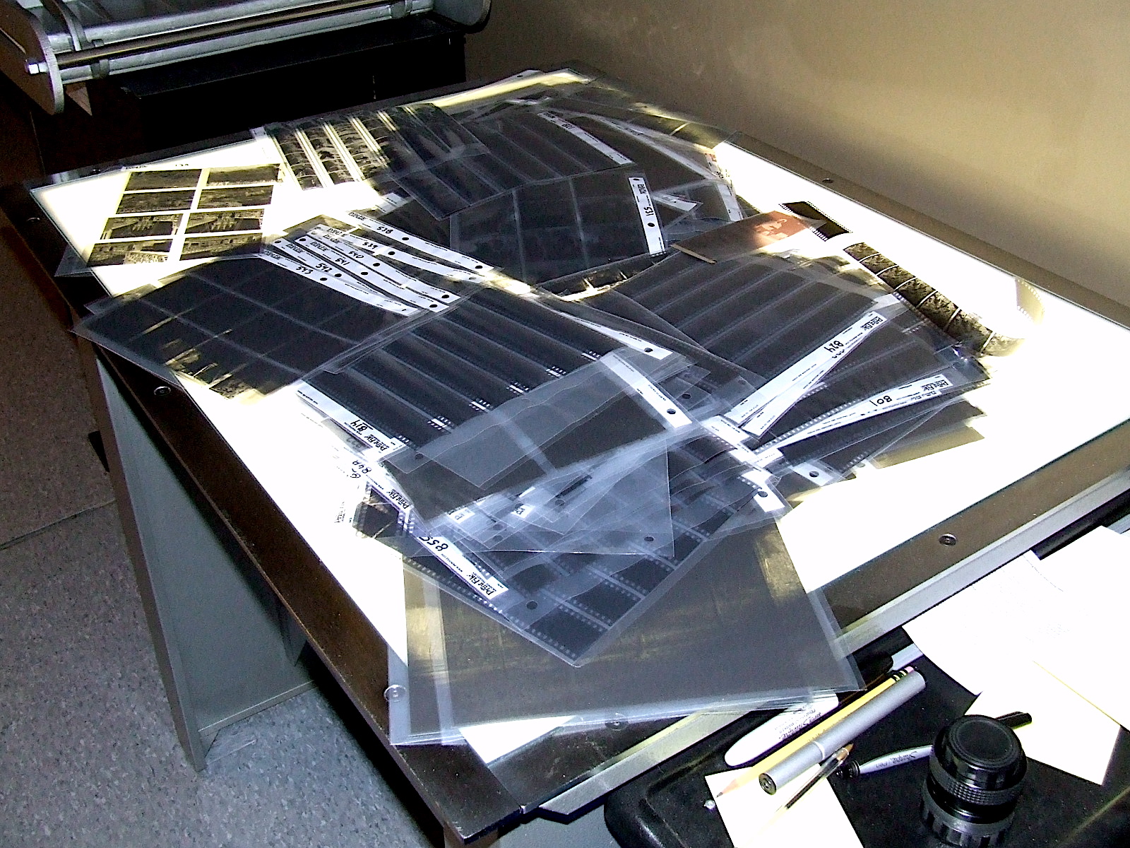

I still have one of those large light panels around 20x30" with a 35mm slide holder that lays on top for examining and sorting slides. I haven't used it in years. I wonder if it's worth anything to anyone?
