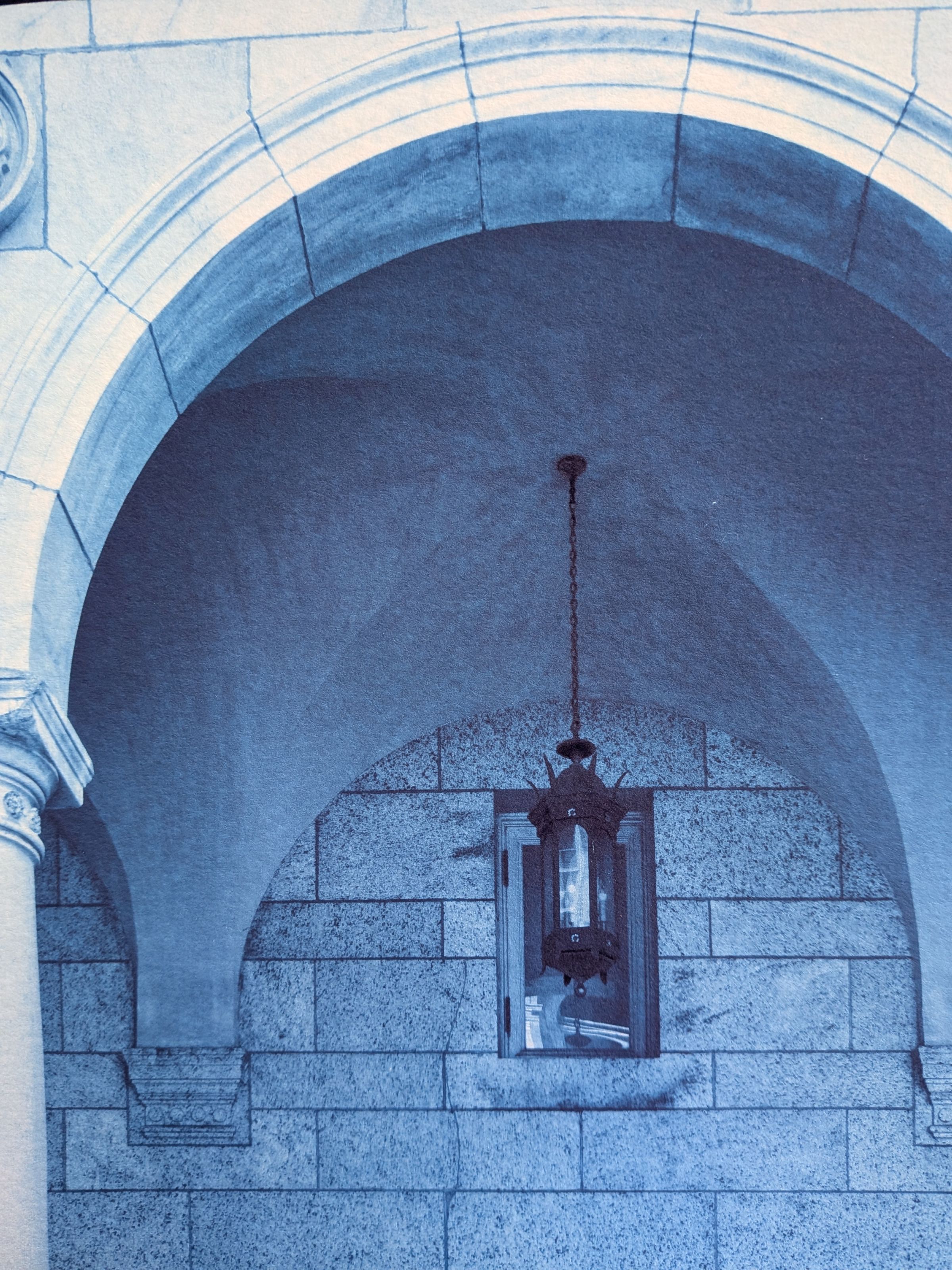

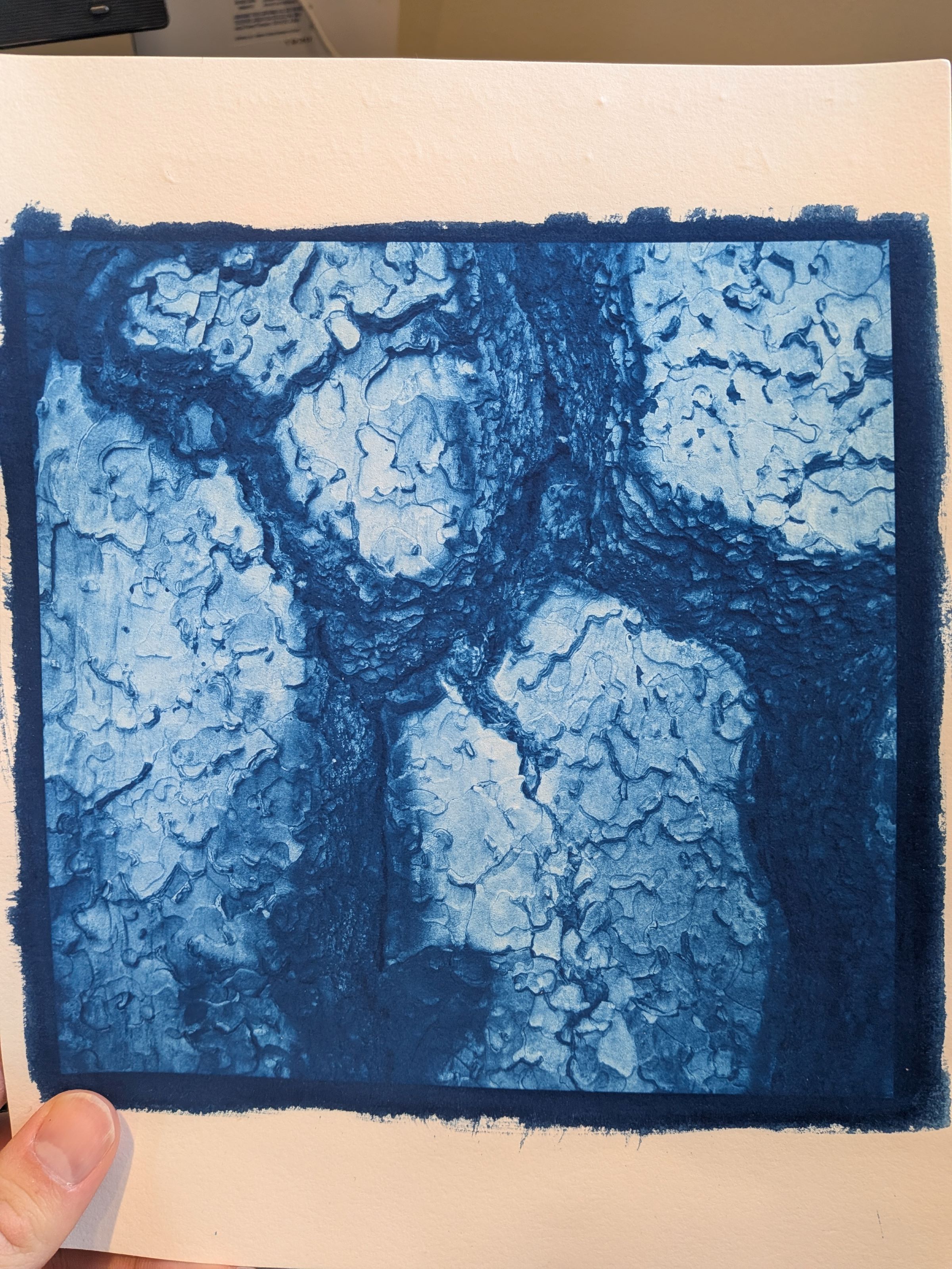

I didn't take a picture of the paper prior to exposure, but that edge bleeding really looked like the water was pulling away from the ring of crystal deposits around the edge. Very well could be another explanation such as @koraks.
I have tried diluting the sensitizer, moisturizing the paper, and adding tween20. Admittedly I only used moisturizing/pre-humidification and tween20 in combination. I did not combine diluting the sensitizer with these other variables. As far as per-humidification goes, I'm leaving the paper on some screen above a tray of water. Another try is placed atop and left for several hours before coating. I use this same contraption for post-coating humidification for my kallitypes, but doing it after coating appears to invite paper fog for new cyanotype.
I ran into the same issues with splotches using more or less sensitizer on HPR. I think HPR is just difficult to coat using the new formula.
As long as I can get HPR to continue to coat well using the classic cyanotype formula I still think I'm going down that path. Exposure time vs the new formulation is not that much longer and the dmax is almost as good. Though the color is quiet different using a 20% FAC solution. Very turquoise by comparison.

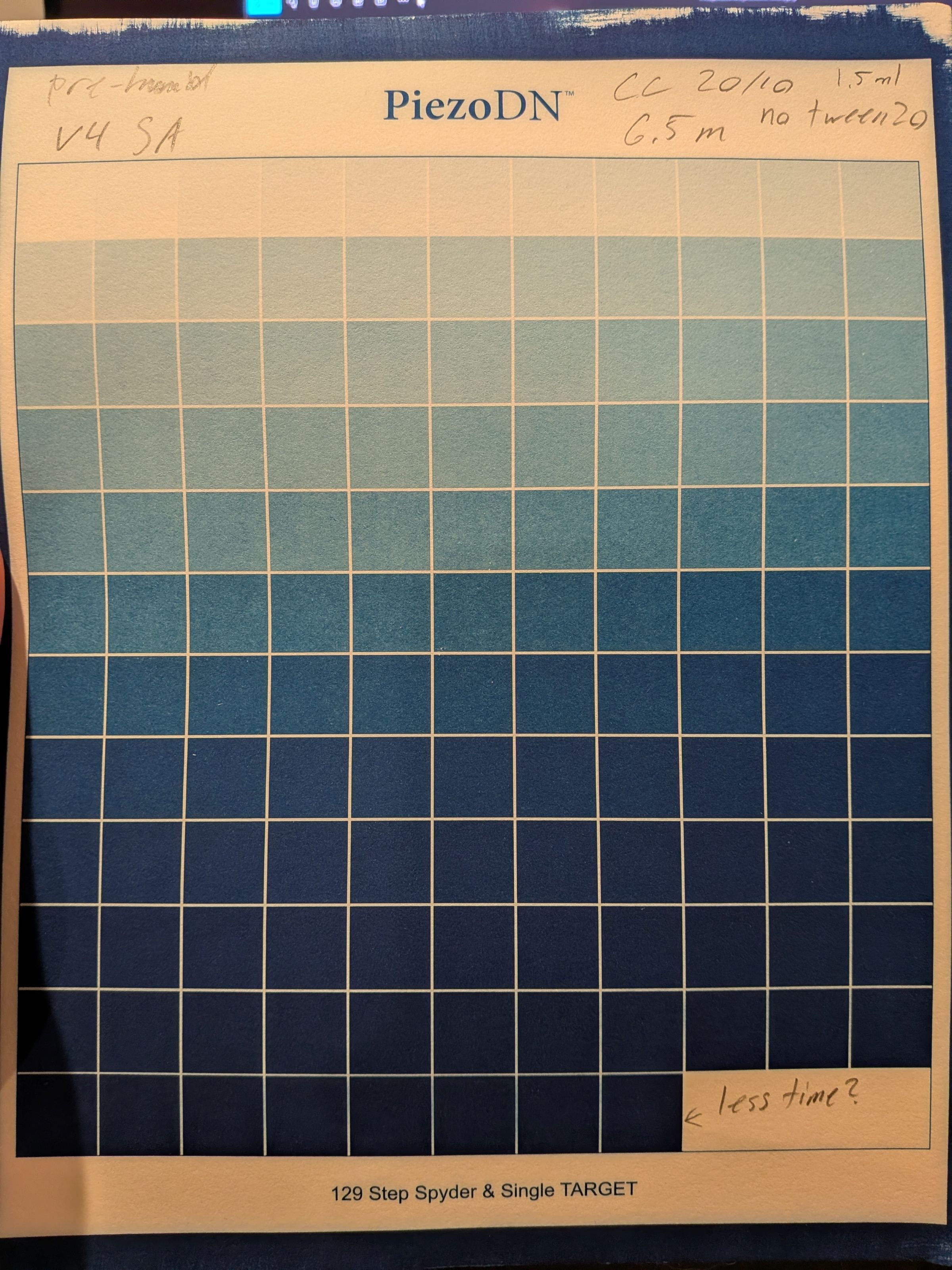

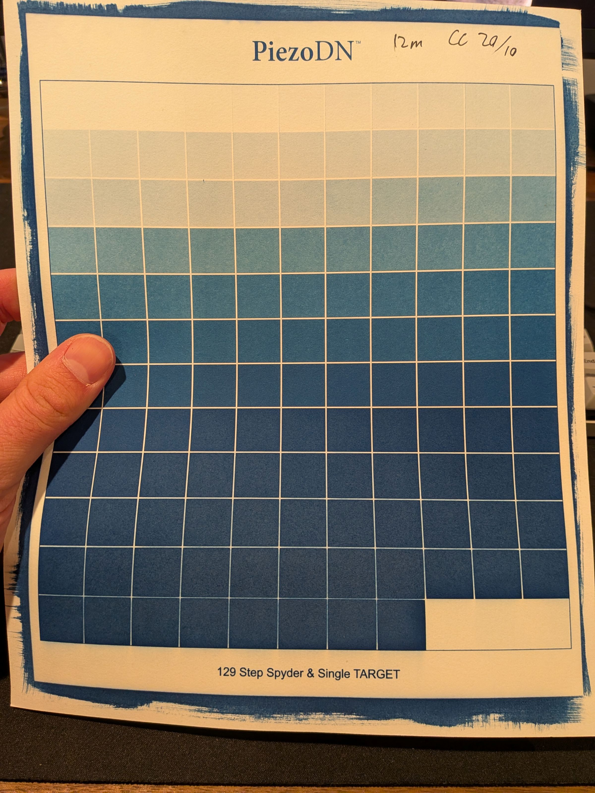

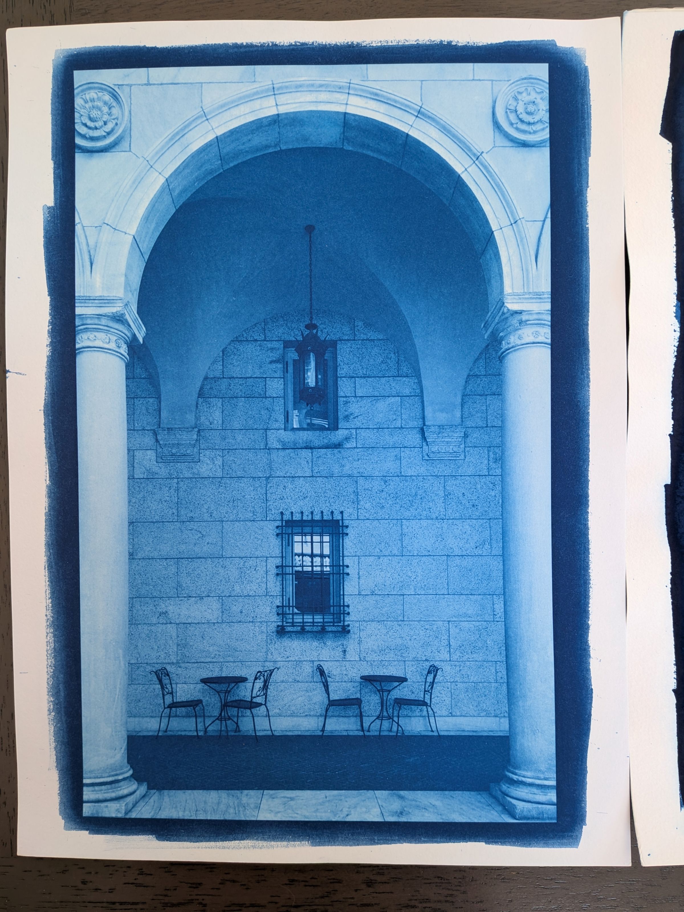

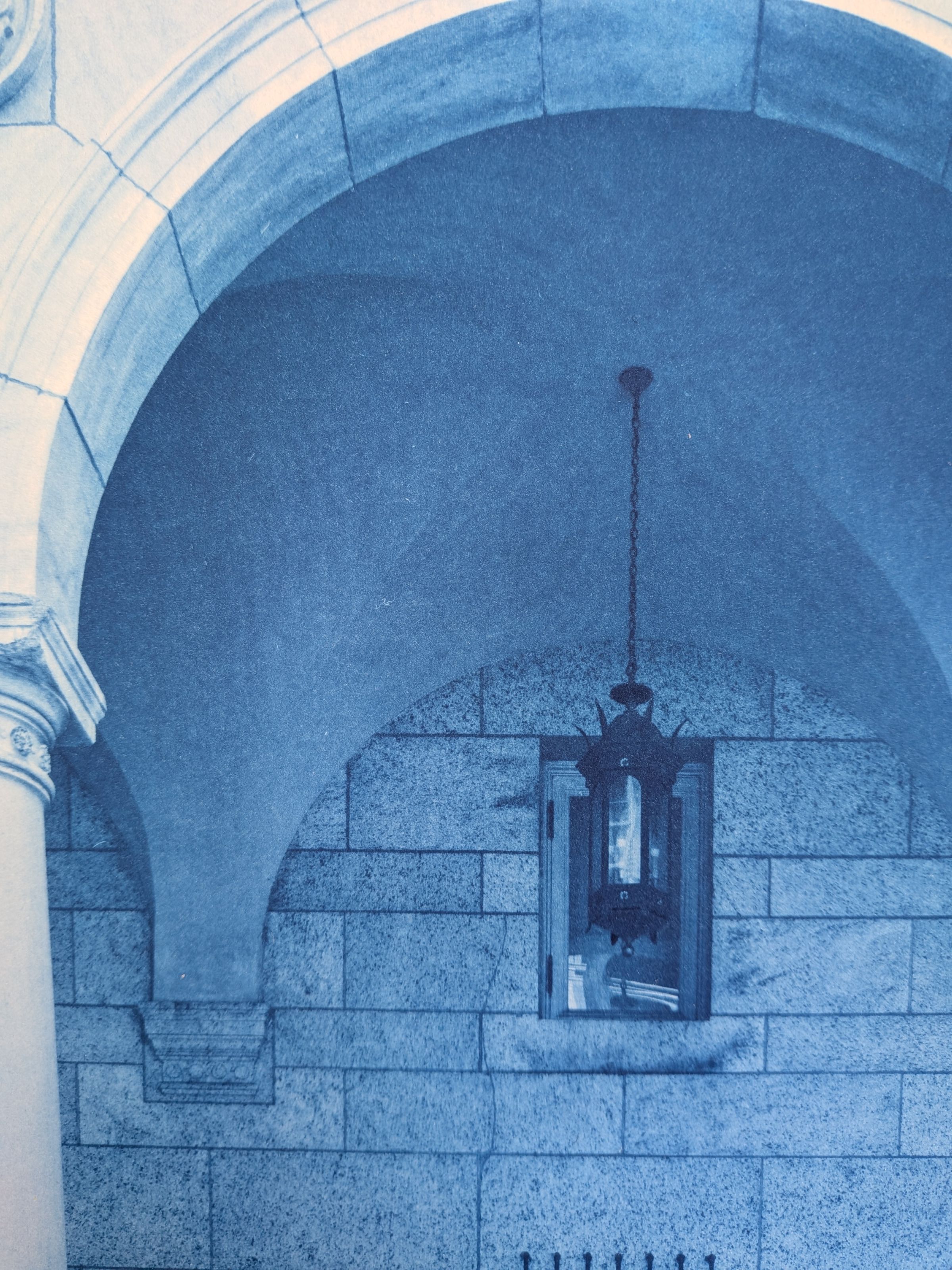

Success! I got something I think I'm mostly happy with.
Classic cyanotype on HPR
20% FAC
10% PF
no tween20
paper pre-humidified before coating
The result of the above gives me something that is easy to coat and coats repeatably well. Dmax is good and the exposure time is short. The attached image is of an un-calibrated test chart exposed for 6.5 minutes. I think somewhere between 5-6 minutes is better. Oddly this is shorter than the exposure time I was getting for the new cyanotype formula which is supposed to be more light sensitive?
The resulting color is certainly different than the new cyanotype formula. This is much more green blue where the new formula gives a more purple/grey blue result. Subjective, but I wish this was slightly less turquoise with HPR. New cyanotype also results in better dmax, but as previously noted, much harder to coat well.
My only real complaint with this combo is some mid-tone grain/unevenness. It might be hard to make out in the attached image, but it really is only visible in the midtones. This is present on HPR regardless of the inclusion of tween20 or if I use 10 or 20% FAC. I'm assuming this is some unevenness in the absorption of the solution in the paper fibers. New cyanotype does not have this grain.
I ran into some issues using tween20 with this combination. When using 1 drop of 10% tween20 per ml, overexposed shadows would start looking permanently solarized and gross. This problem gets worse with more overexposure. The second image depicts this issue. Also note that the white grid lines are starting to disappear. Also note that the edges of the squares adjacent to the white border have a bit of an edge effect. This issue is reduced with less exposure and eliminated with the exclusion of tween20.
My guess is that the tween20 is causing the solution to absorb too far into the paper. Light is then penetrating into this deeper layer, exposing it and changing how light interacts with the surface causing an apparent loss of density and change in color. Additionally I think there might be some sort of light piping effect happening here where light is penetrating and diffusing into the paper beyond its surface. This then exposes some of the solution that resides under the paper surface, even if it is being masked by the negative. This would explain some of the edge effects and why the grid between the squares appears to be getting encroached upon.
I also tried combining new cyanotype with classic cyanotype (10% FAC) 1:1. The results were in between classic and new formulas. The color was still a bit green-blue, but less so than classic on its own. Dmax is maybe slightly better than classic 20% FAC. There is no grain. Coats better than new cyanotype, but still has issues. Some uneveness in the coat and random light spots with jagged edges. Did not have the above described tween20 issue. No edge bleed. May work well for a different paper, but additional complexity seems hard to justify.

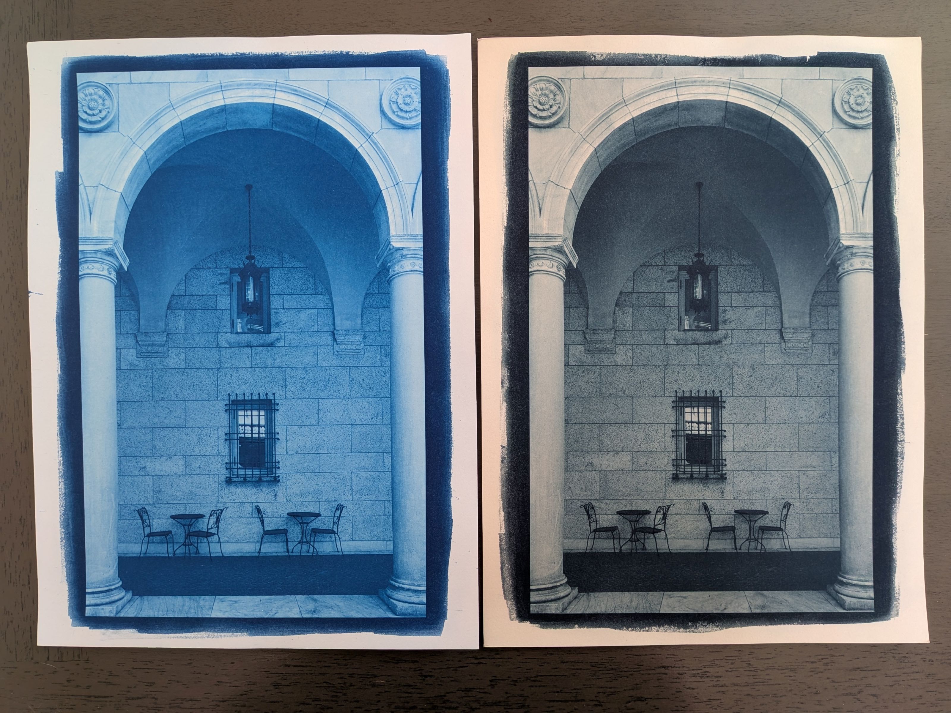

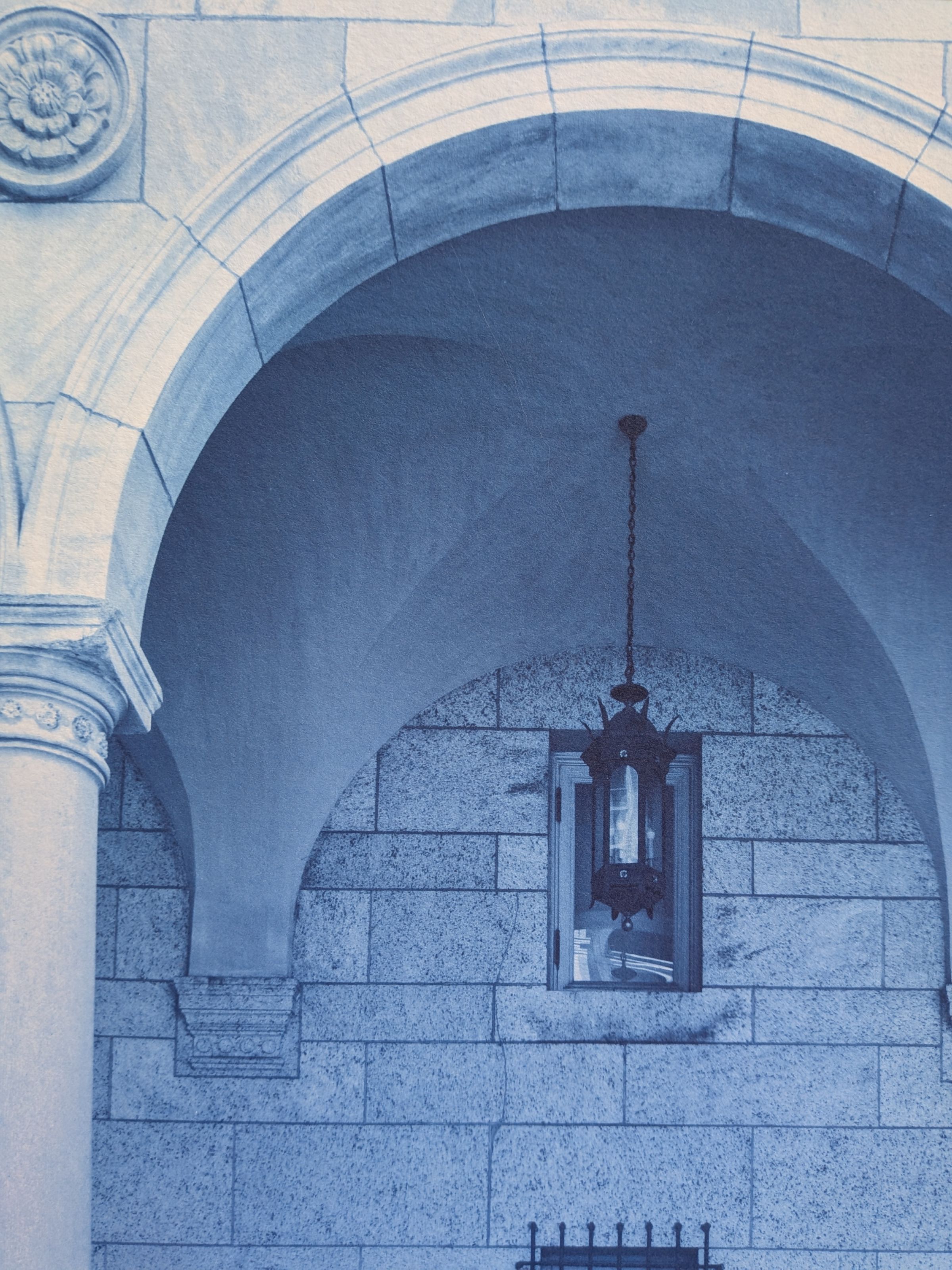

Success! Calibrated my profile and made a test print. Not meant to be an artistic masterpieces, just wanted something that was tonally challenging to ensure what I am reading on my test chart matches what I expect in a print. Some fine tuning may be needed as the deep shadows are a little muddy, but overall looks good.
This was classic cyanotype on HPR. 20% FAC, pre-humidified before coating, and no tween 20. Exposure was 4.5 minutes. 0.25% citric acid first bath.
My results are a bit at odds with what is expected per Christina Anderson and Mike Ware. With the above combination, my exposure time is less than new cyanotype. Granted dmax is not as high as new cyanotype, I get to dmax faster. I also find that a higher concentration of 20% FAC to expose faster than 10% FAC. This is the conventional wisdom, but C. Anderson claims that she go faster results with 10% FAC. I wonder what variables are contributing to this.
In any case, the results I'm getting with the listed combo are good and ready for use.
I am going to go back to trying to get the optimal combination with Canson XL Watercolor paper next. It is cheap, easy to coat, and I think I might be able to tweak it to get something I like. 20% FAC is already an improvement over what I was getting with 10% FAC in terms of color, dmax, and exposure time. It is very grainy when coating a dry piece of paper. Pre-humidifying seems to help, but adding tween20 reduces dmax and creates that sort of edge bloom effect I described easier. Solution penetrating too deep into the paper. Going to try acidifying it first too and see what that does.
I also will probably return to arches aquarelle cold press using the classic solution. That didn't seem to have as many problems, but exposure time was too long. Might be better with 20% FAC.
Also got new Richson 9010 brushes which are a vast improvement over what I was using. I can coat using less solution and get much more even strokes. Maybe this will help with coating new cyanotype?
Oh, and can't forget about trying double coating.
I have all this paper and chemistry, I'm going to try to figure out what I like best. It's cold outside here in the northern hemisphere, what else am I going to do?

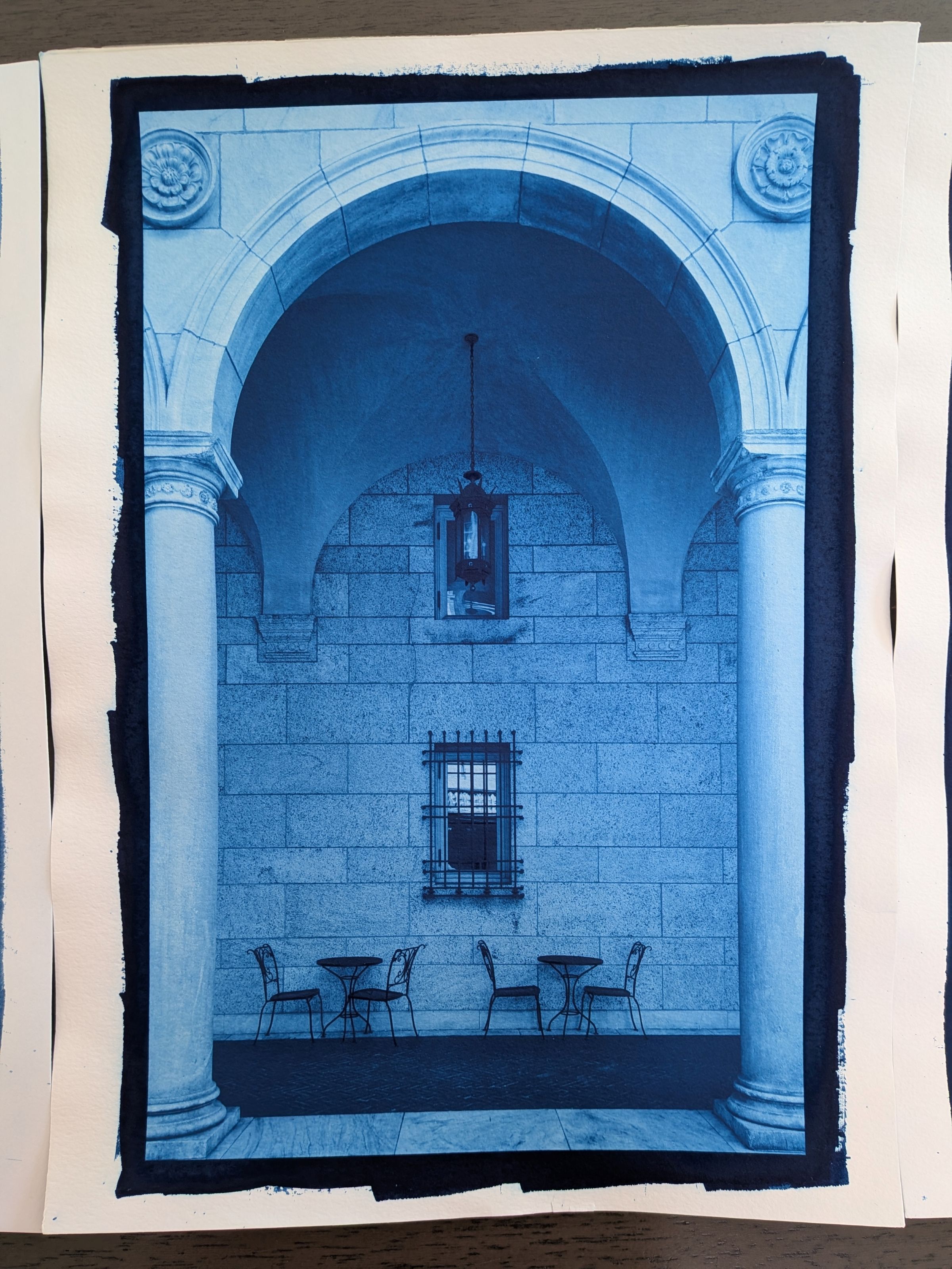

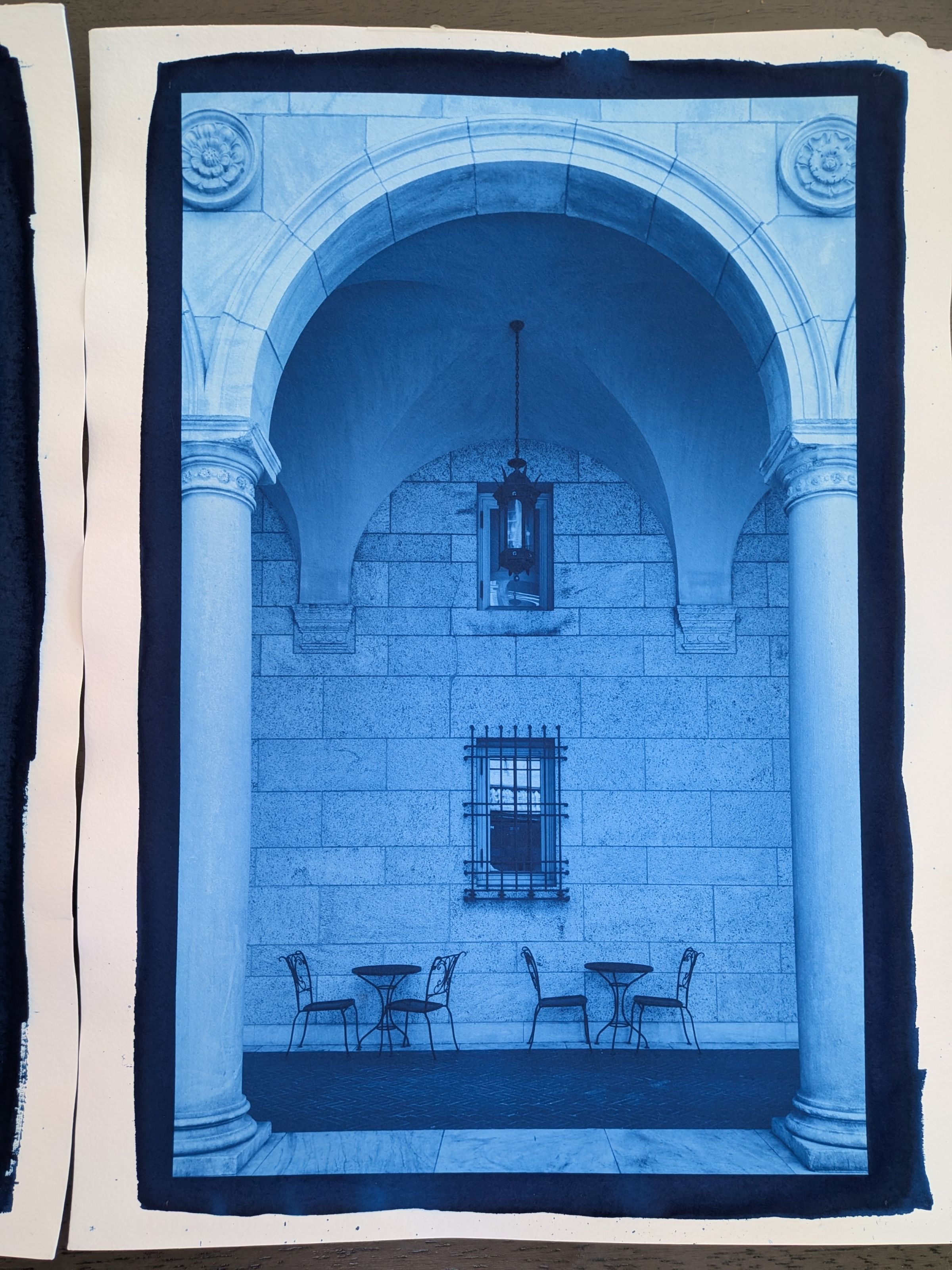

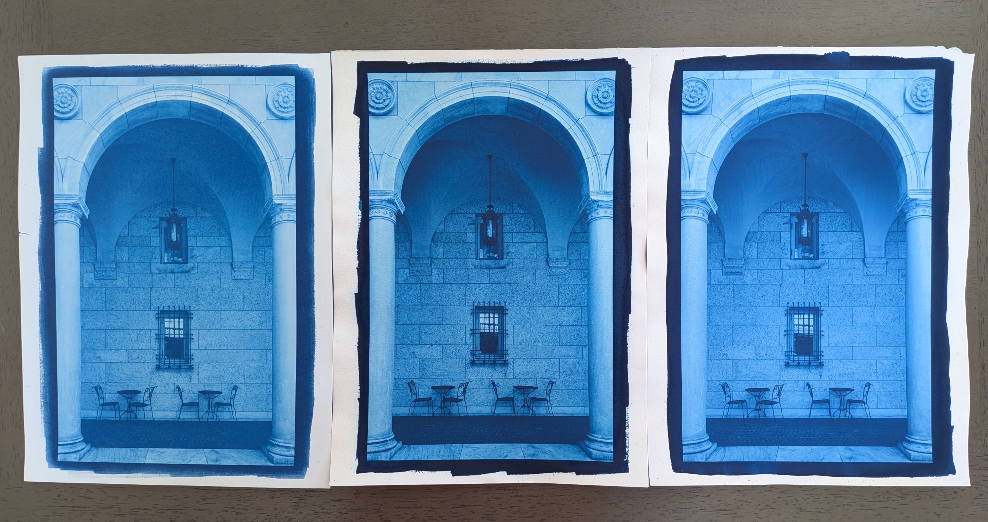

Got another winner! I'll post some images of my results later once I'm done with more calibration.
Canson XL Watercolor paper is awesome. It's cheaper and easy to coat right off the pad with classic cyanotype. It yields a somewhat muted blue-gray color with similar dmax to classic cyanotype on HPR. It has a distinct "blotchy" grain which appears to be from variations in the papers structure. But, very acceptable.
This paper completely transforms when you pre-acidify it in sulfamic acid. Classic cyanotype has greatly improved dmax and the color changes from that muted gray-blue to a much more striking cyan. Double coating it improves the dmax even more and reduces the grain somewhat. It looks very stunning, especially compared to classic cyanotype on HPR. There is not contest when it comes to dmax.
The paper also becomes compatable with the new cyanotype formula once acidified. It coats well (so far), free of much of the issues I experiences with other papers, but, it must be pre-humidified before coating. The dmax is impressive, somewhere in between the single and double coated classic formula. There is very little grain compared to classic giving a much smoother appearance. The color is also a nice royal blue color. Double coating does not work and worsened the image with lots of washout and grain.
I'm not sure which of the two combinations I'm going to utilize going forward, but I'll know once I complete my ink profiles and make some images to compare.
I've made three prints of the same image with the following recipes:
Left:
-Hahnemuhle Platinum Rag
-Classic Cyanotype (CC) 20% FAC
-Paper pre-humidified before coating
-single layer coating
-exposed 4.5m
-0.25% citric acid first wash
Middle:
-Canson XL Watercolor
-Paper coated dry
-Paper acidified in 10% sulfamic acid
-double layer coating
-exposed 6m
-0.20% sulfamic acid first wash
Right:
-Mike Ware's New Cyanotype (NC)
-exposed 4m
-1.00% sulfamic acid first wash
I feel like this is the culmination of all my efforts. Canson XL Watercolor after acidification has given me results I am very happy with. As you can see from the attached images, I get better dmax and smoothness with both combos using the Canson paper.
The double coated CC combo definitely has more dmax giving more visual punch to the image. Though it does have some "grain" that is visible in the midtones. This appears to be some slight unevenness to how the solution absorbs into the paper.
The NC combo has improved dmax over the HPR CC combo, but not as much as the double coated CC Canson combo. It does have much better smoothness than using CC and the royal blue color is beautiful. Not sure which I like better.
Oh and for fun I attached an image of CC HPR toned in instant coffee for a few hours.
