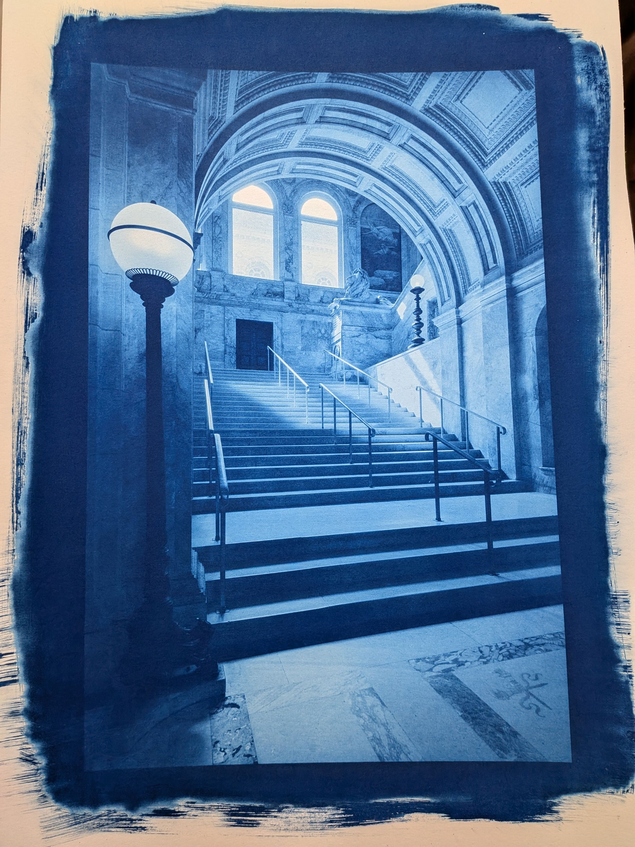

I have determined the source of much of my problems with the new Cyanotype formula. After eliminating many variables and fixing other issues, the problem comes down to coating issues (or paper compatibility issues). Specifically paper absorbancy!
What I am finding is that with papers such as Legion Revere Platinum (LRP) or Hahnemuhle Platinum Rag (HPR) is the solution does not evenly disperse into the paper no matter how well I think I coat the sheet. What appears to be happening is the water in the solution is readily absorbed by the paper, but the contents tend to get deposited on the surface. The result is a sparkly, crystal like finish when dry. The is in contrast to using the classic formula or when using the new formula on Arches Aquarelle when dry. Those tend to a matte finish.
This "sparkly" finish has a direct correlation with the properties of the final product.
-The more "sparkly" the finish, the lower the dmax and the more run-off in the wash water.
-The dmax improves with pre-humidification and the sparkly appearance diminishes.
-"Sparkly" surface papers loose much, if not most, of their denisity in plain or a citric acid first wash. Using a mineral acid such as sulfamic acid is a must. This retains the image.
-"Sparkly" surface papers appear to have much of the prussian blue sit atop the paper surface! You can feel the difference between areas of shadow and uncoated areas. The dense areas have a rough texture and tend to leave blue residue on your fingers.
I attached a test image I made using Legion Revere Platinum and the new cyanotype formula. The paper was not humidified prior to coating and was "developed" in 1% sulfamic acid. This combination seems to coat mostly well enough in the image areas, but doesn't have the best dmax.
I want to point your attention to the borders of the print. Note the water stain looking ring. Depsite coating to the best of my ability and not leaving any solution pooling at the edges, it created a bit of ink bleed effect. Prior to exposure, the paper had a dense green ring along the borders. I believe this is evidence of the paper absorbing the solution and leaving its contents deposited on the surface. Additionally the image area has a very gritty, chalk like surface. Again, likely the prussian blue sitting above the paper's surface.
This is likely a paper compatabiliy issue and also likely would be reduced with a diluted solution of the new cyanotype formula.
For now I'm working on the classic formula and doing what I can to get good dmax on HPR. So far a 20% FAC to 10% PF has good promise and surprisingly short exposure times. Tween20 and pre-humidification seem to give the best results.
