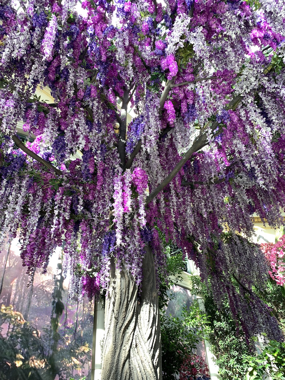

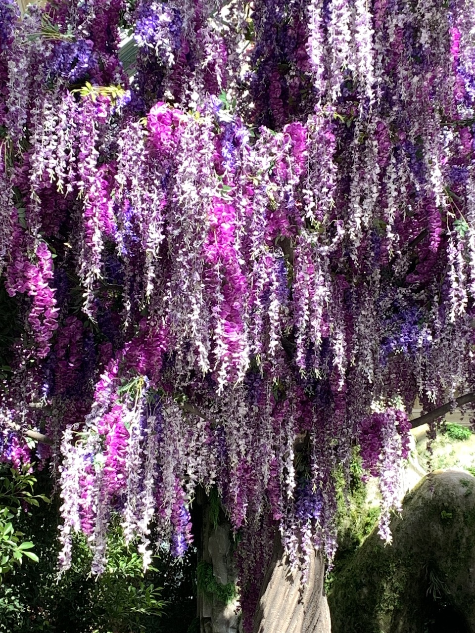

Well, up to a point. I just replicated Steven Lee’s disappointed picture with an iPhone. The magenta-ish purple hue was much more vivid to the eye.
And from a different angle it looks different. Less true to reality. Natural sky lighting through a glass skylight. No Portra or scanning involved. Viewing eyes are bespectacled with beginnings of cataracts and normal color vision.

You didn’t see the original subject with your eyes. They were much more vivid. This isn’t a live biological tree, but art constructed of a satin-like cloth or Mylar.
You’re not being rude. My point is that a similar color of a similar material is desaturated on an iPhone photo as well as on his Portra photo. If you have a theory let’s hear it. :smile:

There’s a bit of confusion, it seems. I appreciate that you are trying to puzzle through this by facilitating the conversation.
The pics I posted are two iPhone pictures of a similar color and material as Steven’s dress. No Portra was exposed by me.
I am testifying that even a direct digital image of similar color/material are not represented correctly, with ā€˜correctly’ being what my (and others) eyes actually witnessed. Both of the digial images I presented were not true to reality; they were both muted colors. Moreover, i demonstrated that lighting angle differentially affected the color rendering of color/material similar to that in Steven's situation.
No statement is being made by me via those images about Portra. My point is that even a digital camera produces images of that color/material that are significantly distorted, and lighting angle also affects that color distortion.
If I were to draw a conclusion it would be that the material, itself, is more of a challenging subject and ā€œthe problemā€ than the color gamut of either the film or the digital camera. If you haven’t already please read the link I posted earlier about photographing satin materials. That has been a documented problem in the wedding photography genre even before the development of Portra. And, please… let’s not go down the rabbit hole of ā€œif that’s so, why didn’t they fix that problem.ā€ :smile:
Does that help clarify?

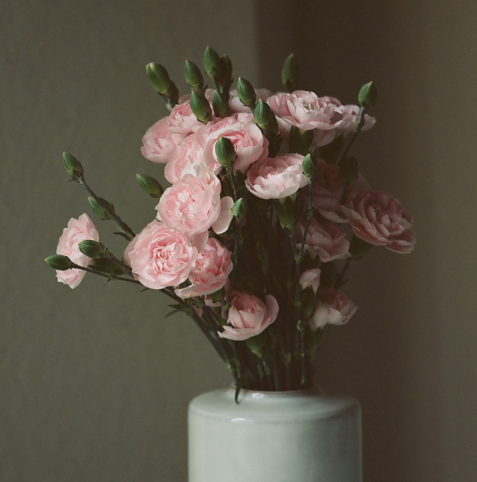

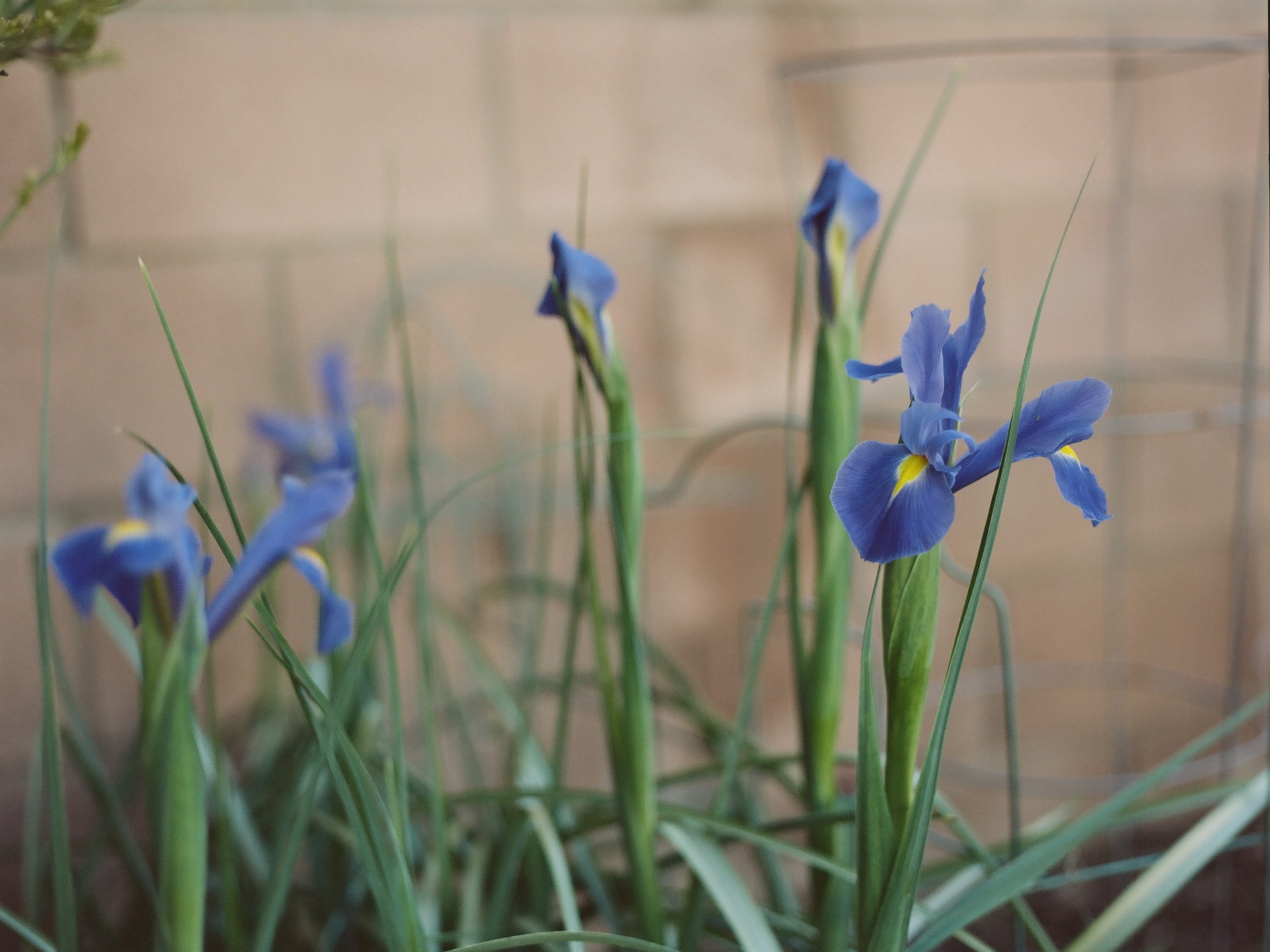

.... and since you asked... Here are a couple of 35mm Porta 160 pictures of purple and pink bologics recently photographed with a Retina IIIC that just arrived from the lab. The bluish-purple iris (I think it's an iris) are very, very close to what it looked to my eye wit the only differnce that I can discern being the softer color palette of Portra 160; the pink carnations are spot on. I wish I had a magenta biologic to photograph but no such luck. Please note, that I'm showing the "most true to reality" of several images; there were differences and the color was muted in some of them. The degree of color variation seems to depend on the lighting angle, even though in some of these Portra scans the lighting differences were quite subtle.
