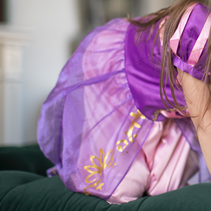

My situation is that I noticed that one very specific color never shows up properly on my Portra 400 scans. It gets cooler and desaturated. The color is somewhere between pink and purple, maybe someone would be able to nail the name, it's basically the darker color of this girl's dress:
It shows up fairly life-like on iPhone photos or photos taken with my Canon digital camera, as shown above.
But the same dress never looks like this on Portra 400 scans. Here is what I get:
Sometimes, when the color gets closer to purple, it gets completely desaturated. This picture is particularly telling:
Usually these look like this:
I have numerous other examples, with different light and different subjects. But it's always the pink/purple combo and always Portra. Could be a coincidence, I should probably shoot that dress on 5 different emulsions to make sure.

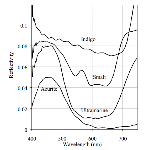

Firstly, there's the question of the nature of the hue itself. You mention a hue as if it's only one, but I can firmly guarantee that the dress and the wisteria flowers are fundamentally different hues. Each colorant (let's say a dye) has its own, specific wavelength absorption spectrum, which is the description of which wavelengths of light it will absorb and which ones it will reflect (resulting in some kind of color). Even if you take two dyes that visibly seem to match in color, their actual absorption spectra can be very different. Here's an illustration:
From here, page 18: https://www.sto.nato.int/publications/STO Meeting Proceedings/STO-MP-SET-277/MP-SET-277-12.pdf
These are the spectra of four blue pigments commonly used in paintings (especially older paintings). Yes, the hues are different, but the spectra are actually quite wildly different. Note how the Azurite is a pretty pure blue that reflects anything in the blue spectrum and blocks everything else. Compare this to Smalt, which actually is a blue and red pigment with significant reflectivity in the deep red and infrared region of the spectrum. Indigo does a similar 'trick' and probably reflects a lot of UV as well. All of these spectra are actually quite decent in the sense that they're fairly gradual. Some dye spectra are much more erratic; see for instance the caretoneid spectrum on this page: https://www.savemyexams.co.uk/a-lev...ss/13-1-5-absorption-spectra--action-spectra/
You may be able to imagine that such differences in reflectance/absorbance have very profound effect if you start overlying them on top of the spectra of (1) different light sources, (2) light-sensitive silver halide emulsions, (3) digital CCD sites and (4) rods and cones in the human eye. Essentially, these complex interactions probably explain most or all of the hue shift that you're witnessing. Let's have a look at some of those emissions and sensitivity spectra:

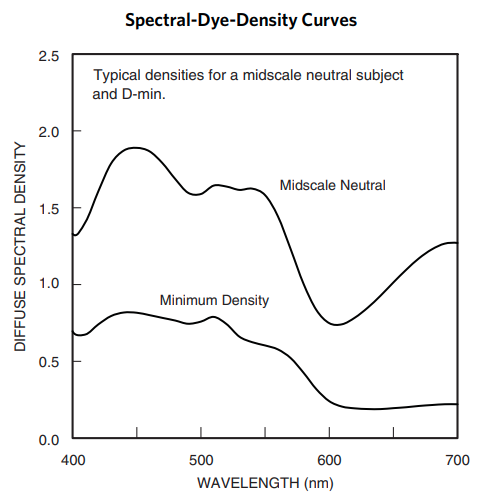

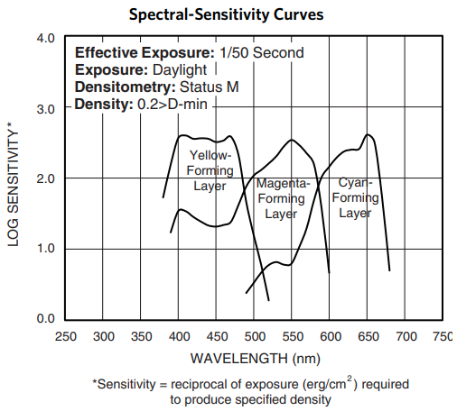

This is then what your film (Portra 400) sees:
From its datasheet: https://imaging.kodakalaris.com/sites/default/files/files/resources/e4050_portra_400.pdf
Notice that your suspicion that the film may be blind (my reformulation of your words) to this particular hue is likely not the problem. However, it may record the hue in a way that causes problems/shifts later on in processing. For instance, it certainly is a little more sensitive to certain hues and a little less to others, and especially if the absorption spectrum of the violet colorant (in the dress, in the flower) is pretty lumpy, you could run into odd amplifications of certain hues while others go surprisingly dim. So yes, the film may play a role, but my guess is that this is probably only one of the minor effects.
Of course, the above is the sensitivity of the film (i.e. its silver halides), but its actual hue reproduction (the dyes forming the image) is yet another one:
(From the Portra 400 datasheet again).
Don't try to match the wavelengths above to real colors in your scene - we're looking here at a dye reproduction, including color correction mask, of a color negative film. At this stage, any firm relationship with reality is basically lost. The only way we can recover something resembling accurate color reproduction is through calibration - and accepting that indeed, our recording gamut is always limited compared to reality.

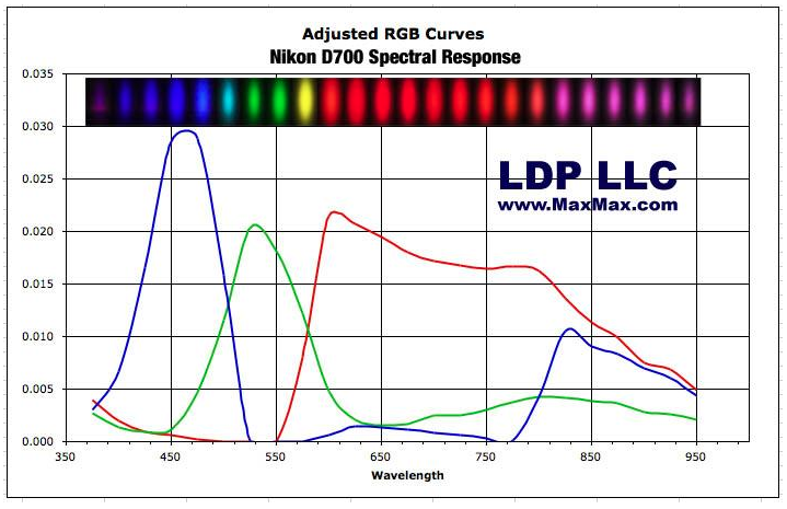

In a digital camera, which you're using, funny things also happen; here's the spectral sensitivity of a random CCD (of a Nikon D700 as it happens):
As you can see, there's ample crosstalk between color channels (although this sensor seems to perform pretty decently by all accounts) and there are also distinct non-linearities that need to be somehow 'fixed in post' if we want real-world accuracy. Much of this already happens within the camera itself and/or in any software RAW processor.
Note that you actually have to look at the interactions between the camera CCD, the illuminant used to backlight your film, and the dye absorption spectra of the film. And this in relation to how the dye image actually correlated with real-world colorants under the illuminant at recording time - you still with me?

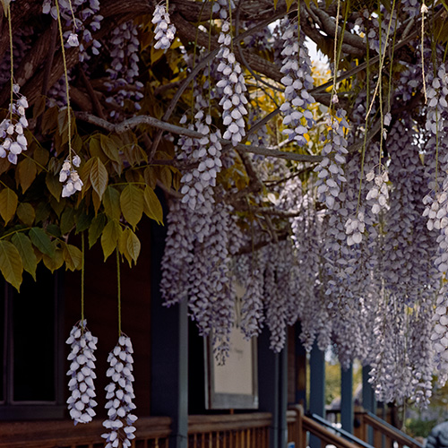

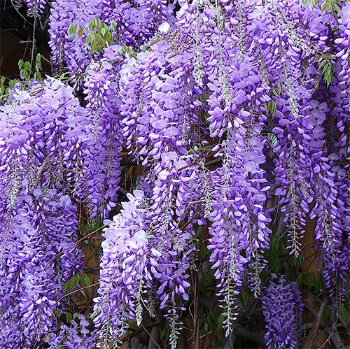

This has been known for many, many years in UK when taking pictures of flowers called Bluebells in UK. It is the difference between the eye's perception of the colour and what the film sees: be it colour negative or slide it makes no difference.. Bluebells like shady ground to grow in which appears to make it worse.
There does not seem to be anyway of reducing or eliminating it unless you are a very skilful manual printer who is prepared to change the colour balance over a specific area by dodging or burning with different filter values and careful handling of changes in exposure.
With the advent of digital imaging, the effect is not so prominent - but still there. This can be eliminated entirely by careful use of the tools to change colour tones in small areas that photoshop provide.
