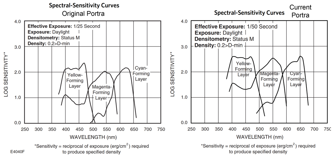

A very long time ago I read about a strange effect that makes some plants impossible to photograph properly. If I could just remember the name...
But in a nutshell, colors on film or a sensor doesn't work like it does for the eye and these colors fall to that in between spot. I know that it almost always happens with purples. There's a type of clematis and also the British bluebells that produce this effect.
The human eye is mostly sensitive to green tones (the bane of graphic designers), much less to the blues; so that says a lot about color rendition. 'Cause lets face it, when we take a picture we're always looking at the 3rd generation of the original.

laser's reference to "dissimilar components" is a reference to the fact that the optically printed, matched papers of the time are no longer employed or even available.
With the current disparate approaches to end product, it probably isn't possible to identify one best film for all purposes.
We're really talking about color neg films which cannot be readily examined right atop a light box after processing like chrome film can be, but which must jump through intervening hoops to analyze - whether a proof print, or a scanned viewing option.
And the notion that Portra will yield the "best reproduction of difficult colors" is vacuous - which Portra, which difficult colors, what do you mean by "best", and what on earth do you possess as real evidence behind that statement? Yes, the Portra lineup has solved some of the color repro problems characteristic of earlier color neg films, but has inherited others, deliberately. It's just another stage in the evolution of the same things. And only Ektar realistically fills in the gap between that and what chrome films do way better. There simply is no silver bullet.
If you need to reproduce very specific hues, test, test, test film, and then after going insane trying, and sitting on the porch of the insane asylum in your rocking chair, with a set of watercolor pigments for therapy, you'll finally realize you should have been doing it that way all along. In my case, I go insane either way, so it's easier to blame the camera and film than my own direct mess. But I'm obsessed with capturing and rendering certain complex hues in nature.

The issue that the OP raised is a bit simpler, I believe, than we are making it out to be. The principal reason for the inaccurate reproduction of blues and violets in particular is due to the spectral sensitivity of the film. Portra at initial introduction utilized a technology that was designed to improve color reproduction for difficult colors, e.g., fabrics and flowers, that traditionally suffered from metameric failure in order to benefit commercial fashion and product photographers. This technology was incorporated in the red-sensitive layers of Portra to more closely mimic human vision sensitivity than did most other films. Original Portra probably would have done a much better job of reproducing Steven Lee’s dress correctly. Apparently at some point during Portra product lifetime, this technology was abandoned in favor of more common red sensitivity whereby the newer version is more sensitive to longer wavelengths. This can be seen from published spectral sensitivity curves from different time periods.
As koraks pointed out, some bluish colors begin to reflect at longer wavelengths that our eyes can’t see, but the film does. Consequently, those colors will be captured by the film incorrectly and won’t be fixable.

Part of the problem with the discussion here is that, yes, you have representative spectrograms of the dye sensitivity of the film in question, but you DON'T have any representative spectrograms of the light reflecting off this or that flower or sample of fabric, since there can be a multitude of potential variations of those, which the human eye is capable of differentiating in a different manner than the given film itself, or even differently from pollinators like insects and their own kind of vision, which is really the priority with blossoms, and not our pictures.
