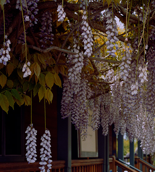

Part of the problem with the discussion here is that, yes, you have representative spectrograms of the dye sensitivity of the film in question, but you DON'T have any representative spectrograms of the light reflecting off this or that flower or sample of fabric, since there can be a multitude of potential variations of those, which the human eye is capable of differentiating in a different manner than the given film itself, or even differently from pollinators like insects and their own kind of vision, which is really the priority with blossoms, and not our pictures.

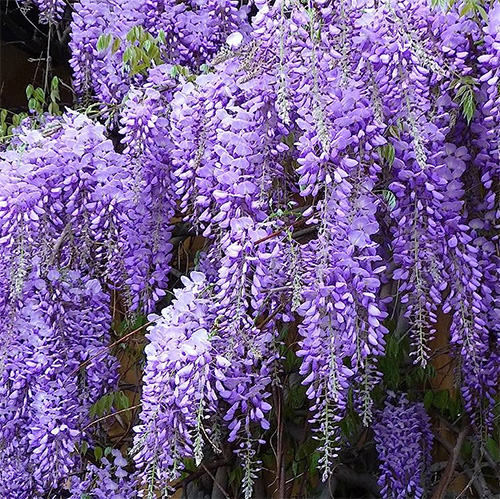

Spectrograms and insect vision aside, you would still expect purple flowers to look purple. Of course, no film is perfect.
Update. I just scanned the same negatives on Flextight X5.
The result is the same:
Conclusion: this had nothing to do with camera scanning. Portra 400 does not "see" this color the same way digital cameras (and human eye) do.
[EDIT] And here's the second image re-scanned on the X5:
Again: same colors (slightly warmer, but that can be adjusted to match the camera scan)
Unless you scanned them as a positive and did the inversion outside of Flexcolor, all you are testing is Flexcolor's sometimes odd understanding of colour neg.
I scanned them as positive and then inverted manually, i.e. exactly the same workflow as with a camera.

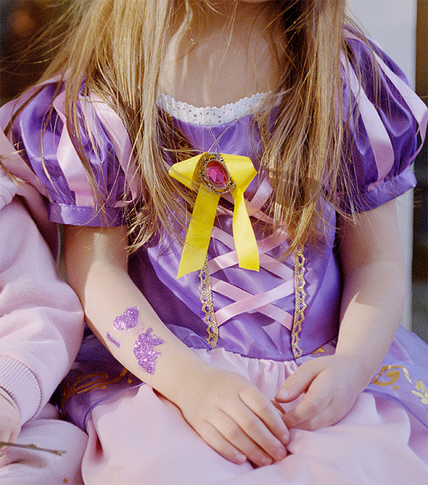

On my screen at least, and in comparison to most web images, the example you posted, Steven, looks overall too bluish-magenta, period. The whole color balance is off. Even the shaded skin areas are purple-inflected. Can't blame the film on that! Something is calibrated wrong in your workflow.
Doesn't really explain why the purple flowers aren't purple. But let's gloss over that in favor of criticizing Steven's white balance.
I see exactly what you're pointing at. For privacy reasons I do not want to post the full image.
It was exposed during golden hour, the girl is sitting in the shade. The skintone on her face is very different than her hands. That's because the skin on her hands is heavily tinted by the light reflected off that dress, and the hue of that light is also affected by this gamut limitation. The rest of the image, particularly well-lit areas, looks completely normal, on the warm side actually.
Sure, I could color-balance for the shadow in this case, but there is no way to make that dress color match what I see in the real life.

Yes I appreciate that Drew. I was simply trying to elicit from you whether you felt that Portra optically printed should be able to produce a much better representation of the dress and especially the hanging flowers.
Steven's scan of the girl does show her upper chest and from that picture the scan does seem to show normal skin colours.

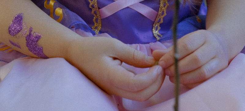

Forgot to mention: her hands are covered with purple-tinted face paint (pink+violet was the birthday party theme), here's a fragment from another shot where it's better visible:
I'd leave the overall color balancing to me, somoene who was there and knows how the scene looked. The issue isn't that. The issue is the single color which is off by a mile. That mile can't be covered by minor inversion alterations. I am still intrigued though... Will see if I can RA4 print this negative in my area...
All of the skin including the snippet of a hand on the left has some purple in it.
The white patch on the upper right does too.
Unless all the light was filtered purple that is where your problem is.

If you read the OP and look at the image of the flowers, which are supposed to be purple not light grey, the problem is with the film not correctly capturing purple, not with the lavender cast. If anything, correcting the lavender cast will make the problem worse not better. The lavender cast is a problem, not the problem.
My situation is that I noticed that one very specific color never shows up properly on my Portra 400 scans. It gets cooler and desaturated. The color is somewhere between pink and purple, maybe someone would be able to nail the name, it's basically the darker color of this girl's dress:
Judging by these digital images and your scans the span of hues that Portra is blind to is quite big. Since this discovery Kodak might as well label Portra as a C-41 BW film...
