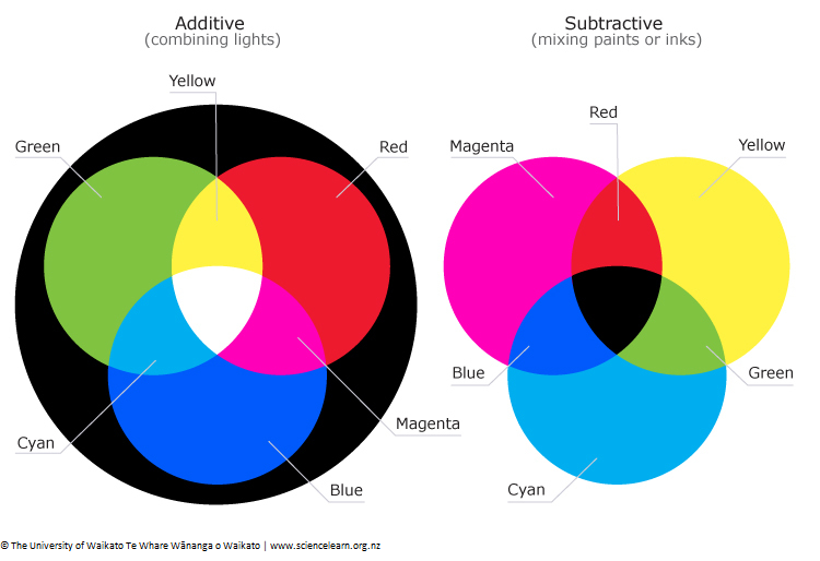

NAY - red, yellow, and blue are not primaries, even though we were taught that as children using finger paint, and sometimes eating it too. The Primaries are Red, GREEN, and blue. Yellow is a secondary, along with magenta and cyan.
But you probably just made a typo.
Red, Green and Blue are used in our retinas and television screens but Red, Yellow and Blue are the primary colors.
Oh boy.
Red, Yellow and Blue are considered the primaries in general manner of speak, but ask a printer and they'll argue that cyan, magenta and yellow are the primaries (or, conversely, red, green and blue). So it depends on the context. Normally speaking, it's R/Y/B. If you go out and buy paints, you'll find that there's a lot more ways the term 'primary' is used; for instance, the Winsor & Newton have two sets of primaries (across two different brands, so 4 'primary' color sets in total). One of those sets is a three-color primary system using yellow, blue and red/magenta (the horror!), while their 6-color primary system consists of two shades of yellow (a greenish and an orangish one), two blue shades (again on both sides of the spectrum) and two reds. Note how they both boil down to a R/Y/B basis, but one of the systems having no less than six primary colors. What now?
Sort of. The peak sensitivities of our retinas are more like blue, green and yellow. The sensitivity of our M and L cones overlap mostly and are spaced only a small distance apart. We don't have any receptors for red, although our L-cones do have some tailing sensitivity in that area. The G and B in modern TV and computer monitors overlap fairly well with our S and M cones, but not with our L cones since the R in an LCD or OLED system will be >600nm.
It's all context-dependent as hinted at above and you could unfold it further if you want. When speaking of primary colors, it's sensible to just indicate which ones you mean with the level of exactness required by the application.

The additive colours are referred to when talking about the transmission of light. For example colour photographic printing, television.
